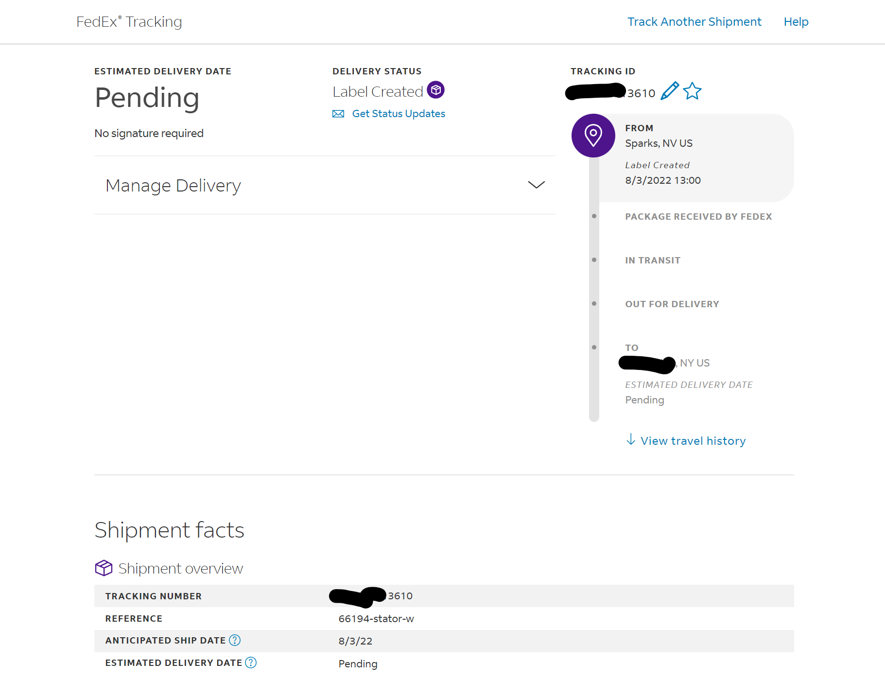

@krdugger
Please contact me regarding the replacement stator I purchased. It has been 10 days since your support claims that the stator has been shipped and still the tracking number has not been updated. Your support is telling me this is a normal delay in tracking numbers being updated. Any reasonable person with experience in online shopping can tell you that this is not normal. There is obviously something wrong.
Thanks,
Cardiobiker
