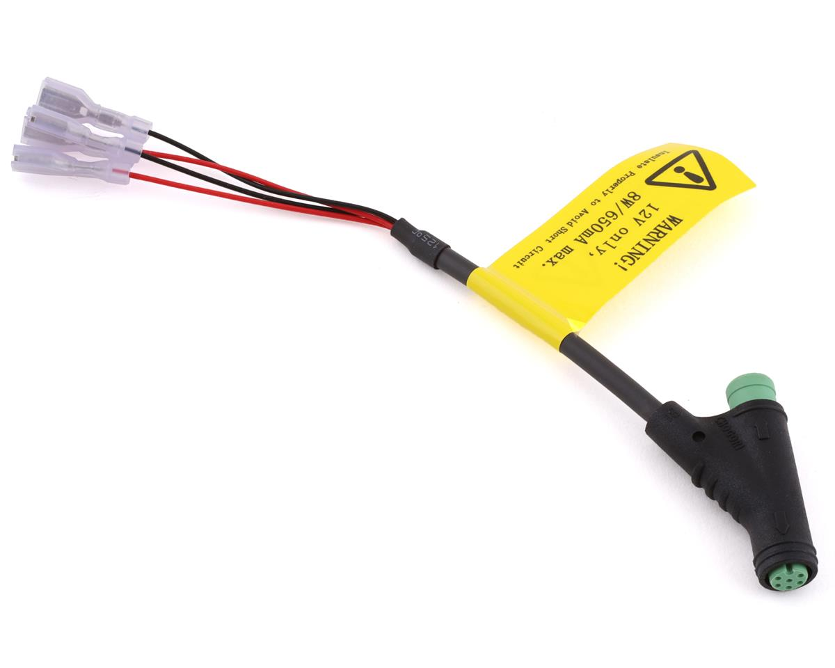

I'm trying to figure out if this would work on a Como 4.0 and am pretty unfamiliar with ebike connections/wiring. Based on the conversation here so far, it seems like the unit should work powered by whatever the light port is on the motor. Not sure if anyone knows the answers to these questions, but:
I'm not sure what the image represents. The split ends don't look like they're the right shape to connect to the Garmin? But hard to tell.
The key would be it getting 12V out of the bike via the Y. Then modify one of the other Garmin cables to plug into the leads.
Or some enterprising soul will identify the connector Garmin uses and make an adapter cable to sell.
