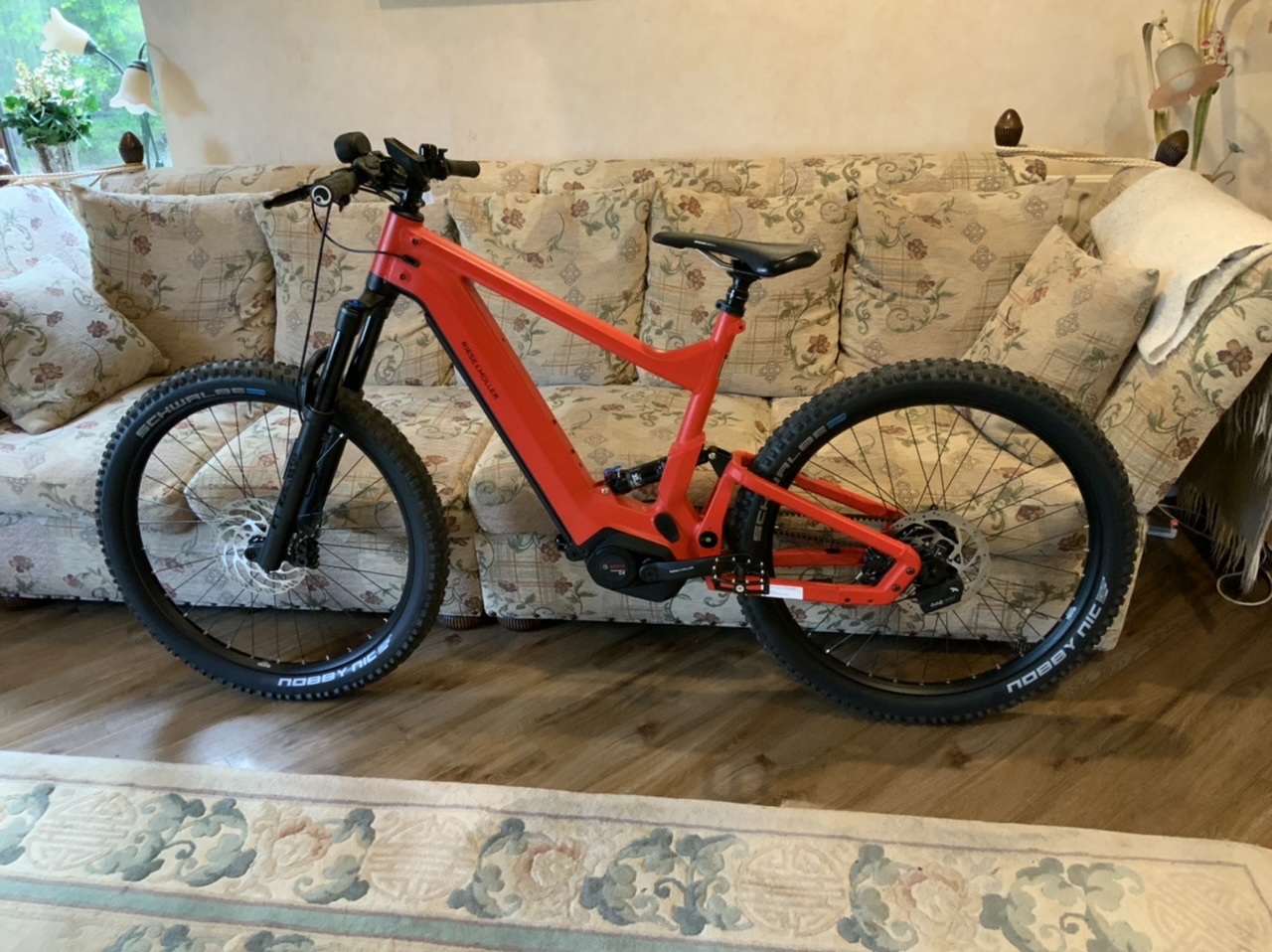

ok, here ya go.. I must stress that it doesn’t live inside, I just brought it in to keep it warm!
I’m a big softie - my SD Mountain lives inside when it’s not begging me to take it out for a ride!
