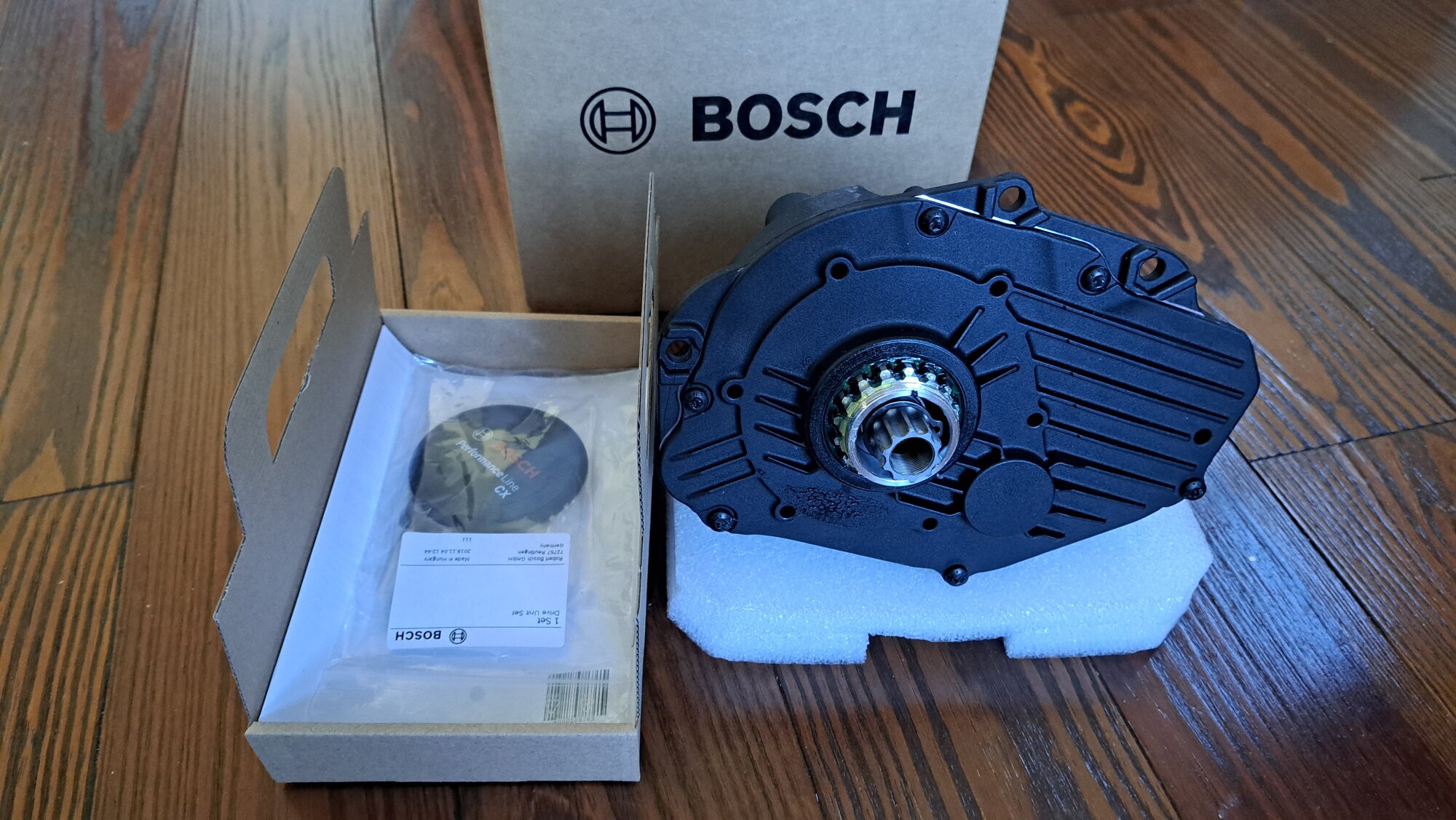

New Bosch Performance Line CX Gen2 (BDU 280P CX) 75Nm
wildtrak
Morgan Hill
I have some new Bosch Performance Line CX motors, zero miles.
These are the latest ones for the small sprocket, MY20.
Great as upgrade or replacement for any Performance Line or Active Line (2014-2018) that come with the small sprocket.
They have all the features like
  • Walk assist
  • eMTB mode possible
  • Dual Battery possible
  • 6V or 12V light output
  • 75Nm torque
$450
For details regarding installation or configuration etc., just send me a PM
"These are the latest ones for the small sprocket" Those would not be the latest Bosch motors.
@rich c Just read it right.
The latest ones FOR the small sprocket.
There were several different versions for the small sprocket.
<MY17 without walk assist etc
and so on
That's why I added all the information like Gen2 and 2014 - 2018
That motor actually is a MY20 (still Gen2), which means it has all improved updates like the 12V etc.
