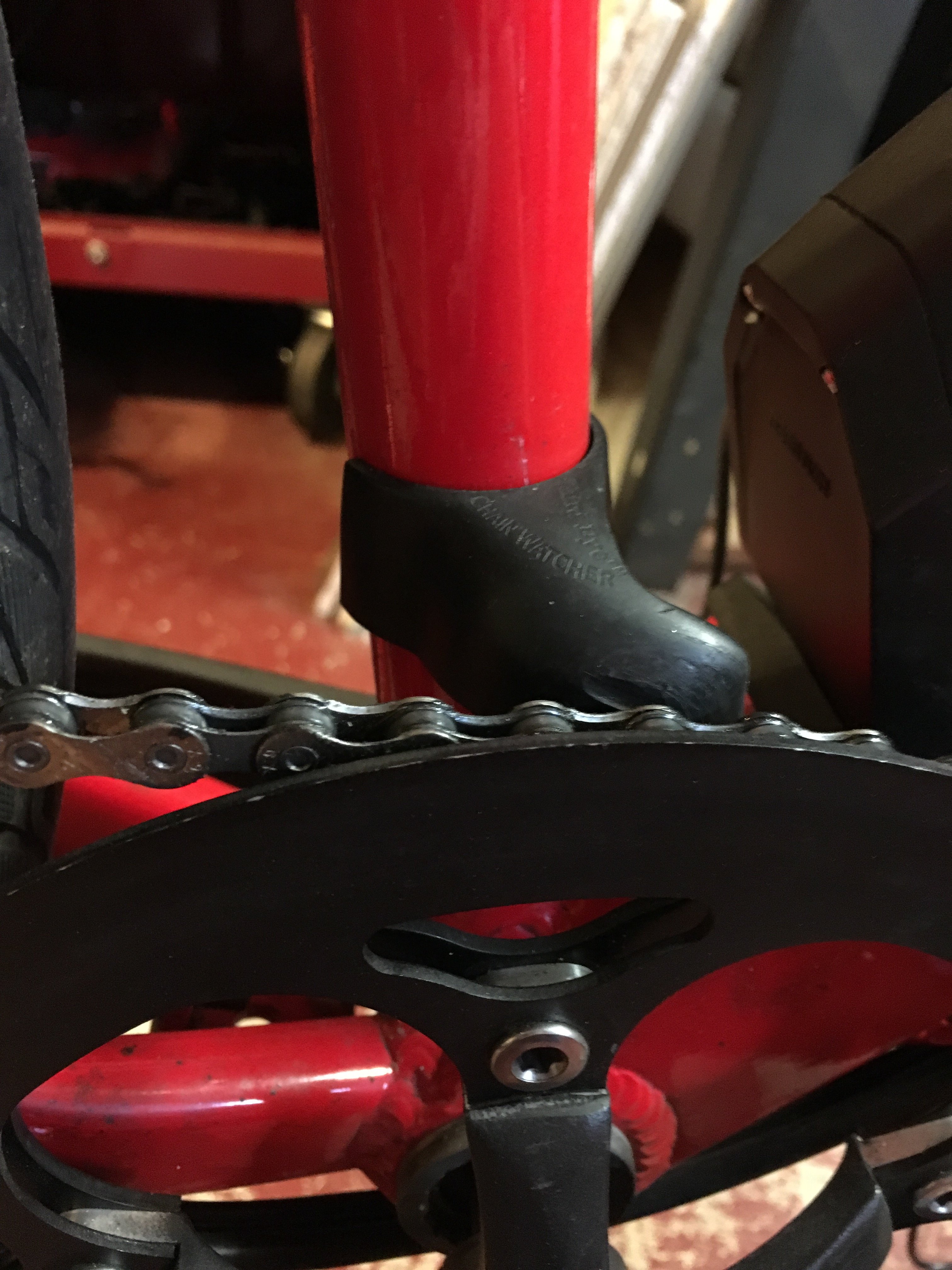

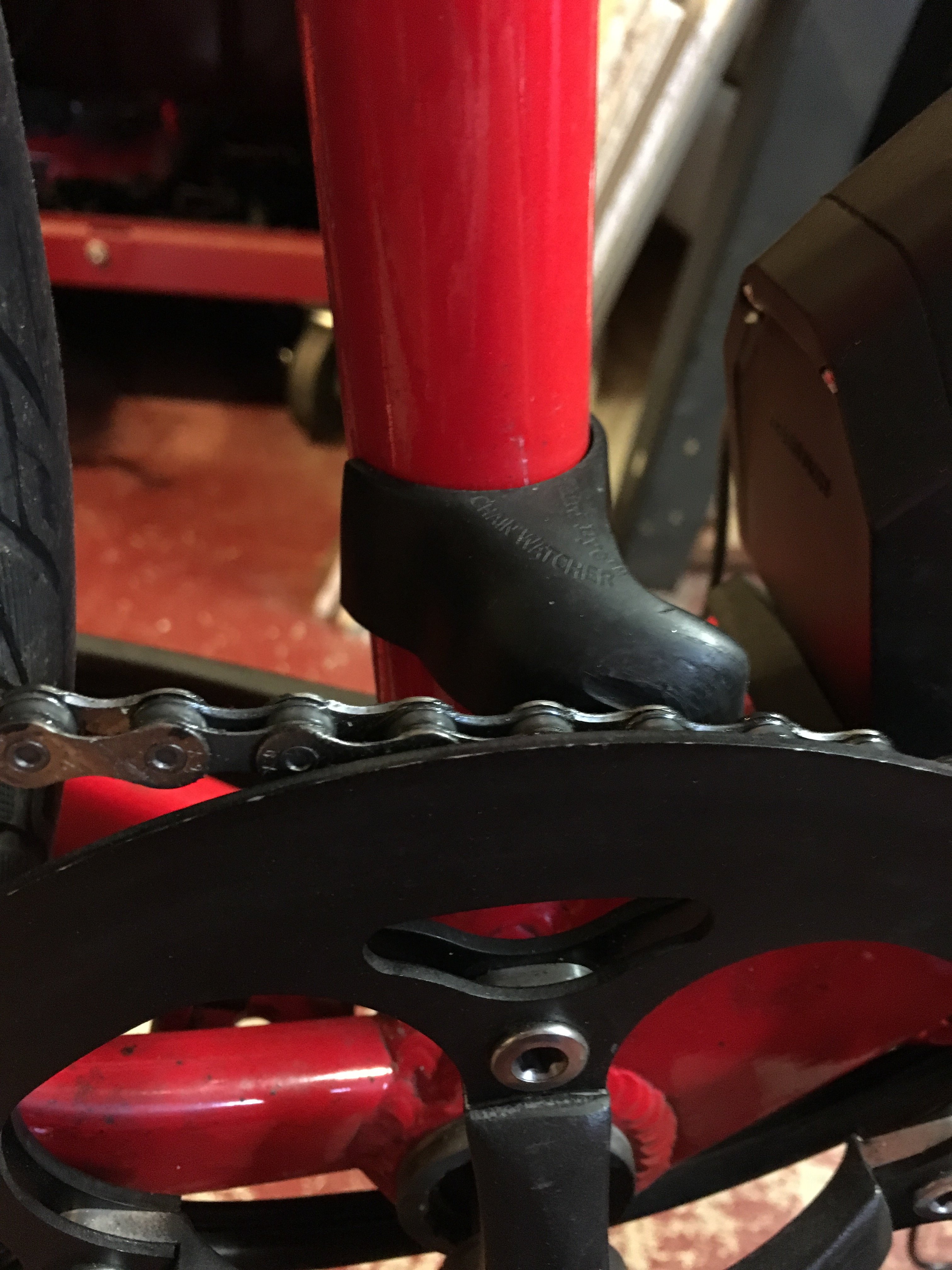

I am using the Third Eye chainwatch to prevent the chain from dropping inside the chainwheel. I have reshaped the bash guard to make it harder for the chain to drop on the outside. I also bought a better quality chain with just 116 links.
https://www.amazon.com/Third-Eye-Bicycle-Chainwatcher-Universal/dp/B000AO3HO2
Fildil, Thanks so much for the pic. I had seen that one, but didn't think it would work on a CCS. For $9 I will happily give this a try. Your picture makes this look like a simple effective solution.
