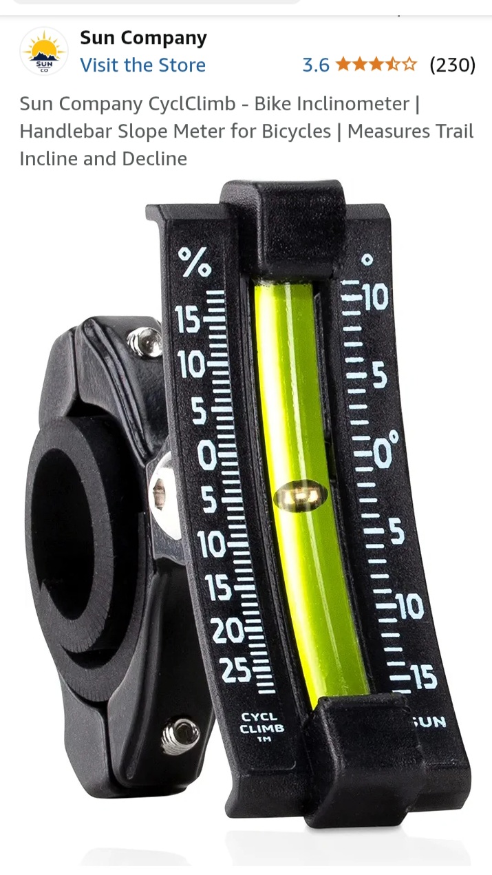

It is a dirt road leading up a mountain. I haven’t seen any tour de France riders on it. I used a level and a carpenters tool to measure the incline, might be off a few degrees but the hill is steep if you measure it by the number of young mountain bike riders in their granny gear or walking and the number of cars and trucks unable to get up the hill after a snow storm. If you know of an easy way to measure the angle, pitch or incline, let me know and I will try that.
This might help,..
You might have to install it upside down to read the biggest hills in both directions? 😂
