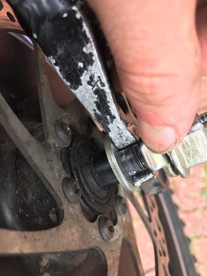

My rear hub motor is spinning my axle and making my rear wheel come off the bike , please help
B Billyrobbo New Member Jul 18, 2019 #1 My rear hub motor is spinning my axle and making my rear wheel come off the bike , please help Attachments A0114D09-FDB9-4E0F-BE7D-1AF038CF5C90.jpeg 100 KB · Views: 538 7B299BD0-A940-47F3-B761-F92273EB7064.jpeg 92 KB · Views: 538
J.R. Erstwhile Region USA Jul 18, 2019 #2 You need a torque arm... or two. http://www.ebikeschool.com/torque-arm-need-one/ Available from Grin. Or Amazon or Ebay.
