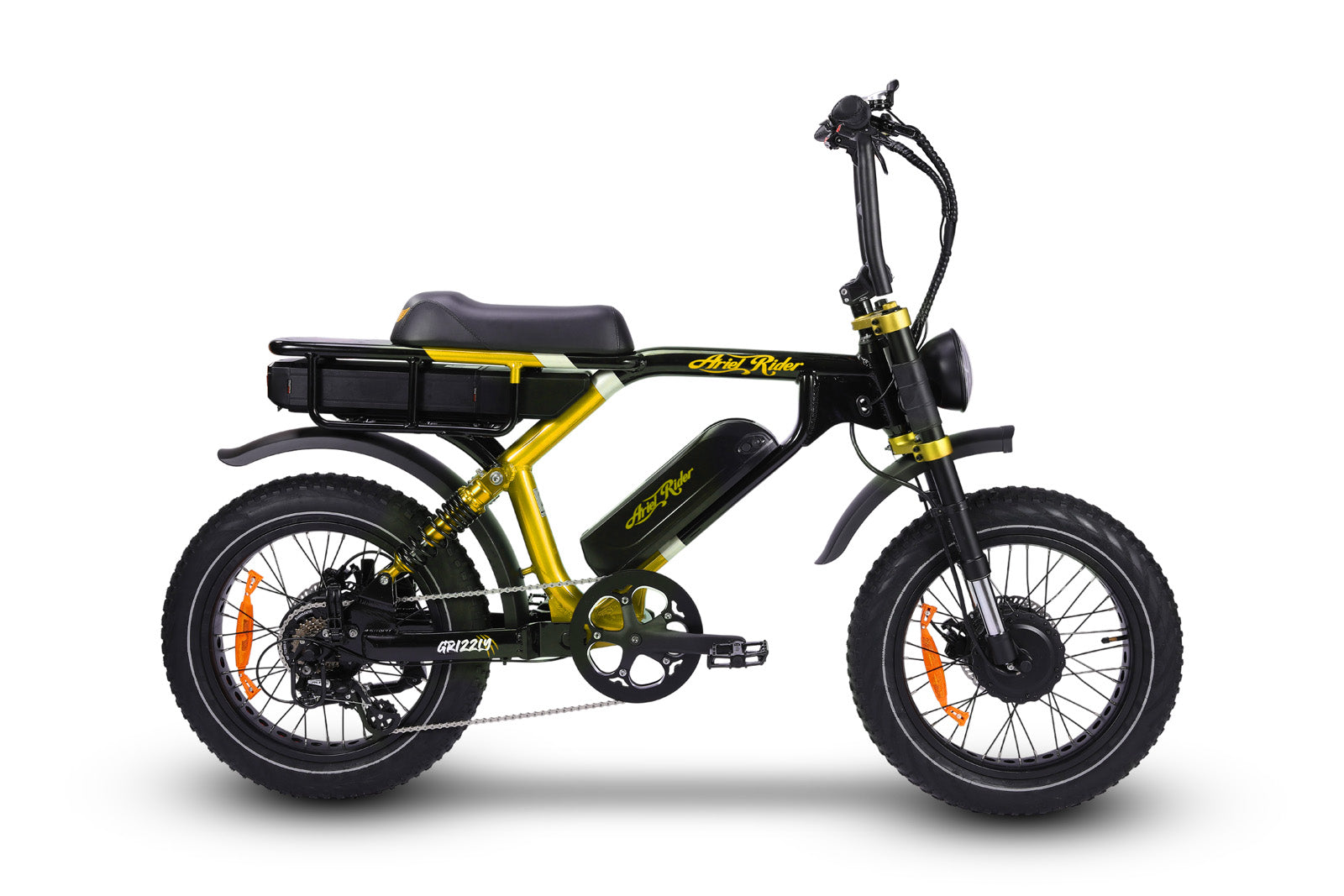

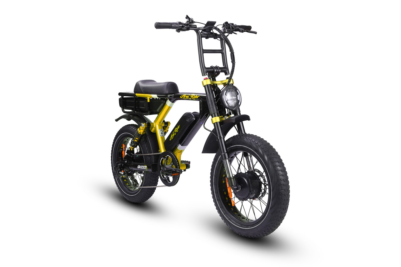

Thanks everyone for your replys. The Ariel Rider Grizzly seems to fit my needs the best. I can't seem to find a bike with better specs. Dual 750watt motors, Dual shocks, Dual 52v batteries that end up being 32ah. Does anyone know a bike with better specs then that?
