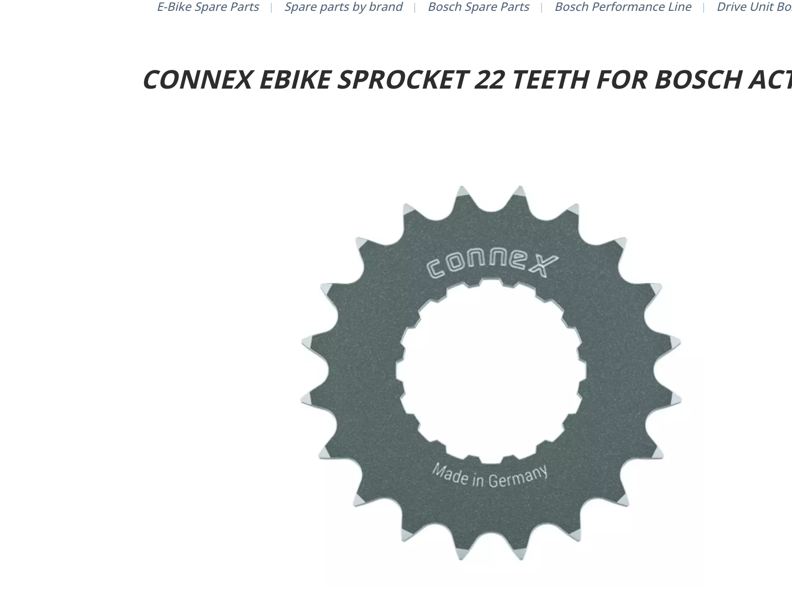

Hi! Sometimes I feel like there is not enough speed! Because the sprocket on the Performance Line CX (4gen) is not big enough. It looks like they only have 22 teeth. Do you have any ideas or ready to use items instead of 22 teeth?

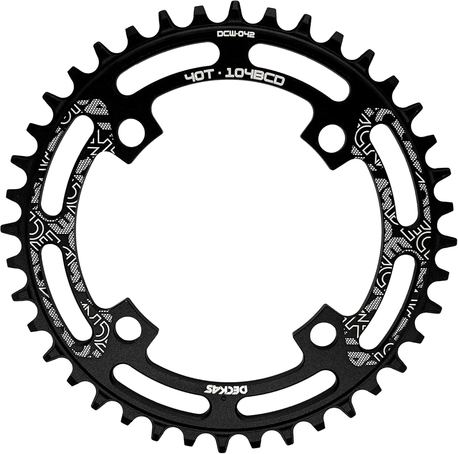

That looks like a gen2 chainring, not for a gen4 bike. That would be ridiculously small on a gen4 drive unit- you would have to pedal 120 rpm just to get to 31kph on a gen4 CX in the 11t cog on the back.
On a gen2, that same 120 rpm would get you to about 78kph and 90 rpm gets almost 59kph.
Maybe post a pic of the chainring on your bike so we can see what you have on it now.
Yes , you are right, my mistake! I need a large sprocket for Gen4 , my bad

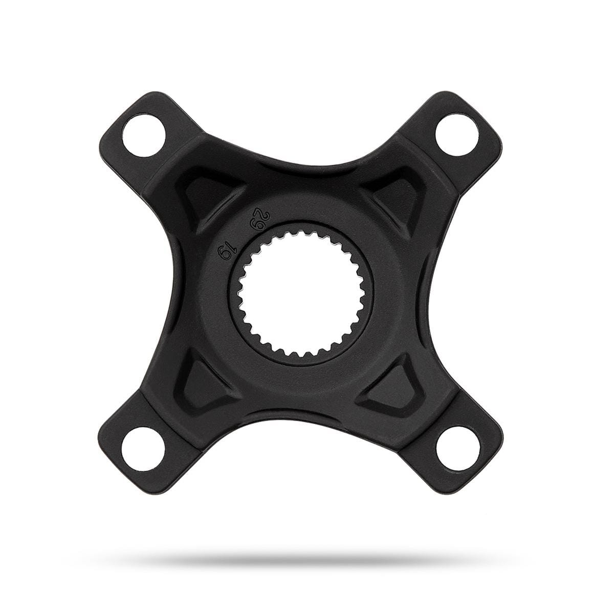

Do you have a direct mount chainring or one mounted to a spider? If you use a spider like below then you should be able put on pretty much any 104bcd chainring that fits.
I can't tell you how big a change you can make with a chipped drive unit without throwing an error though. I do know that the Bosch units tolerate small changes easily.
They go up to 52-t. You will have less problems with a larger chainring than a smaller cog. But it will tend to stress the motor bearings more, but only if you do not maintain a high cadence with low side-to-side pedal pressure.
Not sure what's available where you are but maybe FSA is easy to find. They have a 104bcd Megatooth chainring that goes up to 48t - that's what my PL Speed bike came with.
