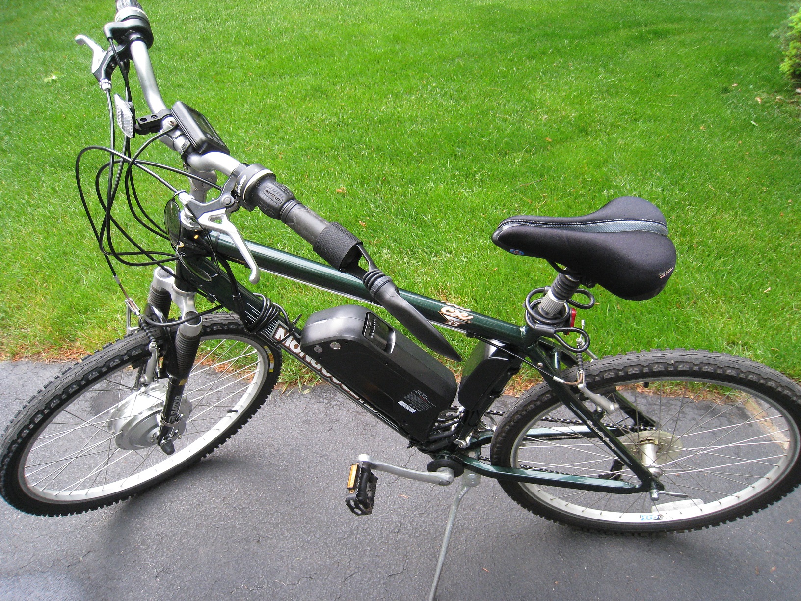

Although not a cargo bike, my Mongoose was an excellent conversion candidate. With the 500w motor it easily climbs steep hills and it is very light. I can still ride it without the battery, but choose not to although I sometimes turn off the assist. During winter, I don't ride below 50°, which is the norm.
Although not a cargo bike, my Mongoose was an excellent conversion candidate. With the 500w motor it easily climbs steep hills and it is very light. I can still ride it without the battery, but choose not to although I sometimes turn off the assist. During winter, I don't ride below 50°, which is rare.
Nice bike. Fifty used to be my cut-off as well. Then I discovered those disposable hand and feet warmers. I buy them by the box and tuck a pair into my gloves and shoes for rides below 50° F.
And if it's in the 30's, I'll pedal a mile or two unpowered to get warmed up before turning things on.
