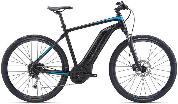

Check out the giant Explore E at Gericks Cycle in Nelson They also carry Kona ebikes. Both brands are mid drive and very good hill climbers.
