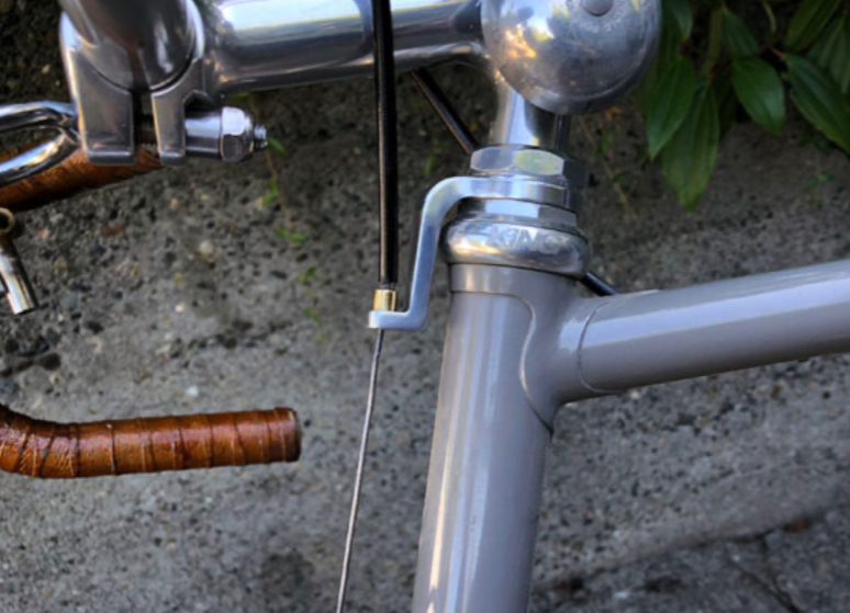

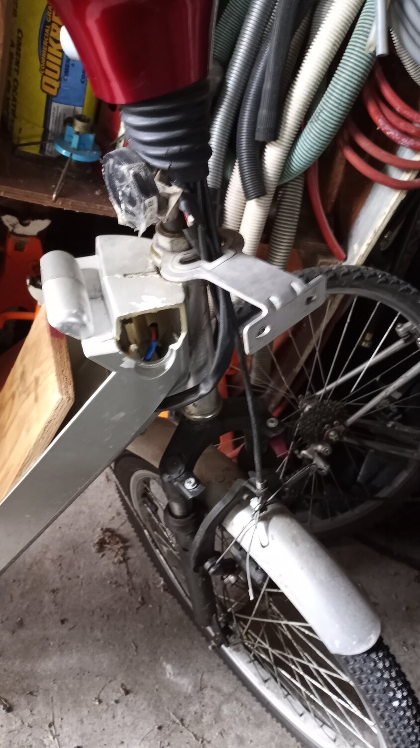

IIRC, that keyway is for a big washer with a tab on it that fits into the keyway.
The tab in the keyway keeps the washer (which may also include a bracket that holds the brake cable in front or reflector) from spinning when you tighten up the headset.
If the washer turns, it could spin the the nut below it and overtighten the headset bearing.
The two headset nuts lock together with the tabbed washer in between.

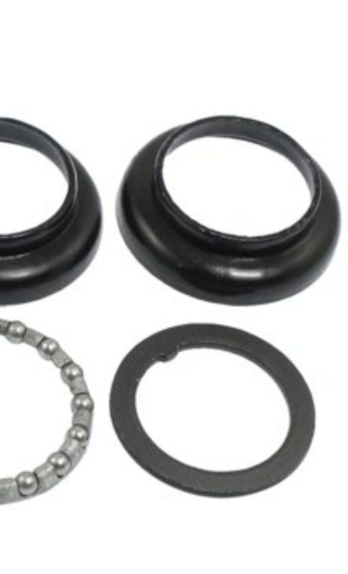

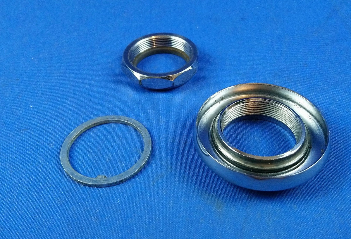

My bike does NOT have the keyed lock washer, I have just 2 nuts with a hard rubber "O" ring between the nuts that tighten/jamb together to set the head stem tension.

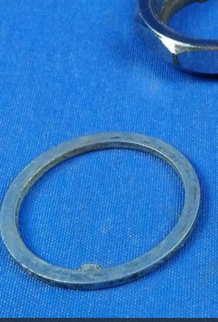

If you've pulled your headset apart and found nothing sliding into the slot in your head tube (nothing with a tab), then you'll be fine with a fork with a non slotted head tube.
,.. with a hard rubber "O" ring between the nuts that tighten/jamb together to set the head stem tension.
Check that "O" ring.
It might not be rubber and it may have a tab,..
