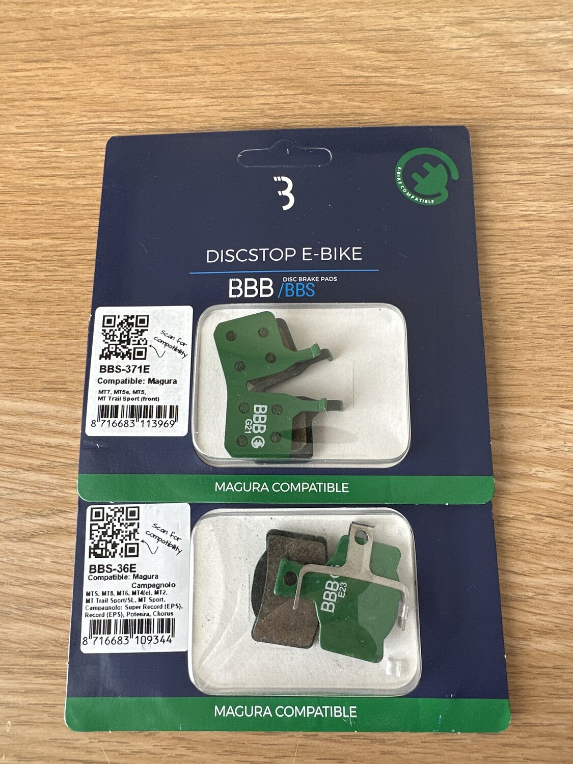

I have got a new set of front and back pads for today, if needed and went for a set of BBB DiscStop e-bike pads.
So see what happens.
