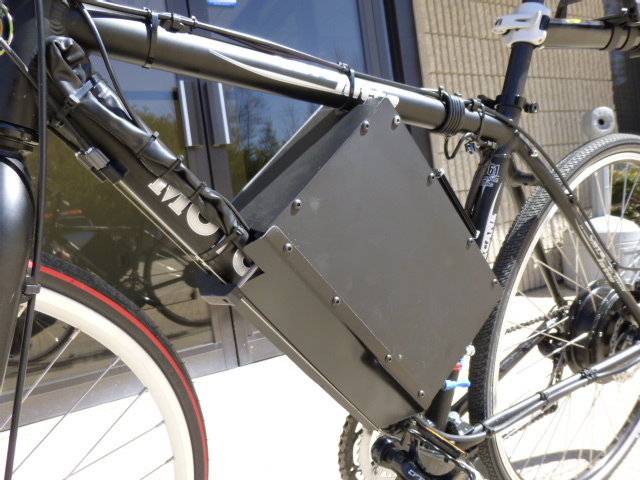

Pictures of the battery box construction in progress. Made same way as the other two constructions. There are a lot of additional wires in this conversion and I believe the only available space to use is above the top of the battery.
This will need some thought. One thing about a Bafang mid-drive conversion, the wiring is much simpler and less cluttered.
The Battery Box is almost complete. On to wiring. Unfortunately the Infineon controller and Grin CA3 come with excessively long wires. I'll be shortening the Infineon wiring harness to make securing the wires to the frame more manageable. This was not an issue with the Bafang mid-drive conversions, wiring was "plug and play" and much cleaner.
That is a big battery box. Completely professional. Since you did the Elite with the MD and this with the hub, maybe you can get a sense of the relative efficiencies of the two motors. That seems to be about the limit for battery power, but you want the speed and range. That chemistry is not lightweight, but it's a lot of power for the money.

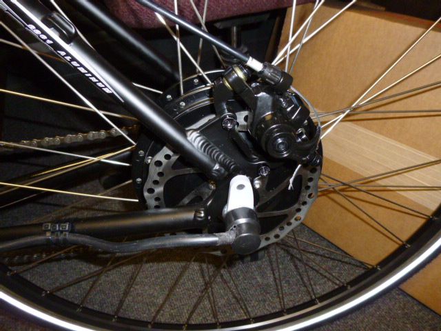

WOW...WOW...WOW. OK, now I know why the MAC 500W is a highly recommended motor. Easily (with emphasis) more torque then the Bafang 36V 500W, and I suspect that at 48V it would probably be as good or better then the 48V, 750W Bafang. The acceleration from a near stop to 26MPH is really unbelievable (scary unbelievable). Haven't taken the speed limit off 26MPH, but when I have the chance I'm gong to take it out on a flat without the upper limit and see how fast it will go, I'm pretty sure I won't want to ride it to it's limit.

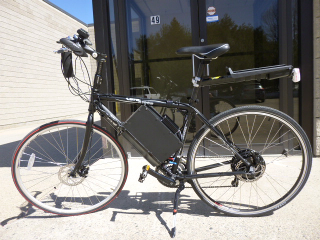

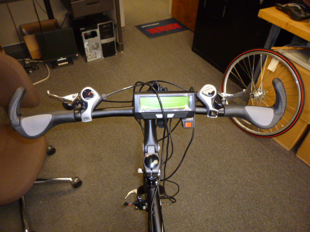

The MAC 500W, Motobecane conversion is done! I have tweaked the CA3 and put it in Power Limit mode with three distinct settings:
Level #1 limits the motor output to 250W
Level #2 limits the motor output to 350W
Level #3 limits the motor output to 500W
I adjusted the voltage gain feedback loop to provide a steady power increase curve to avoid power spiking. The result is smooth and powerful acceleration like nothing I have achieved on my other bikes. On the 3rd power level I can accelerate on the flat from standstill to 28MPH in about 8 seconds. The torque output from the MAC hub is nothing short of phenomenal. This is by far, a more powerful bike then the Carbon, or the Elite BBS02 36V 500W mid-drive. If I hadn't built the conversion I never would have believed the MAC motor was that much more powerful.....I am extremely pleased !!!!!!

Because I'm using the Cycle Analyst I can give you that info. Peak watts I've seen while riding is 540 and the peak amperage used is 18. The Cycle Analyst is a great unit, you can change quite a number of parameters to achieve the drive output profile that works best for you. I have "tweaked" the power curve to provide a fairly low starting power and adjusted the power gain per second so the motor doesn't draw peak power until the bike is moving at a reasonable rate. The motor should run cooler and the battery should last longer because I'm not trying to drive the motor at a high output when the bike is moving at a slow speed. The Cycle Analyst far exceeds the capability of the Neo Carbon control and the Bafang units.

I don't have a throttle on the bike, I start in the mid range of the cassette and the 48T chain ring. Pedaling hard with the switch set to level 3 the bike accelerates quickly to about 12MPH, shift to 11T on the cassette and by the time 6 seconds has elapsed the motor is running at 500W and accelerating extremely quickly. It took a while to set the gain rate to match my pedal cadence so the motor didn't peak at 500 Watts until the bike was nearing the top speed 28 MPH. Once the motor is putting out 500W pedaling it to the top is almost effortless. It doesn't bog down or hunt and overshoot the max setting which shuts the motor off until it drops back within limits. The smooth acceleration allows the motor to rapidly move to 500W without the issue of overshooting. The Cycle Analyst makes all the difference in motor performance. Now that I've used it in a conversion, I don't think I'd do another without it, or an equivalent or better controller.

Nice detail and report there Flymeaway. Several guys on ES forum rave about MAC motors.
Comments: spec and performance wise, you seem to have hit the nail on the head. I suspect you will eventually swap in some front forks. At higher speeds, you will want them, especially in NH back roads.
2nd, as good as you are with the battery box, it looks like a DIY mis-match with the rectangular box in a triangle frame, and wire ties/cables abounding. Part of the DIY life. After market kits like Bionx and Falco and much cleaner looking with internal controllers, but one looses the flexibility of the CA3. (except Falco does have remote motor control)
