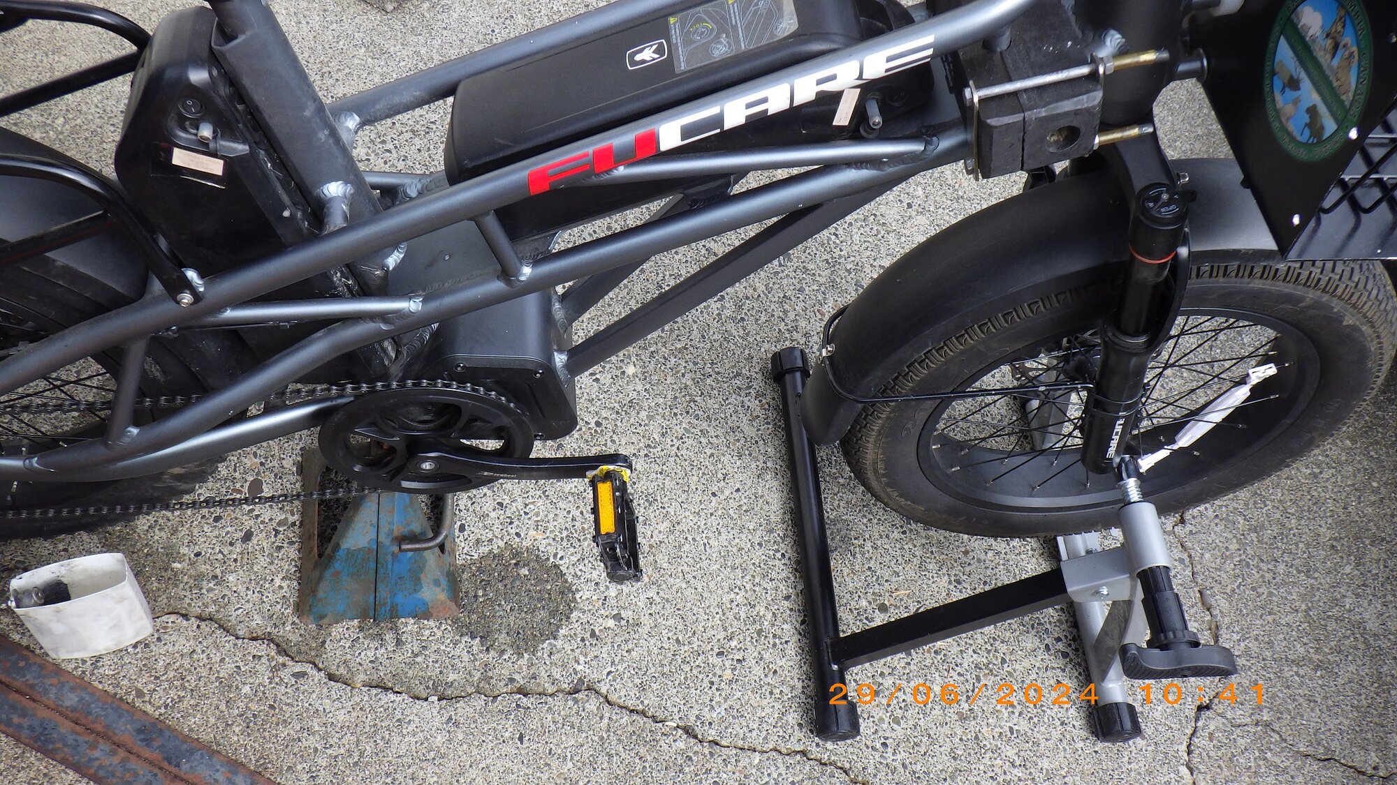

My Bike (Fucare Gemini X) weights almost 80 Pounds. I wanted a Bike stand which lifts up the Front wheel and the Rear Wheel. This solution which works well for me. Picture enclosed. The Stand is actually a repurposed Soozier Bike Trainer Stand found at a Garage sale for 10 Bucks. To lift up the rear I put a regular Car Jack under the what looks like a Middrive but is not. I also appreciate that the Bike Stand is totally stable and folds up for easy storage. Note also the little white plastic container with a Brush mounted inside. I fill it with a bit of Gasoline then shove it up over the Derailleur and hand-crank the Pedal, this cleanes the Chain nicely and quickly, after that is done reoiling the Chain takes about another minute, easy peasy.
