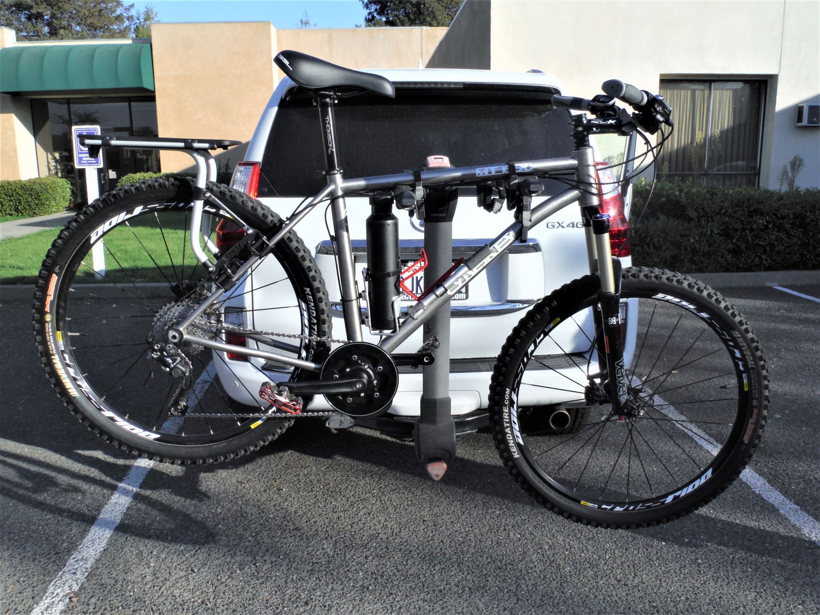

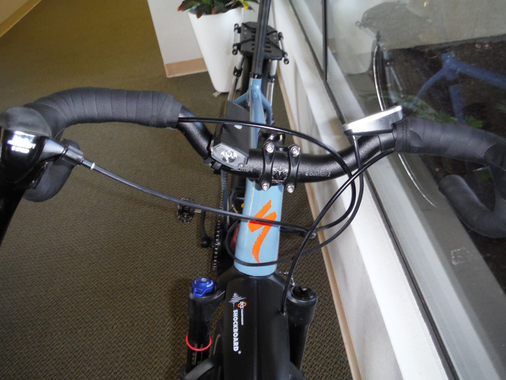

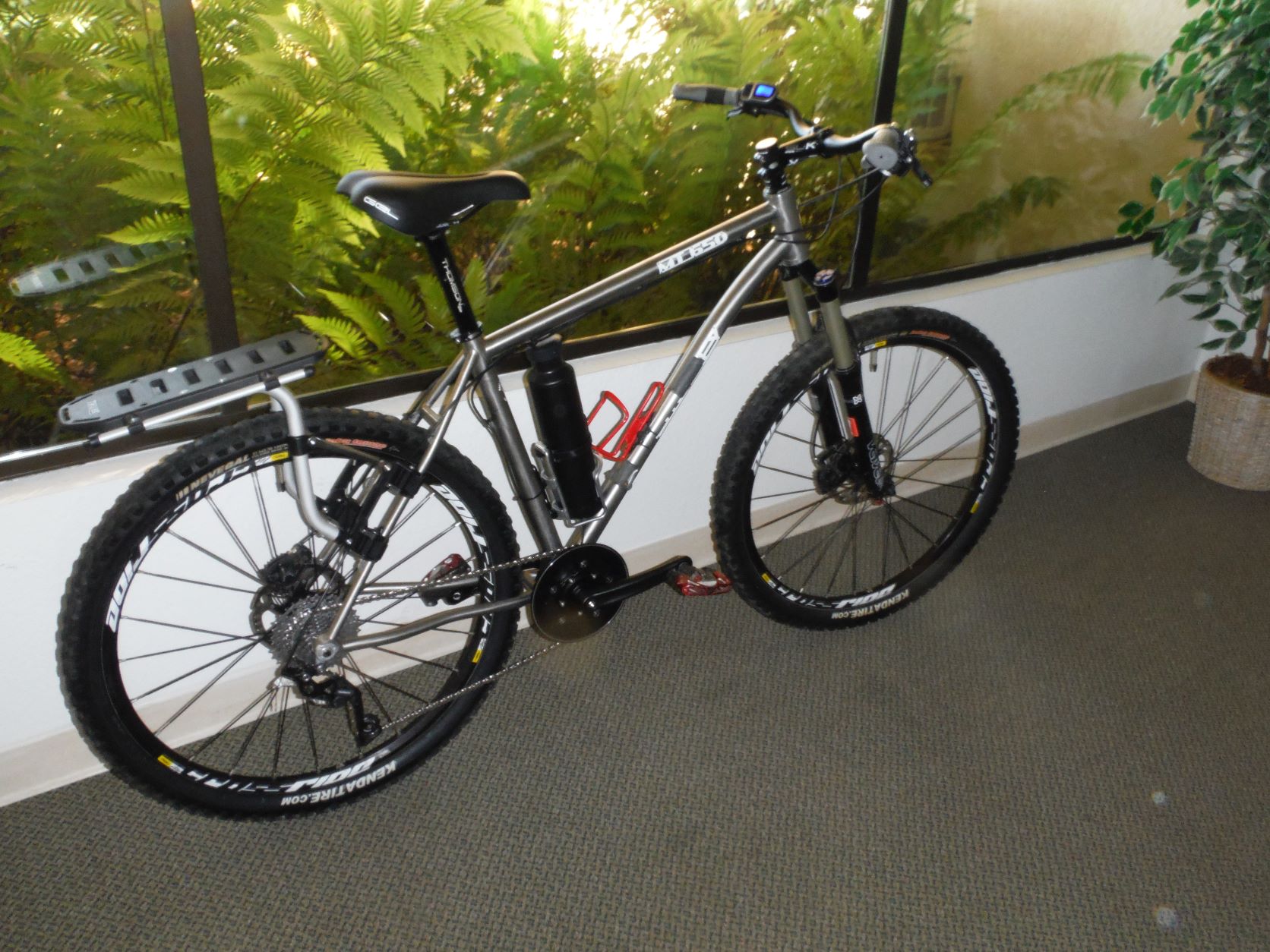

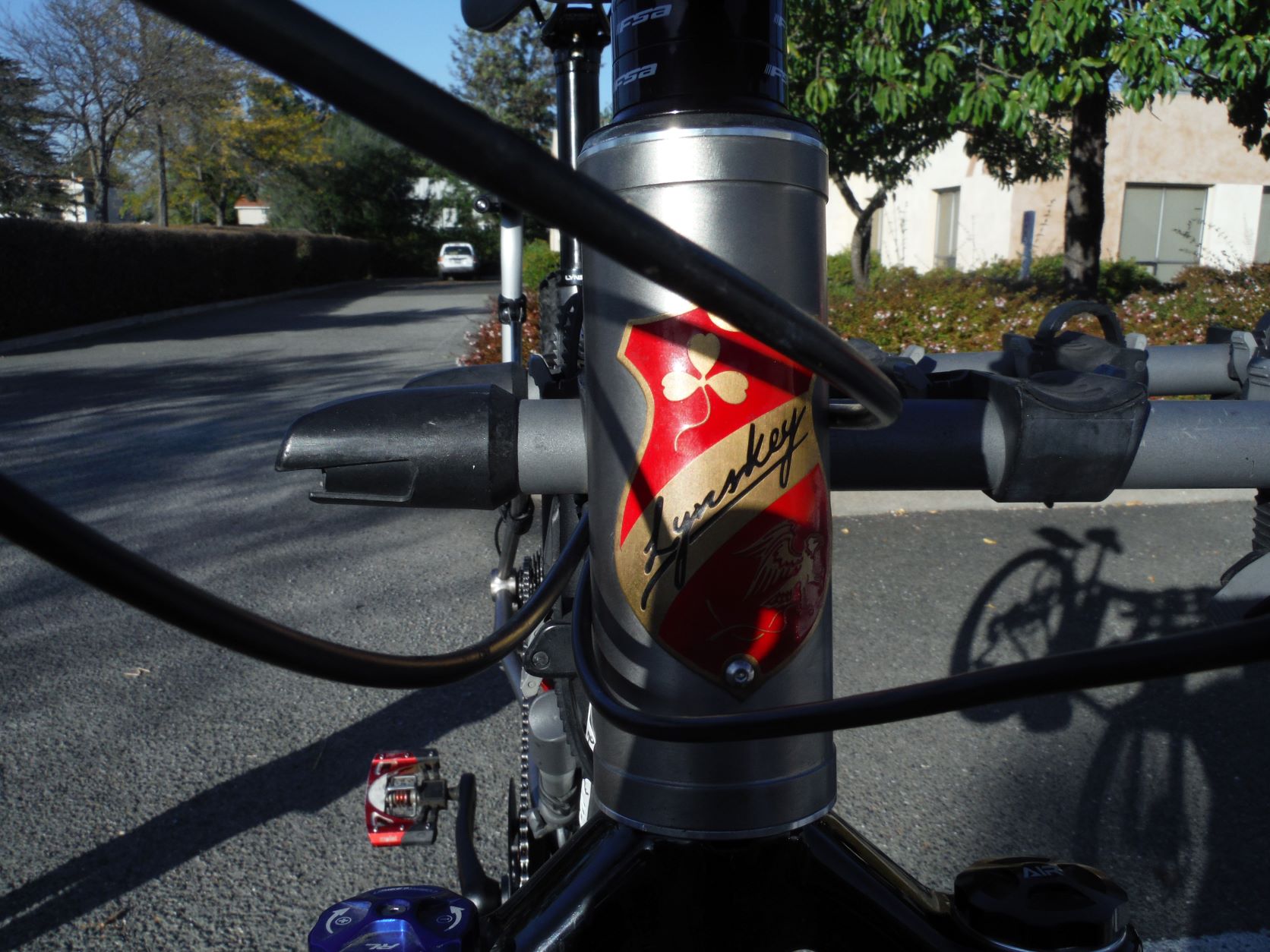

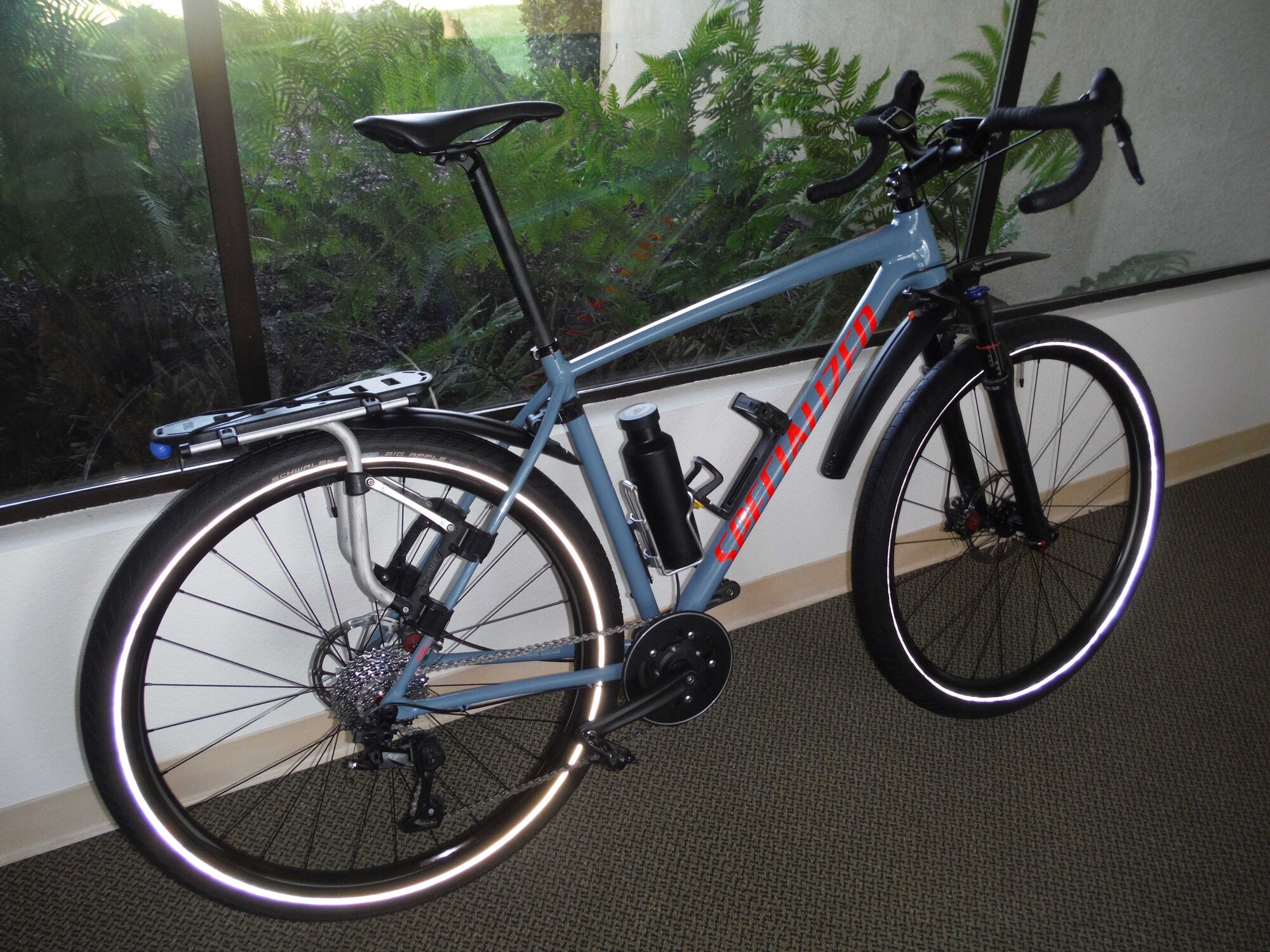

I've installed tsdz2 on 6 different bikes and have a pretty good handle on the pros and cons of this kit. I even converted one of my two tsdz2 to a coaster brake version (requires a new solid main gear as well as a new reduction gear to match). The problem with aftermarket mid drives like the tsdz2 is that there is a large main gear that sits in a housing out side of the chainring side bottom bracket by about 1.5cm. That might not seem like a lot but it messes up the chainline when using the largest/inboard cog on the rear cassette. It is partially corrected for by using the included 5mm inward dished chainring but on the bikes I have converted the chainline still isn't great on the largest cog of the cassette. I bought a 10mm offset chainring which is better but that only comes in 42t or 52t sizes. I also have a 5mm offset 34 chainring that mounts directly to the large main gear thus eliminating the spider. eco-ebikes used to sell a 26t version but it is no longer listed. For a mountain bike I'd like a 30t chainring and 11-50t cassette.
I would rather get an older higher quality bike on Craigslist and convert that than get a crappy bike from Bikes Direct. There are bikes with beautiful frames made out of chromoly or titanium. My friend John was given a high end mountain bike this week. It was ridden twice in 2003. When I saw the bike I had ordered from bikes direct I stripped it and gave away the frame. Here is my mountain bike. It is a Specialized Chisel. I changed up the bar and drivetrain. The big cog cannot be accessed because the chain stays are so wide, but I have never needed it and live in a place with big climbs. I have also included an older Ti bike.
