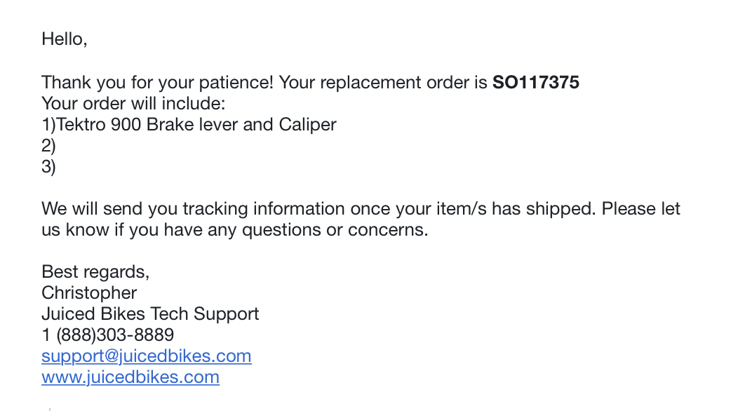

Thank you for your very detailed reply. I have watched multiple YouTube videos on the subject and have tried multiple bleed methods. The bike has 250 miles on it. I have ordered a different "cup" with stopper to see if that is the problem. There is no information, manuals etc on Logan brakes. It is my front brake that is the problem. When Juiced told me it was the Tektro 900 and I could not find anything about it, including the Tektro site, I lost all confidence in Juiced support. They say the "900" is coming in. I will keep trying the bleed and may try new pads, though the pads look fine. Looks like the Logan uses Shimano Deore pads.

Thanks for your help. I specifically asked Juiced for a manual for the brakes. No luck finding them anywhere. I am guessing I might be able to pull the motor cutoff sensor out of the Logan housing and put it into a new Tektro housing to avoid having to wire it. Something I will try before wiring. I have a few moves up my sleeve in trying to fix it anyway.
Well, they finally sent me new Tektro e350 brakes and they were wired correctly ( the motor cutoff switch) so it was very easy to take the Logans out and put new Tektros in. They work much better than the Logans.
