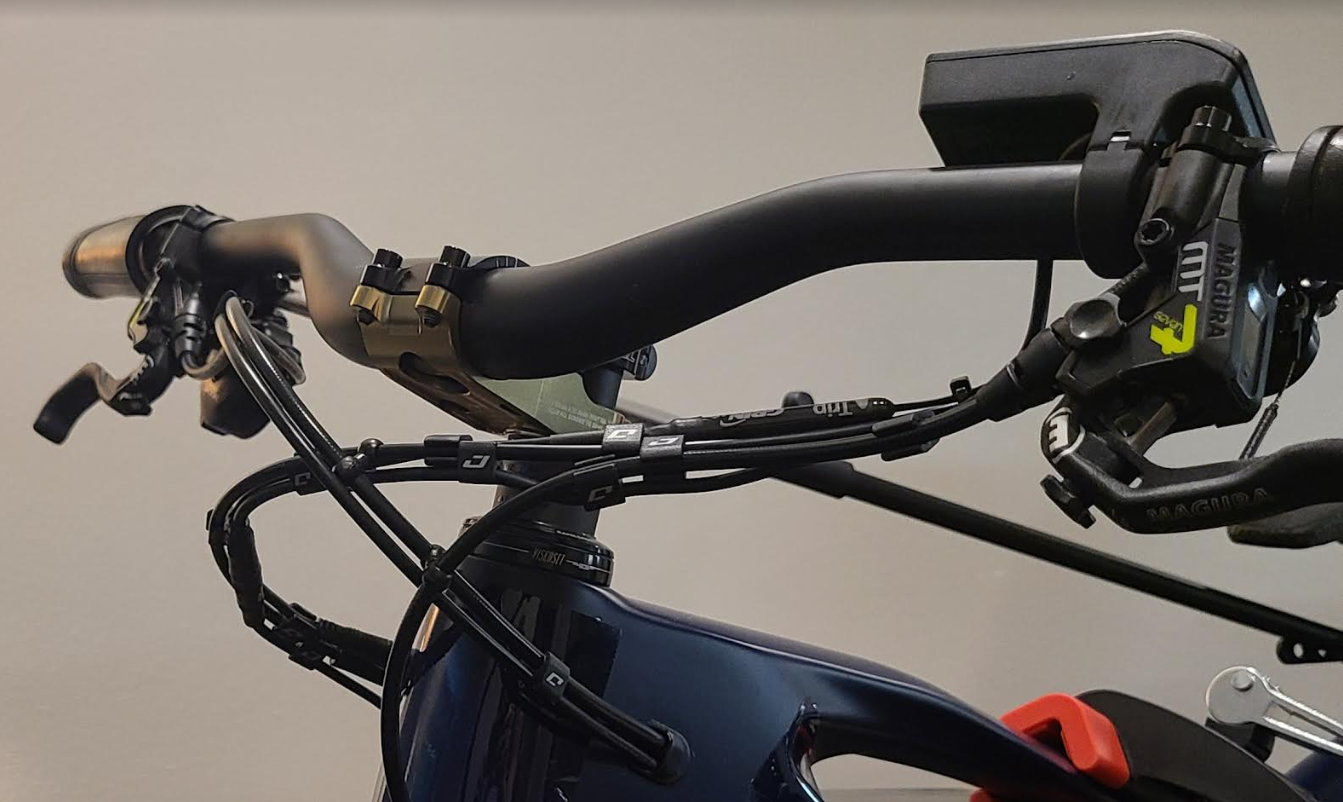

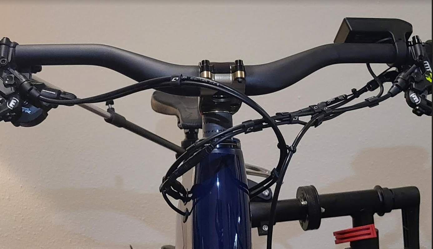

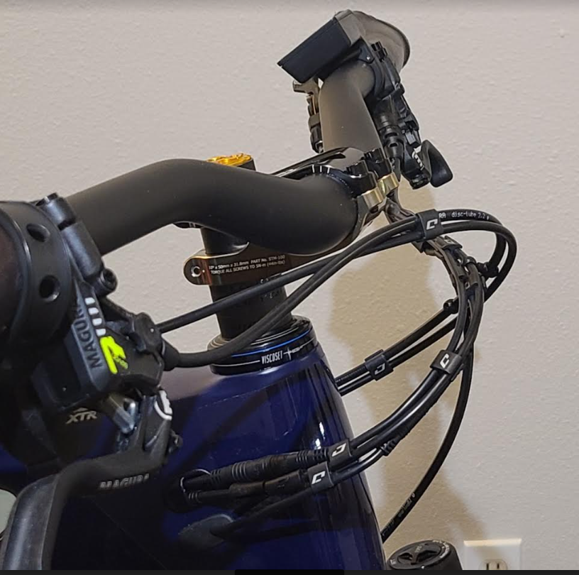

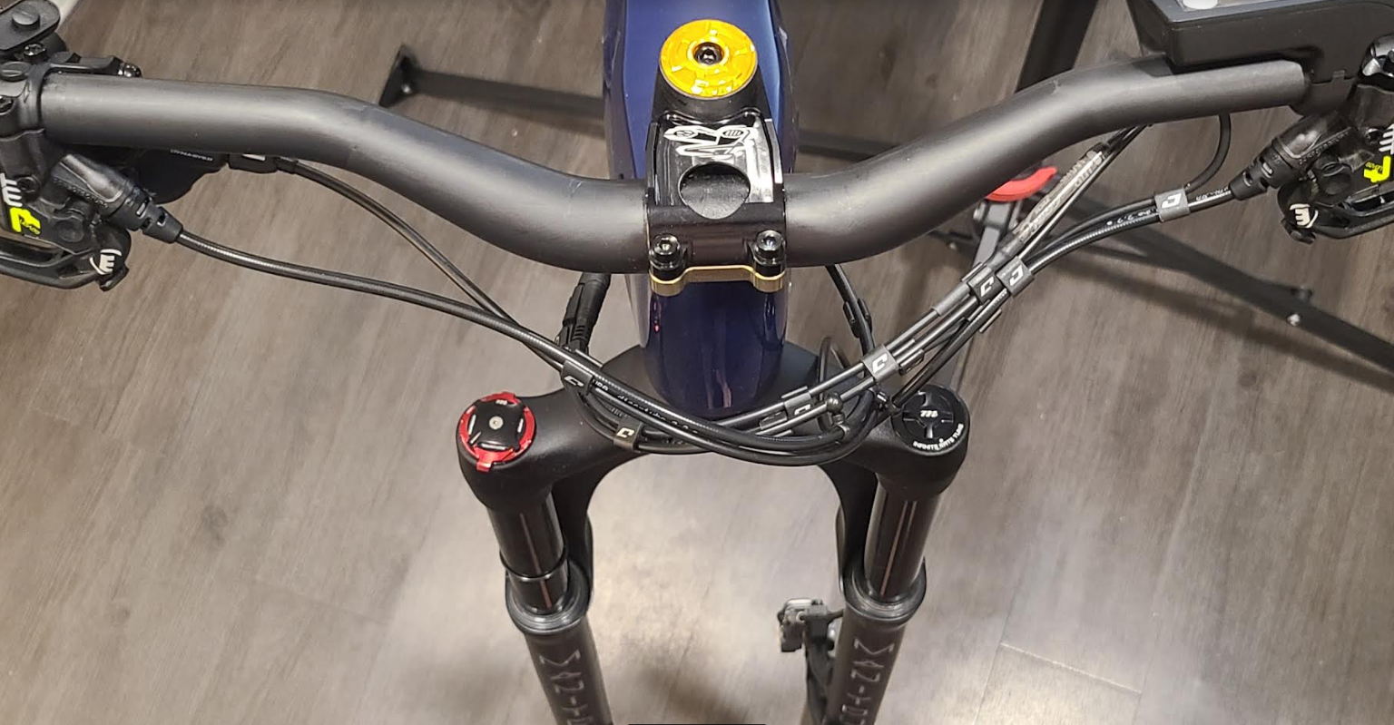

For cable management, a solution that's clean but allows you to easily change things around or remove the clips for maintenance are Jagwire clips. The have 4/4mm, 4/5mm, and then rotating hooks that are 5/5mm. Here you can see I use a whole mess of them to keep the front clean. I would like this solution for the cleanest cockpit: 750C display over the stem - but the display doesn't have that extra remote thumb switch on it - and then the brake input and throttle input goes right into the display, with one cable going back into your frame. Easier to have your wires run along or inside the bars to the display instead of along your shifter/dropper/brake lines into the frame. On my current setup this would only clean up the Tripwire brake cable - but the size of the switch on it kind of makes it a prime candidate for hiding inside the handlebars. I would like a slim 3D printed throttle though just for walking up stairs or clearing roots/rocks that might result in a pedal strike if I were to pedal. I'd love for wireless shifting but I'm hesitant to add the D1X module onto a chainstay vs something like SRAM AWS that's a wholly contained unit - but that price difference...

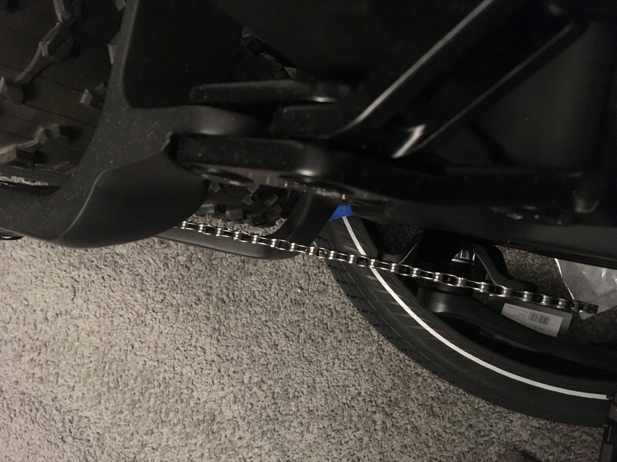

Here’s what I’m talking about with the 90mm wide Nextie’s. On the tallest two cogs of the cassette the chain rubs the tire.

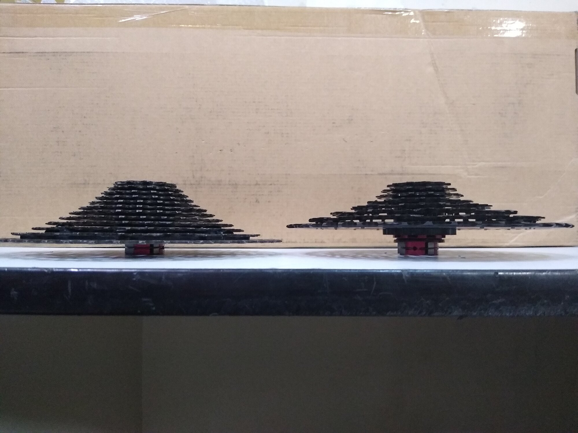

Back to the drivetrain. I had thought I might be able to make it work with my 12 speed Sram GX by spacing the chainring out far enough, but the chainline which would result on the biggest cogs would be really nasty. That may be OK for a manual fatbike (most have pretty crappy chainlines in the biggest cogs). But when you add Bafang power, I think a chainline that bad is just asking for a breakage.
While I considered the Box One Prime 9, which should offer similar geometry, I ended up going with the Sram EX1. Yes, the cassettes are ridiculously expensive, but they should basically last forever with the cheap replaceable top 3 gears. Here's why:
That's the EX1 cassette compared with the Sram NX 12-speed cassette on identical freehub bodies. As you can see, the large cog of the EX1 is between the 3rd and 4th cog of the 12 speed. This allows me to have a very, very good chainline for the entire cassette and have gobs of tire clearance. The J5's on 100mm rims have clearance to spare.
The EX1 isn't perfect, I have my nitpicks (as I do with everything) but in the end it works well and solves the problem. Allowing my E06 to run wheels/tires which give it the capability to run through stuff that would stop other fatbikes in their tracks is well worth it to me.
