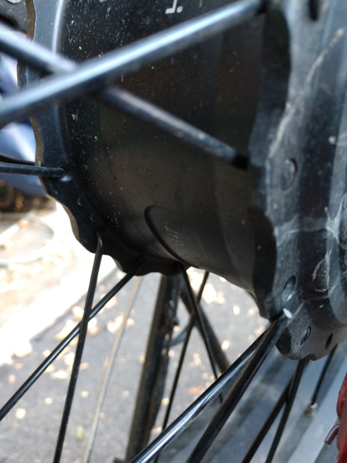

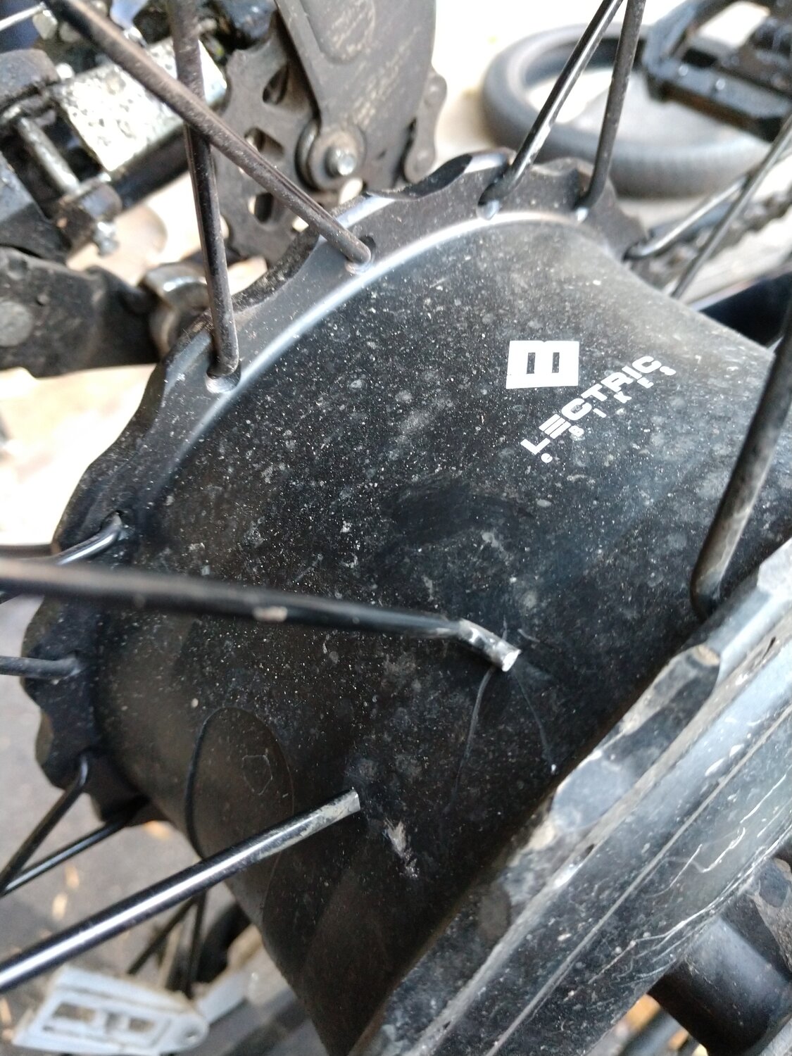

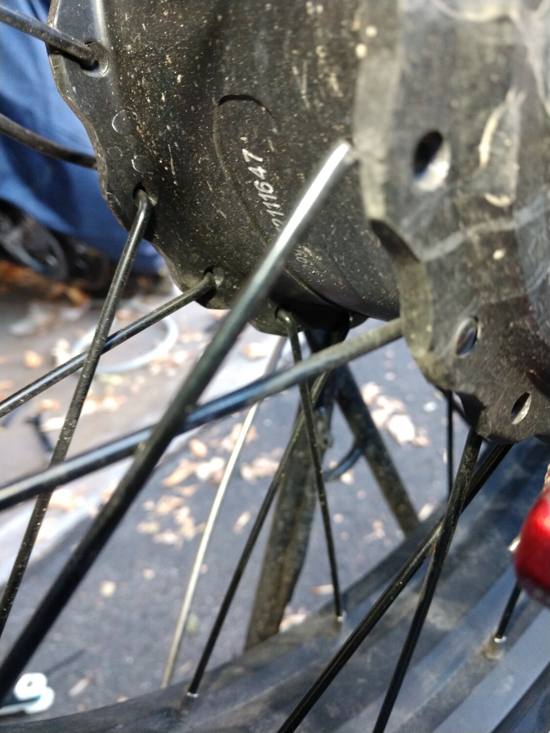

I have 2 myself just changed rear tire @ 2400 miles closing in on warranty
