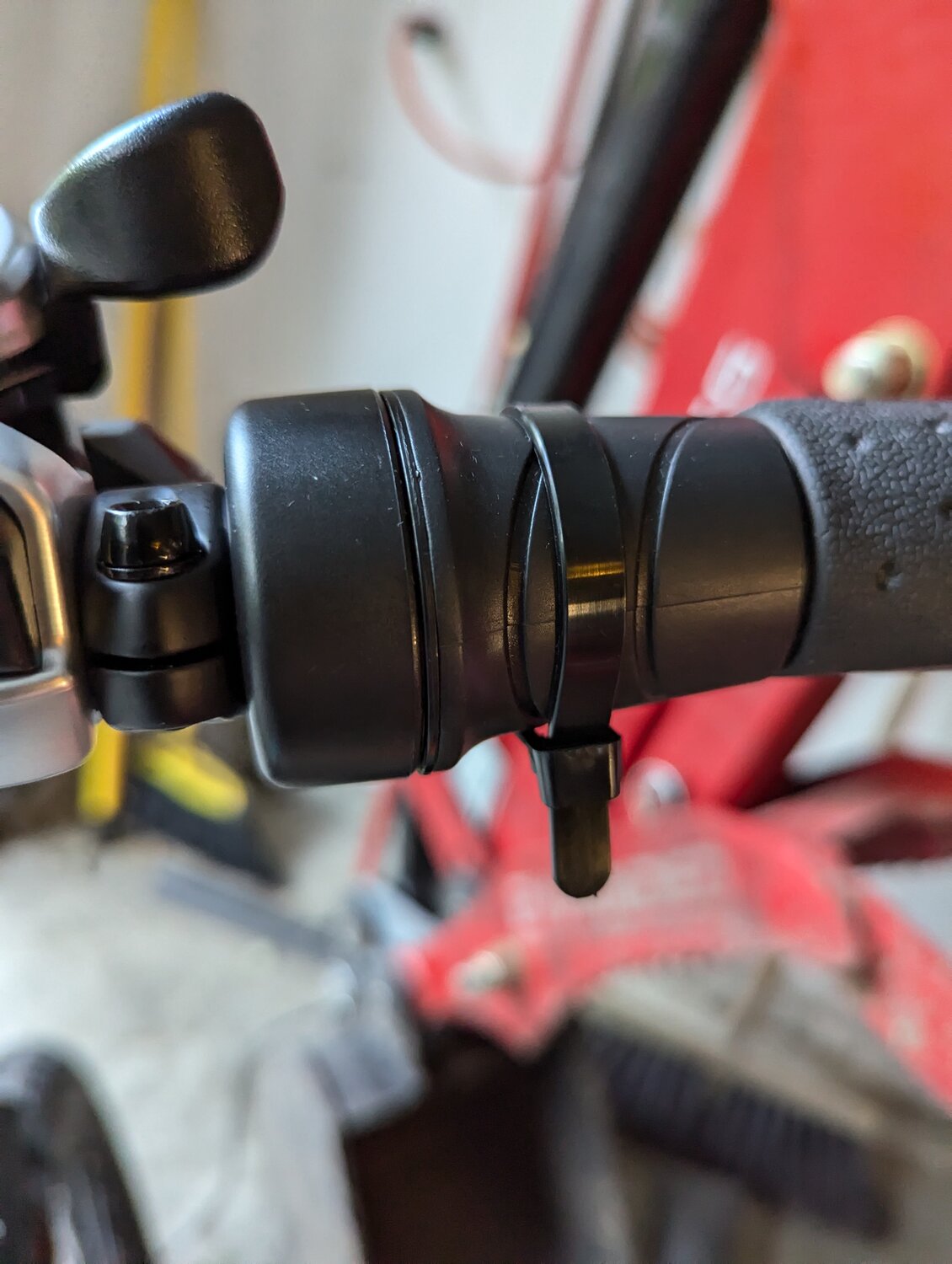

I'm still refining how to ride this thing, and yesterday I toyed with turning off pedal assist (setting 10), and instead used the throttle to assist pedaling as needed. Is that a thing that's commonly done? I must say, I much prefer it to the PAS modes, in that you could feather the assist...although "feather" is a loose term, the throttle seems to go from zero to top speed with little increment. I helped that somewhat by adding a "thumb lever" with a ziptie, seems to offer a little more throttle control.

Clever use of that ziptie to get finer throttle control!
Guessing that your ebike has simple on-off cadence-sensing assist — meaning that the motor's at full power when the pedals are turning and otherwise off, with nothing in between. In that case, assist level usually selects the maximum assisted ground speed when pedaling, not motor power level.
But a throttle, if present, typically overrides all of that — usually to a max speed of 20 mph. A progressive throttle then becomes the only way to get a motor power between off and 100%. Just as you're doing now.
An ebike with torque-sensing or power-sensing assist will dole out intermediate power levels according to rider effort. That calls for a very different riding style.
