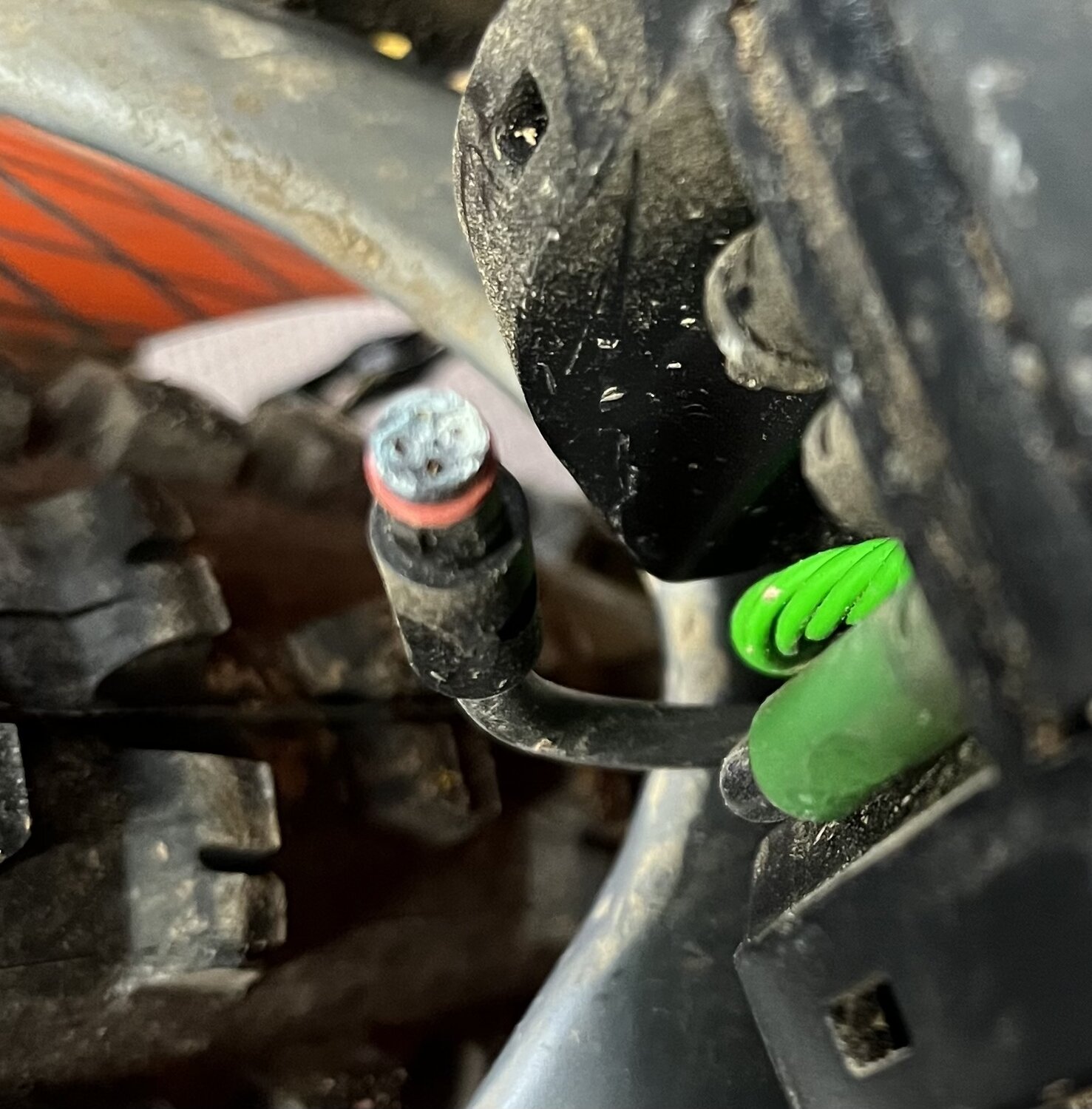

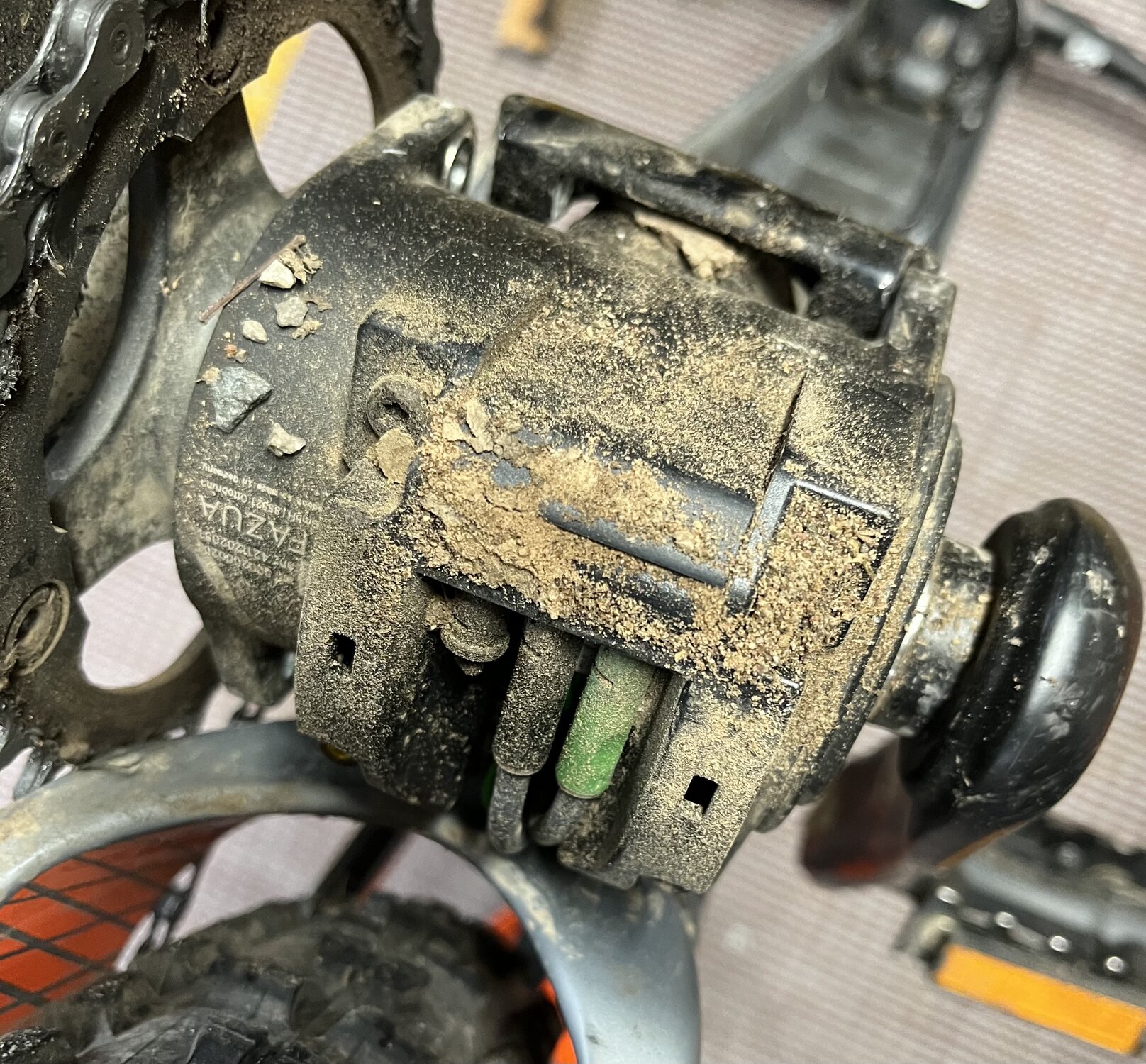

My Lappierre motor started to cut out after just over a month, then yellow light on remote. I could occasionally get it to work by disconnecting the battery whilst riding and restarting. After consistent failure I used the Fazua Toolkit diagnosis that said Battery & Remote “Not Detected”
I removed the Bottom Bracket Cover and it was full of gravel, dirt and the Remote Connector corroded! To me this cover acts as a collector for muck and water. I will reassemble with Silicon Spray and bigger drainage holes.
Still had the problem, returned it to the shop and they diagnosed a new bottom bracket with Fazua (they said pressure sensor issue)...waiting. After watching a Fazua manufacturing YouTube video I see they're a circuit board in there.
