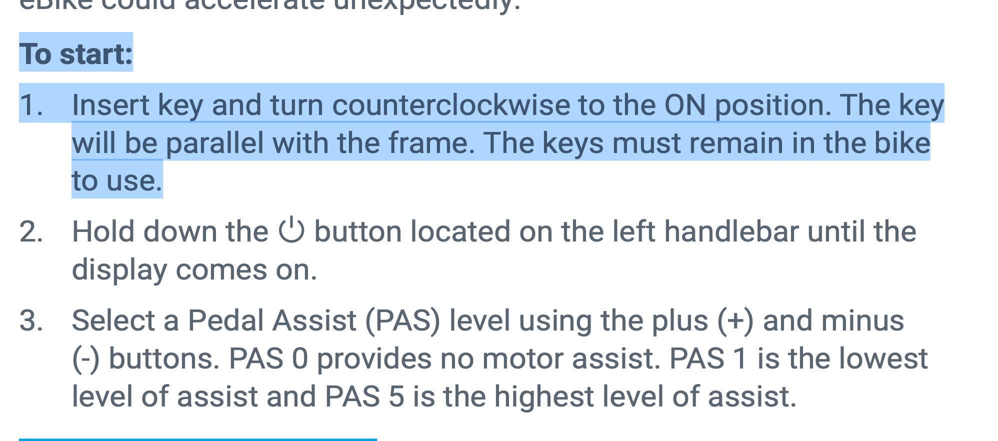

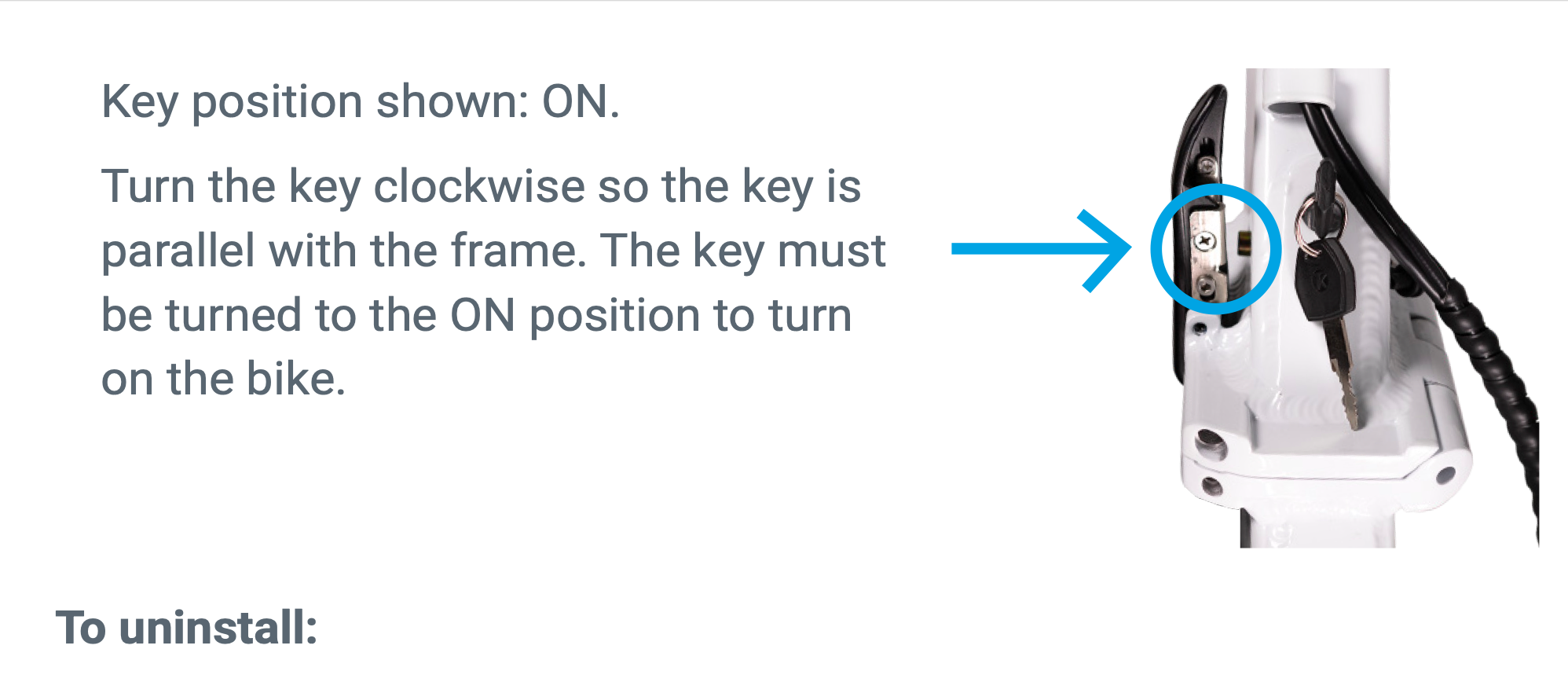

Fully charged unit and tuned the key every different way - even though the instructions aren't very consistent.

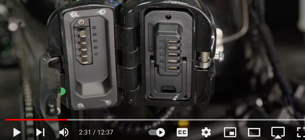

Well, I found the rear tire leak; you can audibly hear it come out when pumping with a hand pump. And I found that the clip for the battery safety was still in place (unit didnt have any manual and its not mentioned in the online version), but even after removing it, it wont power up.
edit 1800cdt
The presence of the battery safety clip caused the contacts to shift out of place.
I'll add, that even the QR code for the battery doesnt not indicate anything about the safety clip. The video they put up 3 weeks ago mentions it - at about 2min 30s watch - At a min the packing for the bike should include a link to the video.
The EASIEST thing for Lectric to do is put a BIG YELLOW sticker over the contacts so it cant be unfolded to the riding position without the removal of clip. SMH

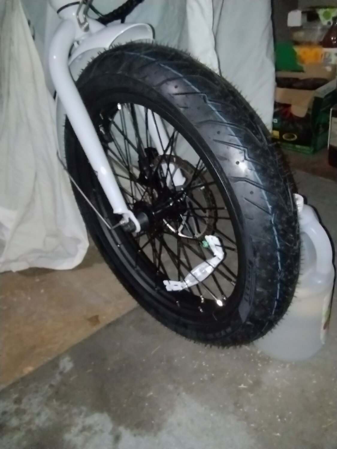

My XPedition (w/double-bat option) arrived (8/27/23) with two bad tubes. Both failed within 10 miles with a seam separation on the inside next to the rim. Ordered tubes on Amazon and replaced and all was well. Lectric did replace the tubes. But - because I hate flats I have since replaced the Lectric tires with Pirelli motorcycle/scooter angle tires (90/80-16, with motorcycle double-tough-tubes 3.00-3.25/16 w/TR-6 valve stems) and expect to get many, many flat free miles out of them. Shinko 241 tires are also good per sic puppy, who has a bunch of good info and who got me started on the alternate tire investigation. The new tires weigh around 3lbs more than the original but ride really well - nice and smooth. I only ride on the street and bike trails. I usually ride my un-powered TREK but go shopping on the XPedition. We are lucky to live near many bike trails that run near several shopping areas. I'm retired (73 yrs old) and seldom start my car anymore. One note - check those valve stem cores. My rear tough tube arrived with a loose valve stem core and was losing air. Gently tightened the valve core and all was well. Another note - the Pirelli tire and tube setup is so stiff I rode several miles (made it home) without realizing the rear tire has lost all its air...!!!
