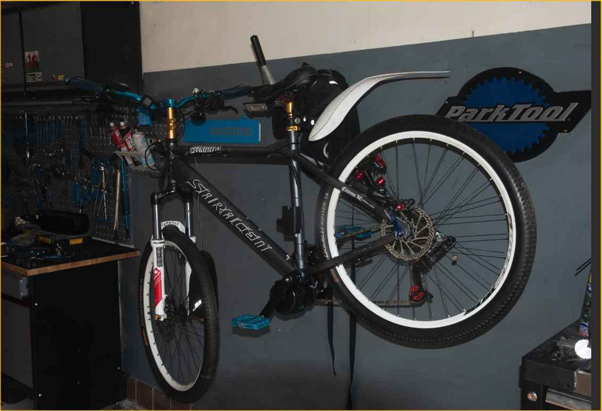

I was watching a video on Magura brake pad replacement, and the dude was using a bike stand to hold his "e-bike". I am wondering if one that has 'supports' would do the trick, over a flat plate style stand such as in the second image. It has a foot pedal to operate the lift.

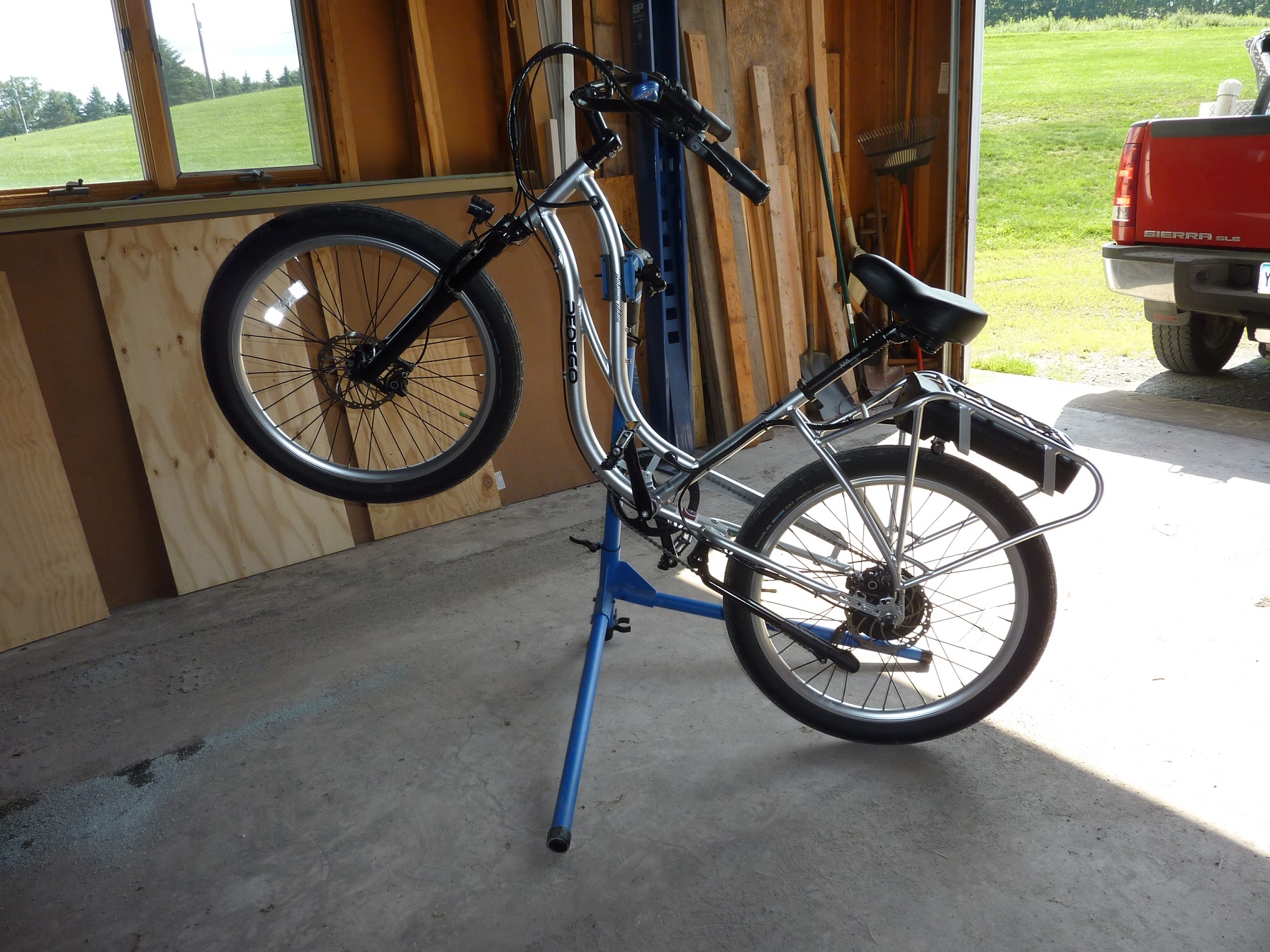

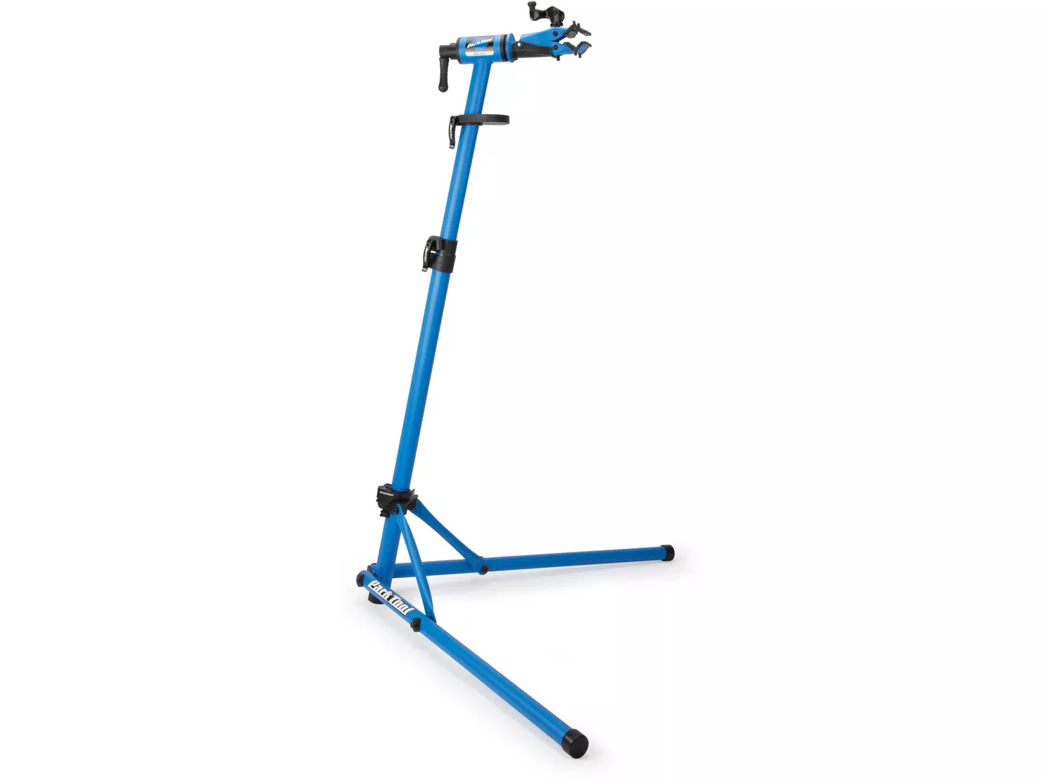

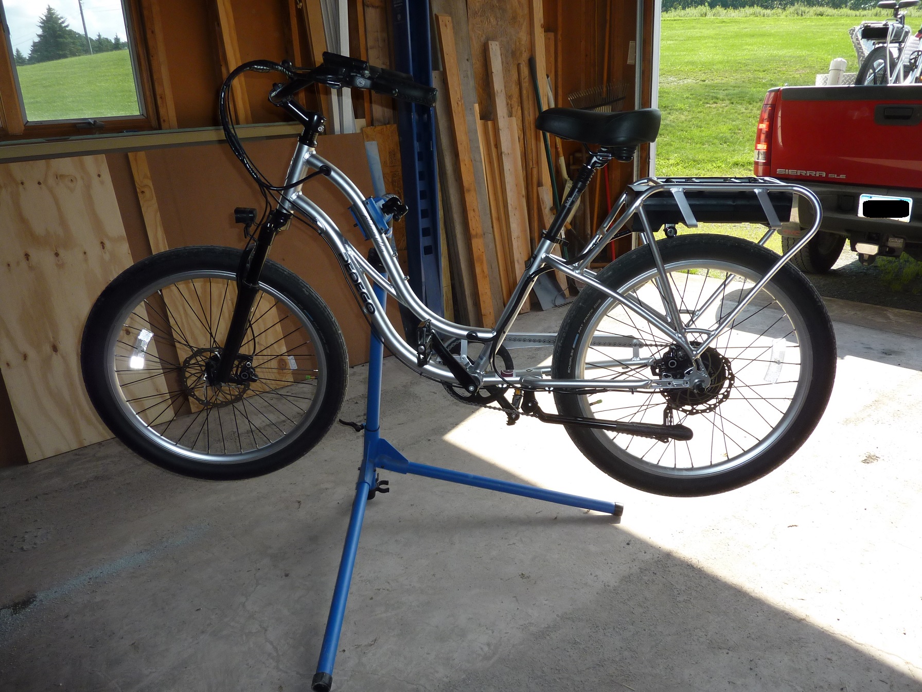

I have the Park PCS 10 shown above and I use this trick.
I first lift the lighter front end of the bike and clamp it in the stand:
I then pivot the heavier rear end up into position:
No need to lift the full weight of the bike.
The process can be made easier by setting the front wheel on a milk crate while attaching the clamp.

I have a stand, a Feedback stand similar to this one.

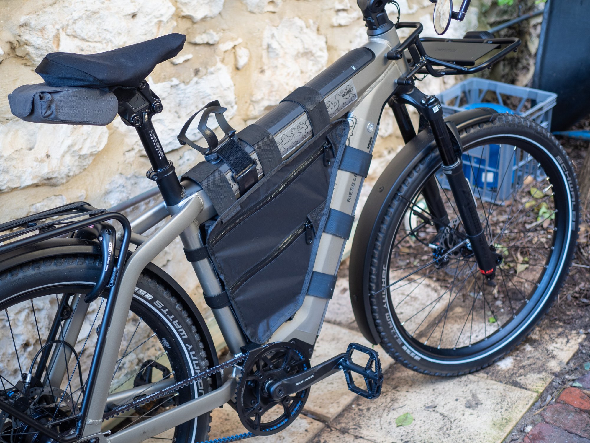

My bike, however, is a Riese and Mueller Supercharger, which has a battery in the top tube and the down tube, making these tubes significantly larger than most bikes and hence not ideal for this stand. My only option for clamping the bike is the seat post. So that, in combination with the bike weight, ~ 32 kg before the batteries are taken out, does not make it the greatest option, hence I am curious as to the stand used in the video.
Oh BTW our house was built in 1896 ... we do not have a garage to mount a stand to a wall :)
Oh, the bike is this one:
