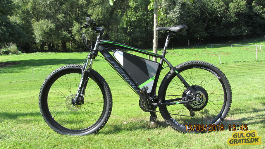

Hello Anyone would be able to comment on this custom bike, I can get it for 3270$
Bike Specifikation:
Frame:
20”, 6061 Aluminium
Front fork:
SR Suntour XCT w/MCD 27.5, coil spring, custom Multi-Circuit damping, 100mm
Rear Shifter:
Shimano Acera RD-M3000, 8-speed
Front shifter:
Shimano Acera FD-T3000
Breaks:
Shimano BR-M395, hydraulic disc 160mm
Tiresize:
27,5
El Specifikation:
Motor: Mxus 30h (10x6)
Sine Wave Controller 45A med LCD3 Display
Battery: 16S 8P, 67V, 28Ah
Max Power: 3000W
Max Speed: 70km/t
Pedal Assist: City Modes (160W-20km/t, 450W-45km/t) Off Road Modes (750W, 1100W, 3000W)
BMS (Battery Management System)
Distance no pedaling:
165 km (25km/t)
115 km (35km/t)
Distance with pedeling:
cirka 300 km (20-35km/t)

Custom bikes are built for custom applications. They are not normally an attempt at middle of the road/will work well for the majority of riders. Point being, if you have done your homework carefully defining how you plan on using your bike, and the bike in question suits it better than less expensive BRAND NEW bikes, then yes, it might be worth 3270. Even then, value would depend heavily on the age of the battery.
well it has really low end components. no clue on the motor or batteries but the bike hardware is low end. something that has that much power has really low end brakes.
OMG - performance specs...it’s a flier!!
I’m not aware of another ebike like that, so if you’re looking for that kind of performance it could well fit the bill.
Holy smokes!!
Wear a motorcycle helmet and guards!
Holy smokes!!
and a ancor to help stop you :D
When I test rode a Giant Explore unleashed to 30mph, I was doing some 'round-the-block' runs, braking into corners and speeding out - brake discs got too hot to touch. I wanna say red-hot, but probly not. 🤣
Those kinds of speeds scare the crap out of me on a bicycle. A hundred on a motorbike doesn't, it's built for that. But a bike? WOW!!
Some of the components aren’t so hot, and a homebuilt 16s battery from an unknown source or cells, and a mediocre MXUS.
68v battery takes the electrics to a whole new level. I’d Run.
