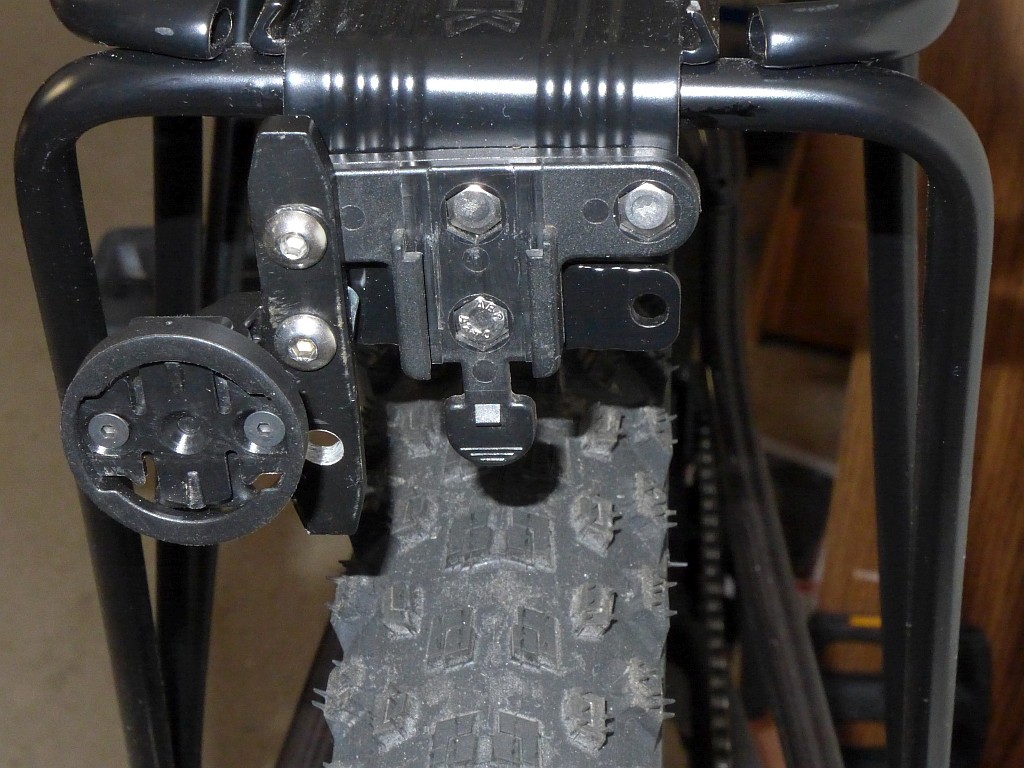

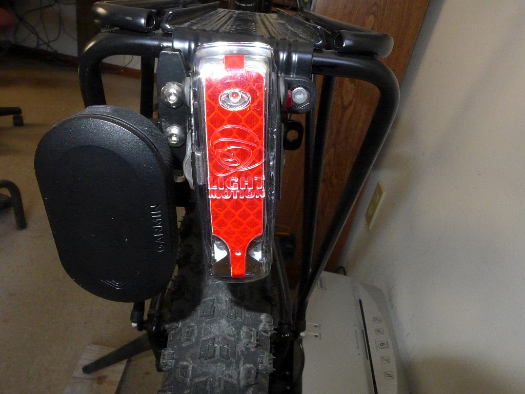

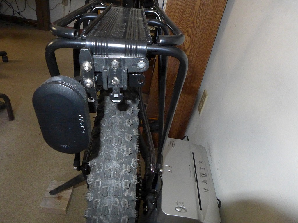

As Stefan pointed out, the Garmin Varia does communicate with the TCD-w. I tested that recently on my new Tero 5. There is also a Garman Varia app for your cell phone, as well as Ride with GPS works with the Varia. I have installed the Varia and my tail light on the back of my Topeak 29er rack as shown in the accompanying photos.

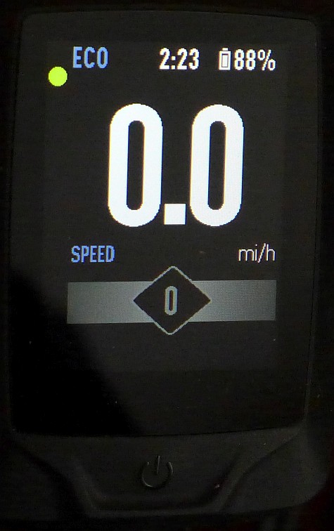

Here is a photo of the screen of the TCD-w Gen 2 showing the Varia in the no approaching traffic mode - a green dot. Click on the image to see the full screen and the green dot.
But does it show more than one and does it show approaching and passing?
I'm sure it works as intended.
