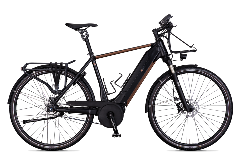

I have pretty much given up on my idea of swapping the Nuvinci for an Alfine on my R&M. On another track, I was checking out all the bike makers that use Brose systems (thinking my next commuter bike purchase might have a Brose instead of a Bosch). And via that search, I stumbled on this bike which uses Continental's motor, has a Gates belt and the Alfine 11 hub ... very interesting (to me at least). I'd be curious as to comments/thoughts on Continental's system, the use of the Alfine 11, comments on the bike etc:
https://www.ebike-manufaktur.com/de...shimano-alfine-11-gang-disc-continental-600wh
