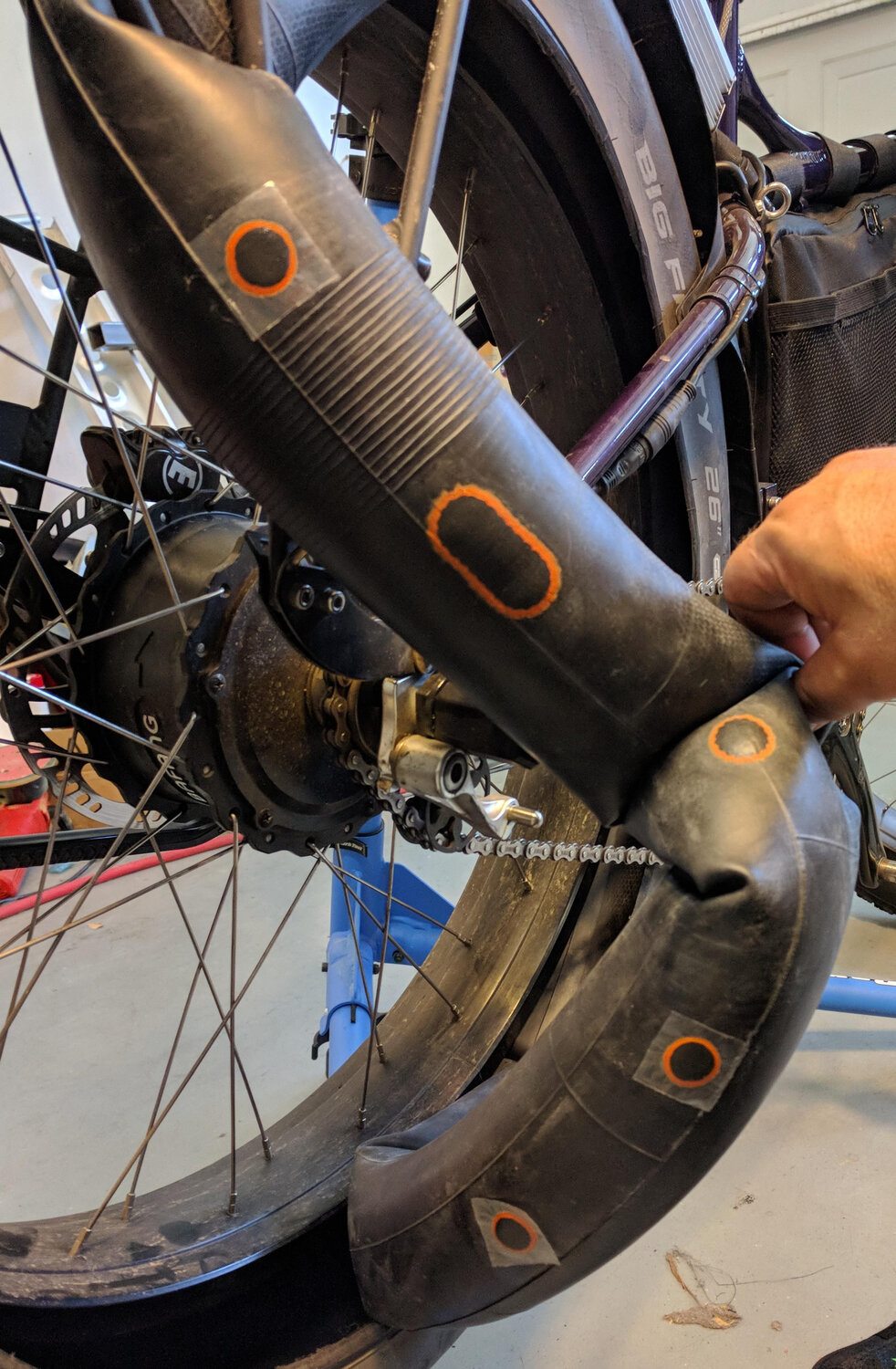

Its a lot less than that! Lookit this pic taken from that article on flat prevention I linked above. Notice anything about the wheel?
Its still on the bike! No wrenches. No disassembly. I had the bike up on a stand in this pic, but I have also had it laying down on the grass (or dirt if I am unlucky) on the side of the road.
There is no need to remove the wheel.
Just get the tire off the bead and pull the tube out just like I am doing in this pic. From there you have to find the hole. Hopefully you have an idea of where to look from pulling whatever it was out of the tire. But if you do not, then inflate the tire some and find it either visually or do this: Run your ear close to the tube as you work your way around it. It WILL require some effort to deal with the fact that the tire is still on the bike frame, but you can do it... especially on a fat bike. If you can hear the hiss but not find it, then when you get close ... put your lips close to the tube and that sensitive part of your body will feel the slightest escape of air where other body parts may fail you.
Obviously you want as few witnesses to this as possible. But as a daily rider who rode fat bikes for years commuting, not to mention many others back in the bad old days before sealants like FlatOut were on the market and mostly saved my ass from having to sit on the ground and go thru this... the lips are the way to go if you are stuck and can't find the hole.
