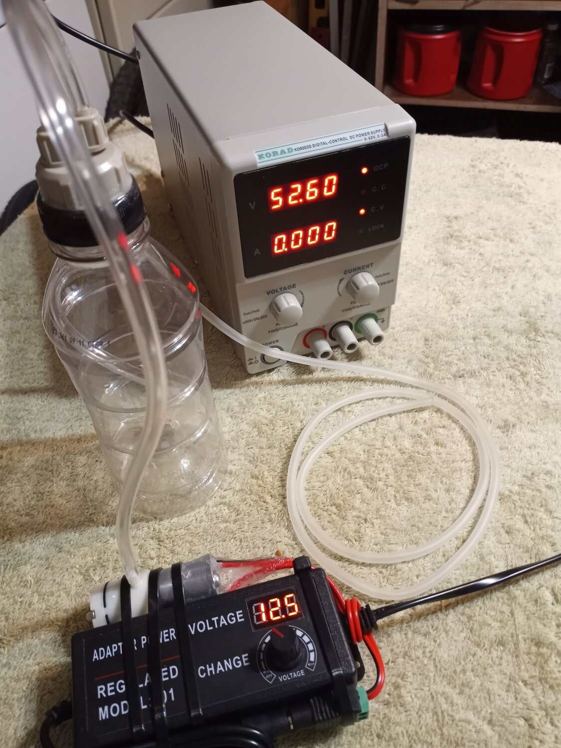

I built a vacuum pump for my brakes too,..

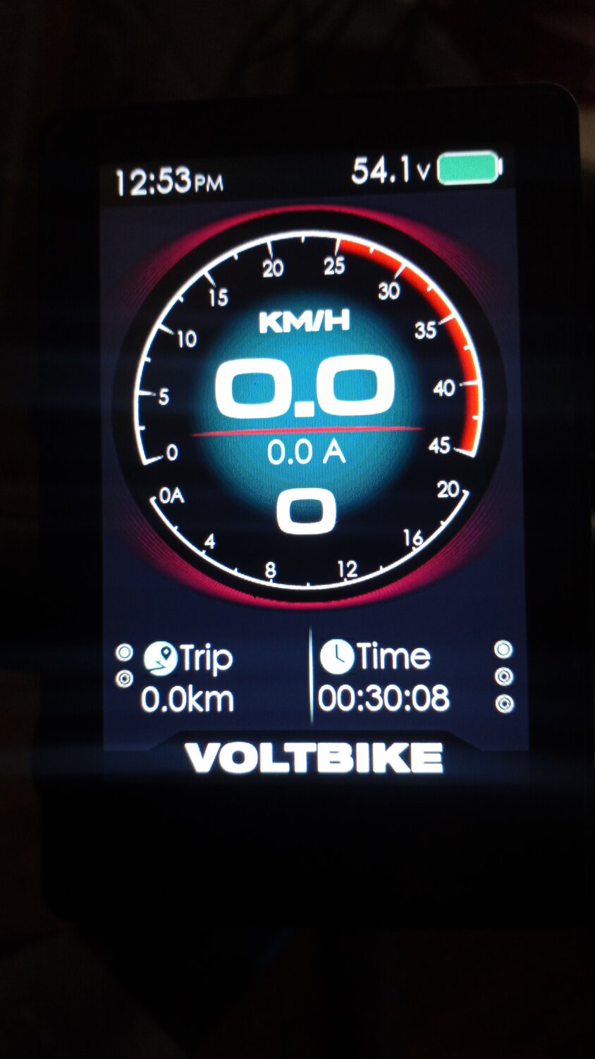

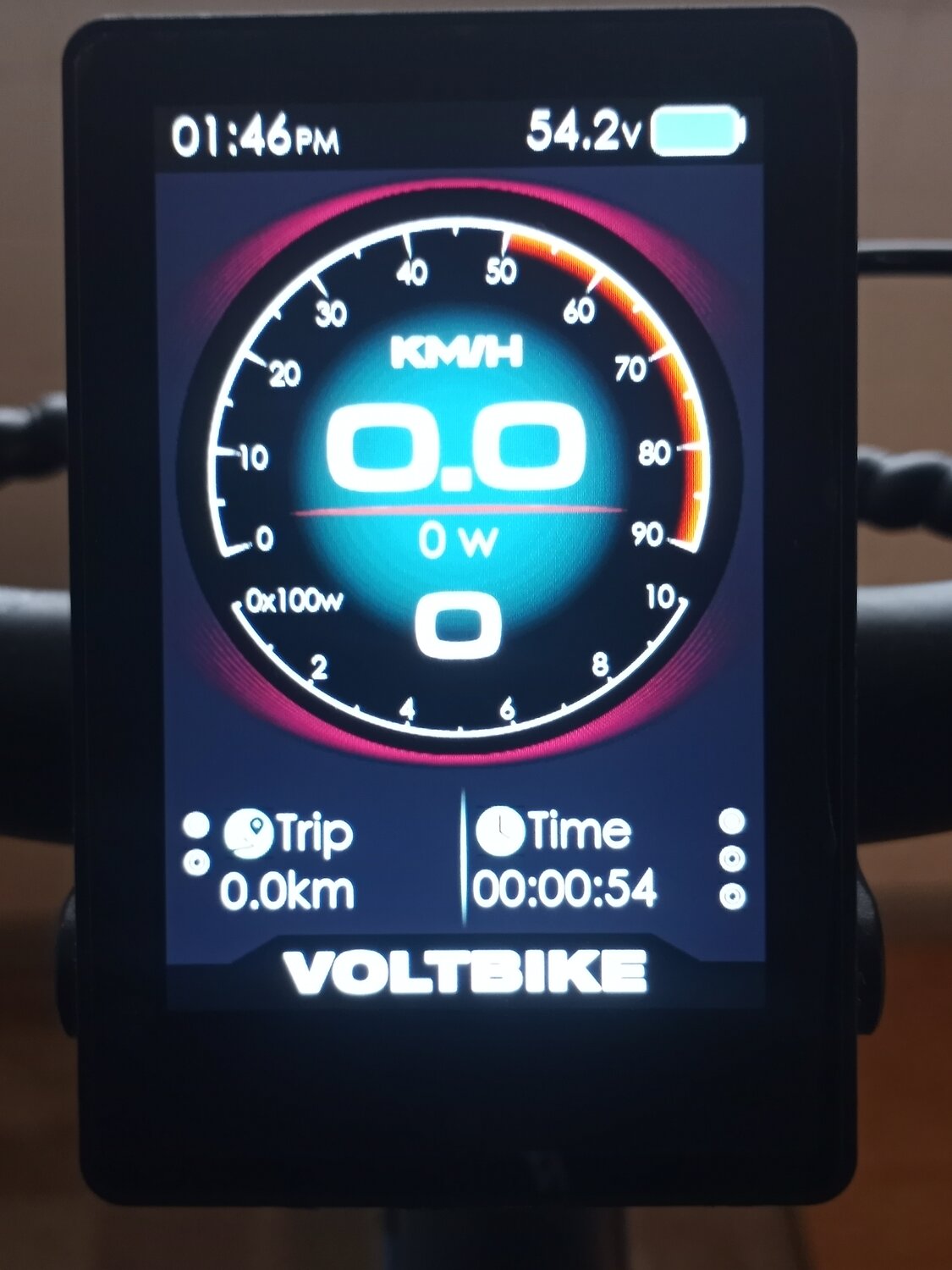

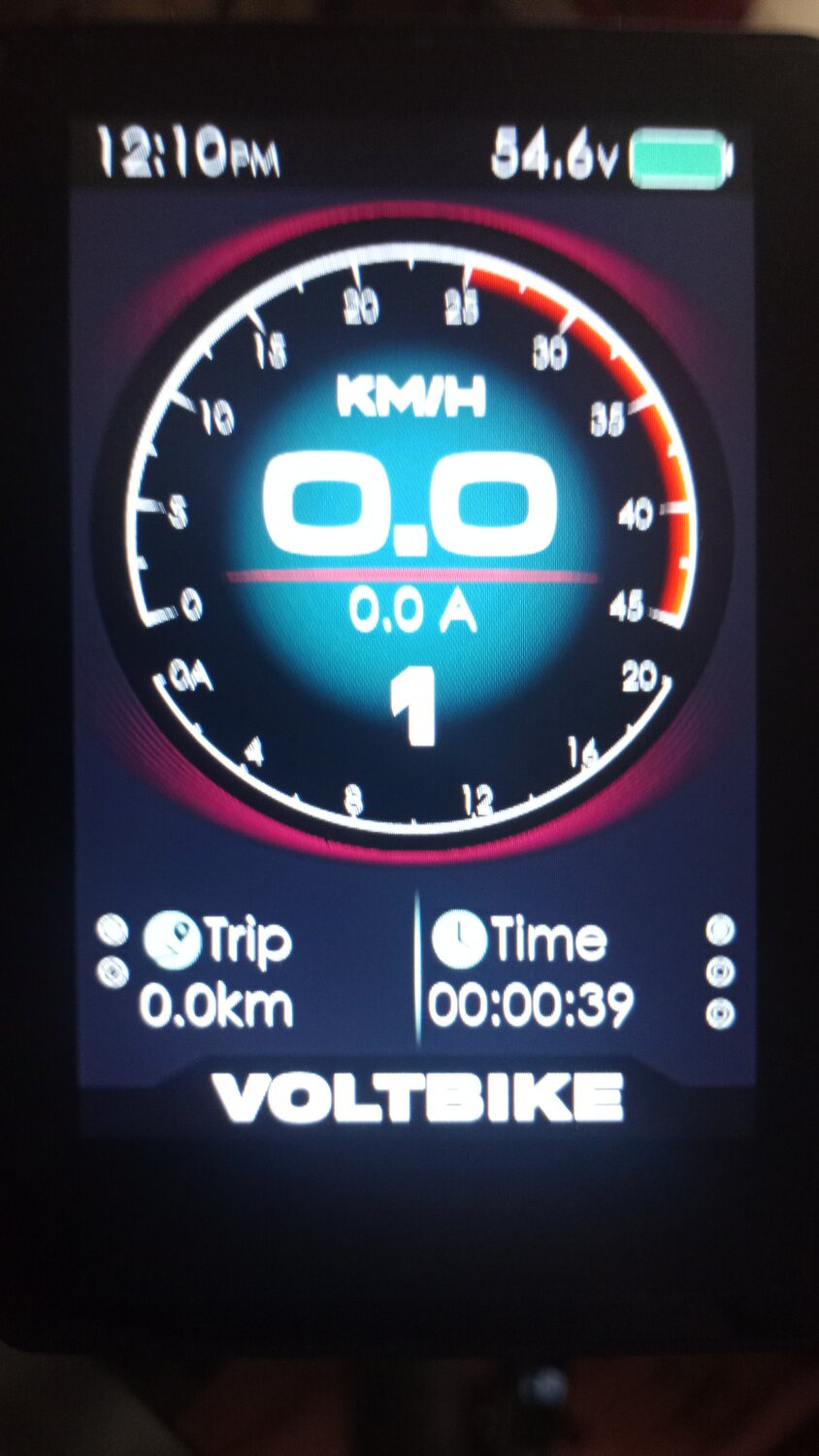

I used my new power supply to charge my 25ah battery to 54.6v and waited for the current to drop to zero to fully charge it.
I charge my secondary 19ah battery to ~52.5v so that I don't feel obligated to use it if I don't need it.
I have a separate 3 amp UL listed charger that I turned down to ~52.8v so the light turns green at ~52.8v

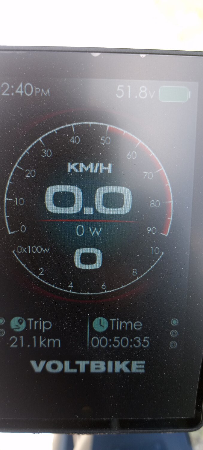

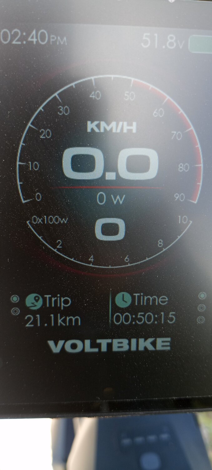

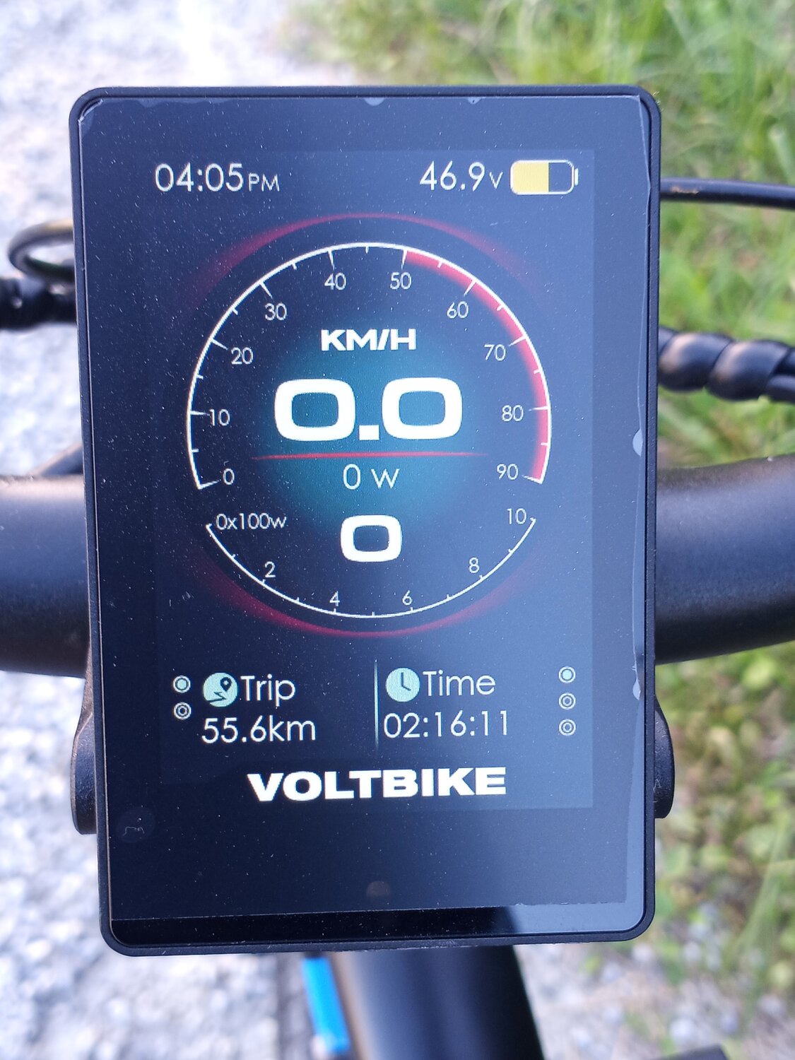

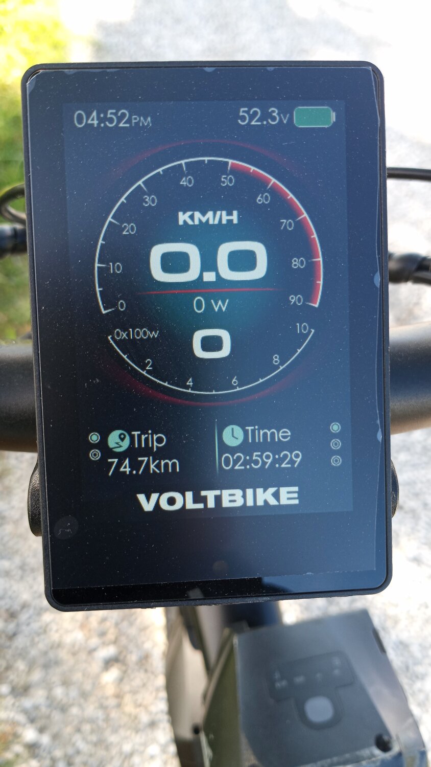

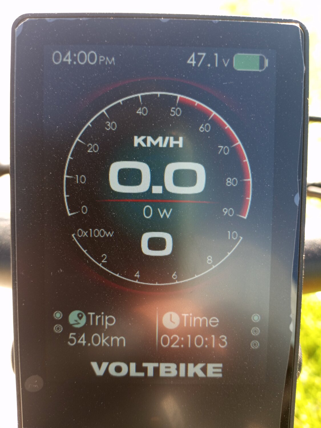

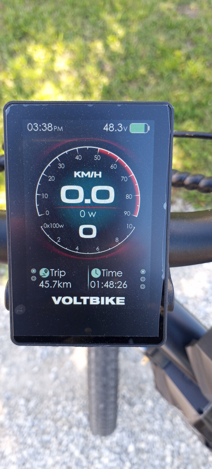

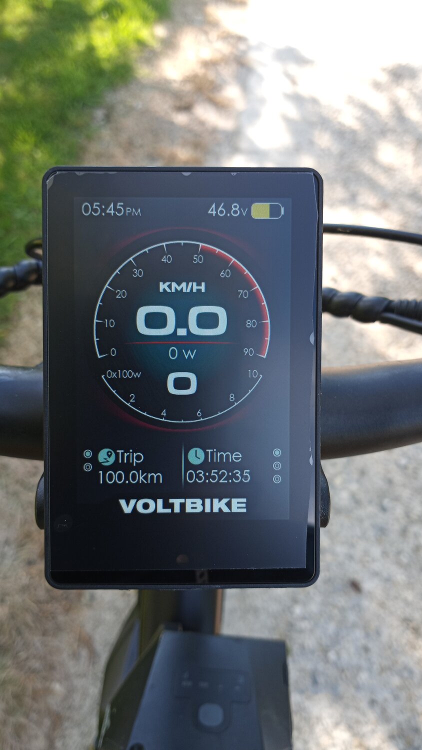

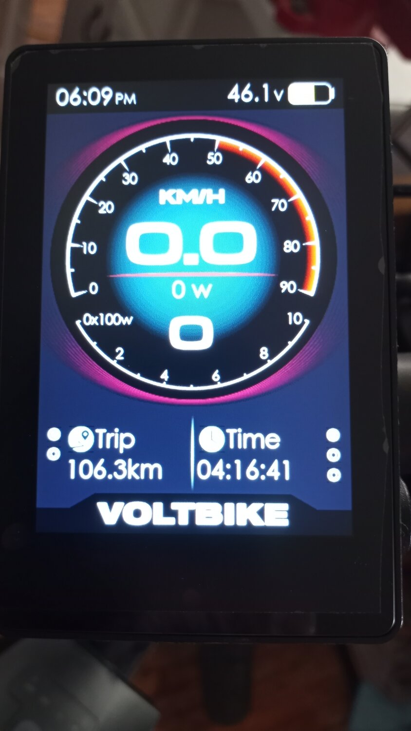

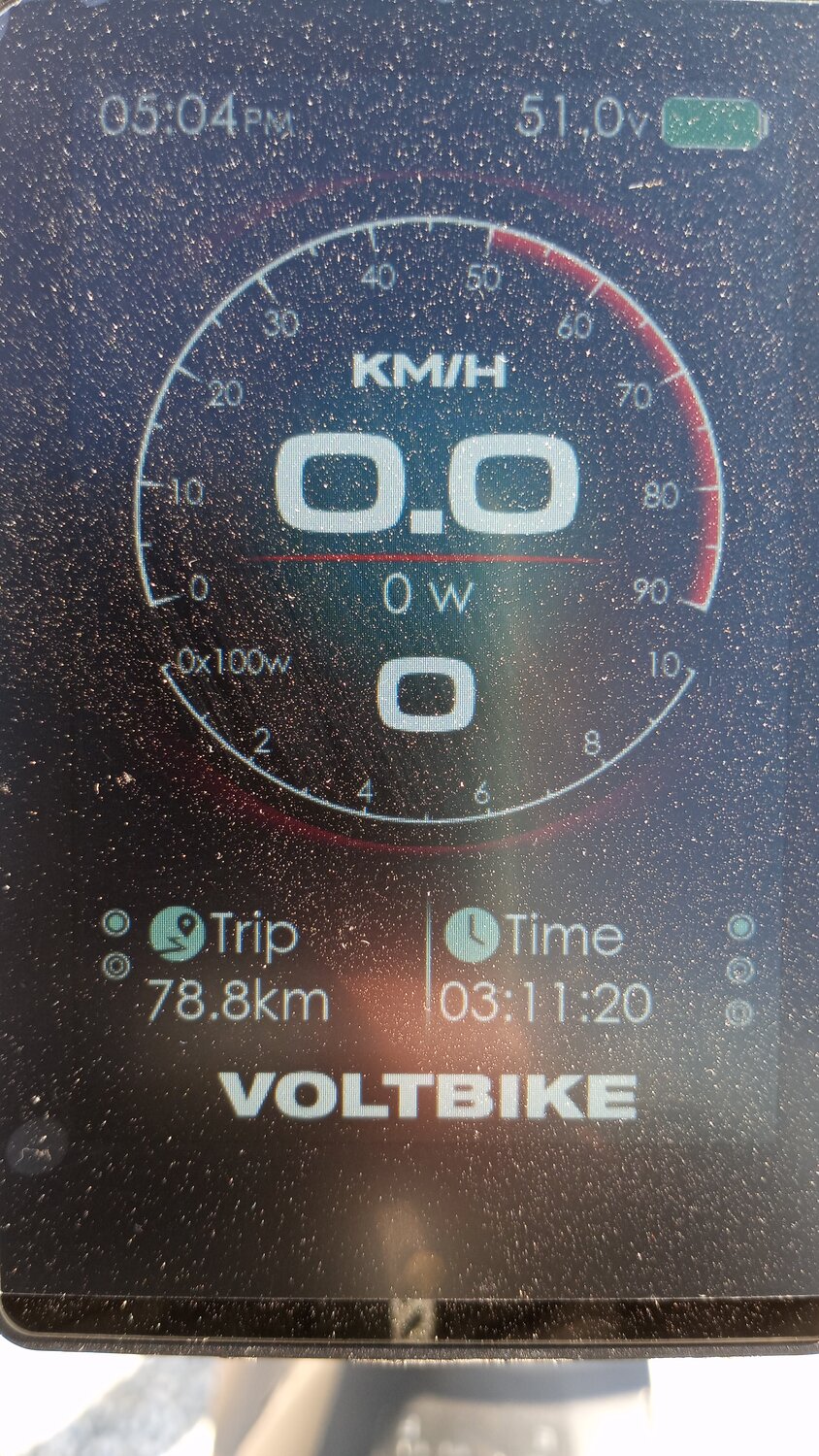

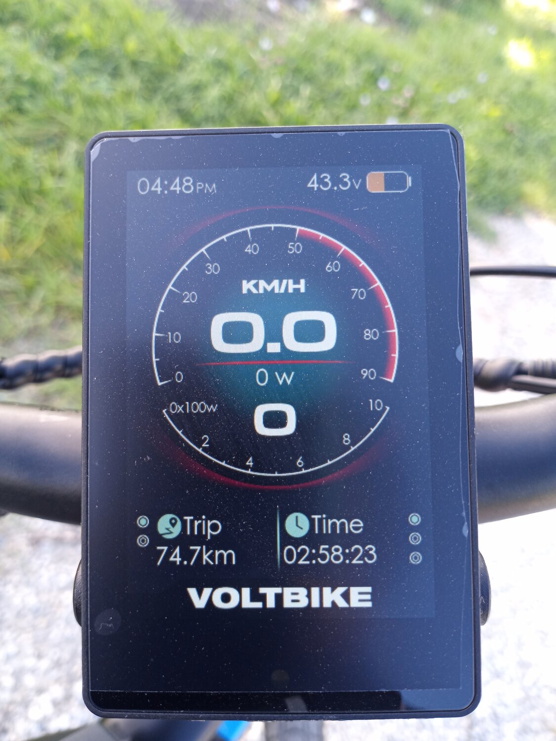

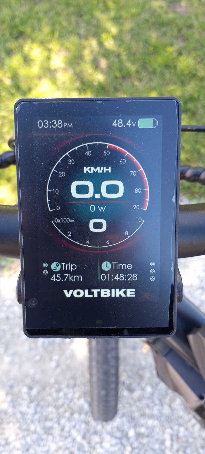

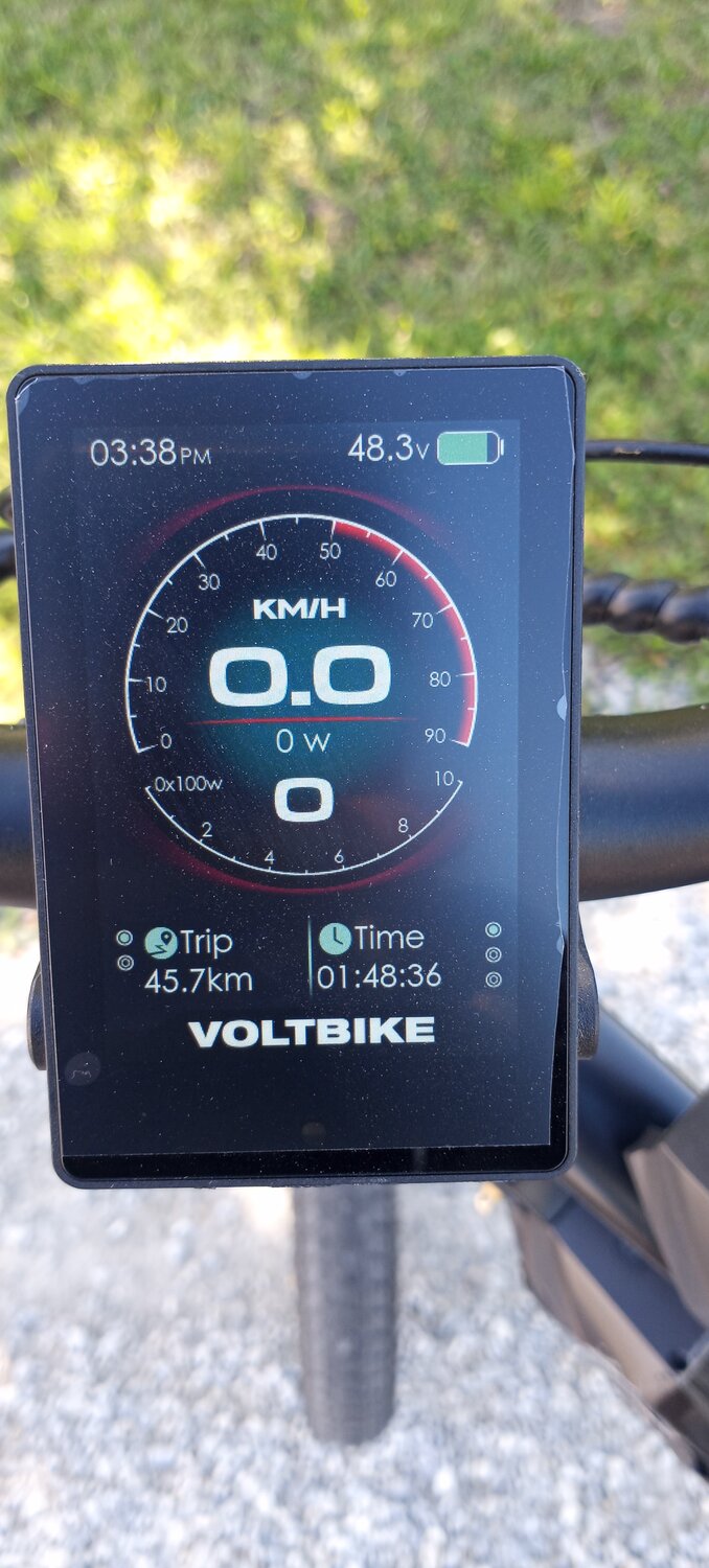

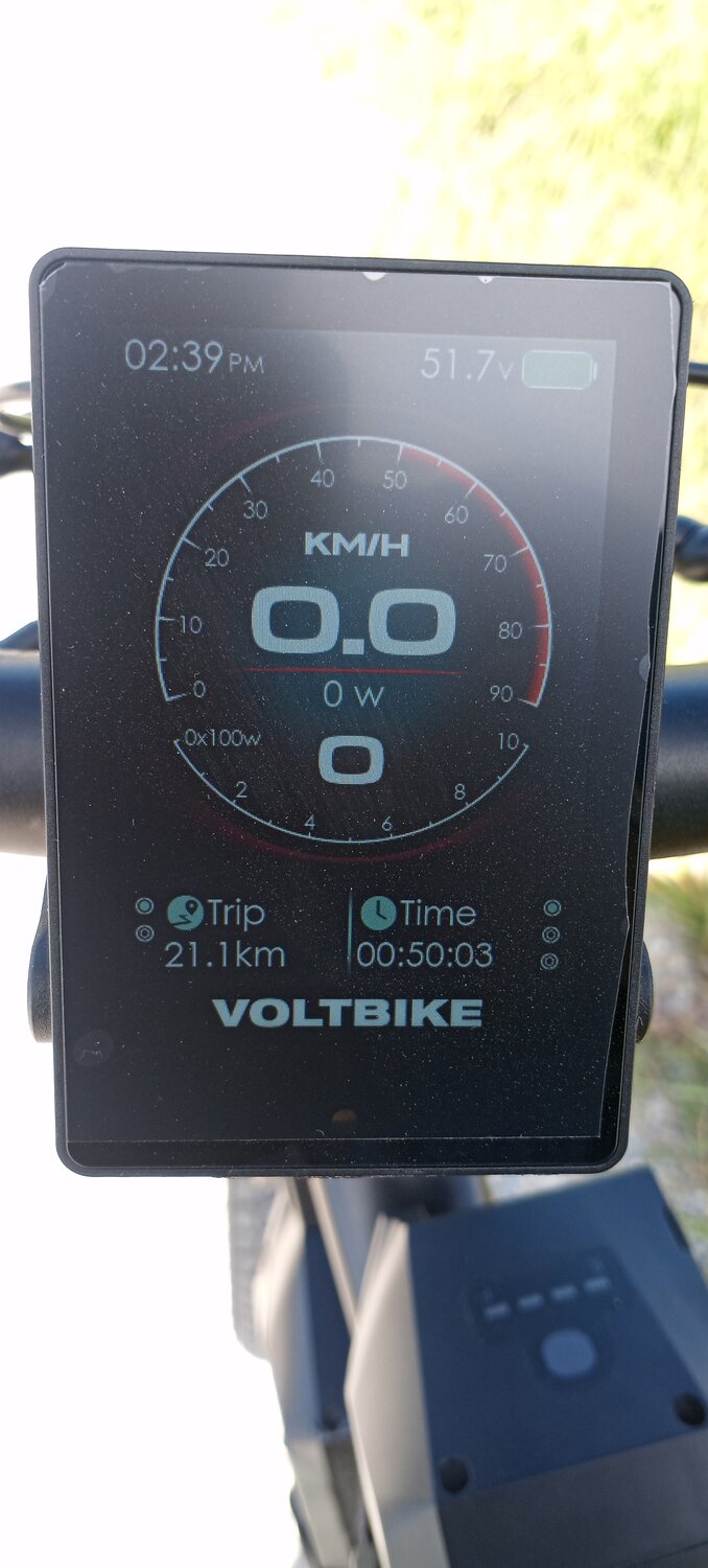

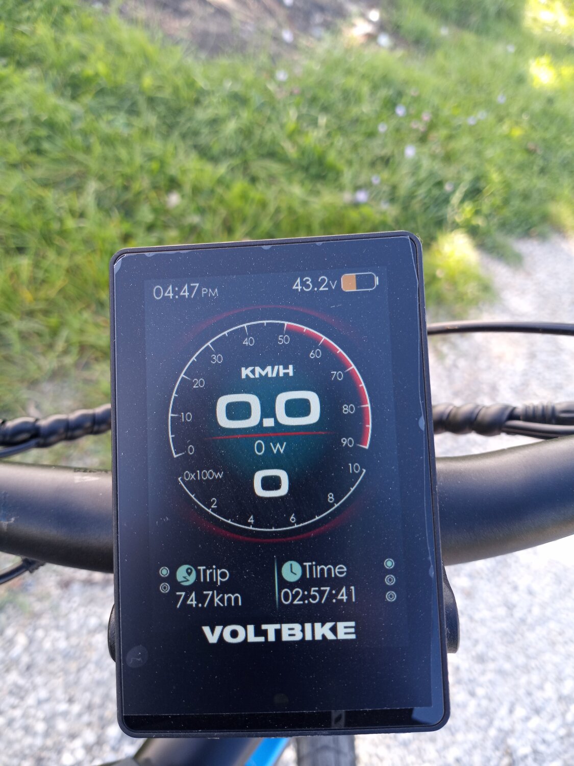

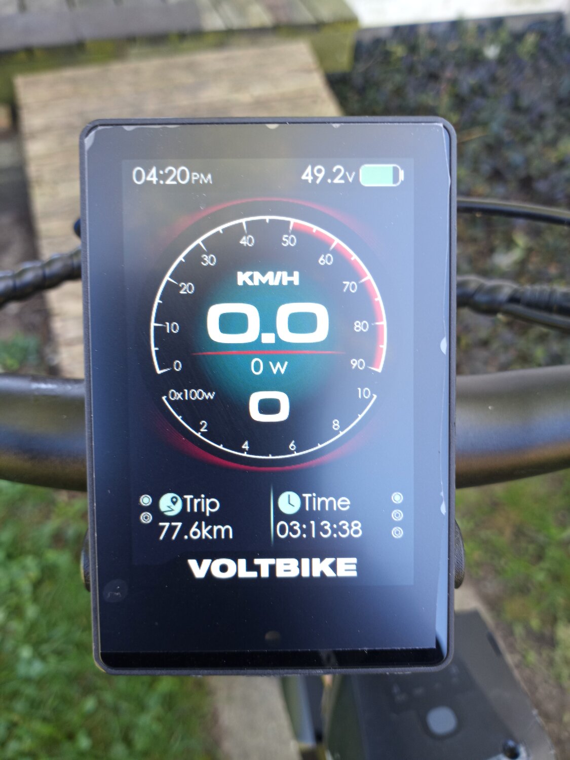

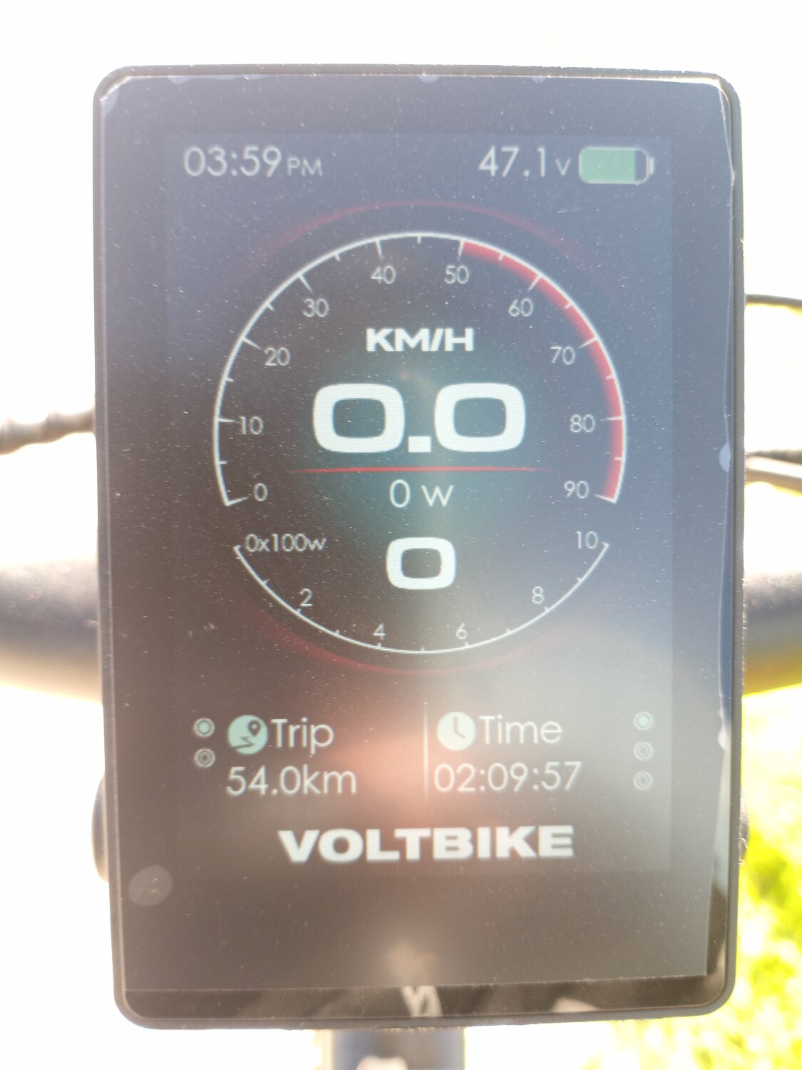

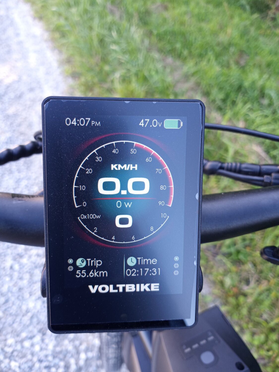

I finally decided to try and keep track of my voltage, mileage, and distance by taking photos of my display.
I suck at taking notes, and this was the simplest way for me.
Even though I charged the battery to 54.6v the voltage dropped to 54.2v within a few minutes,..
I lost an entire volt in 5 minutes.
You can see the voltage rebound after sitting for a while,..

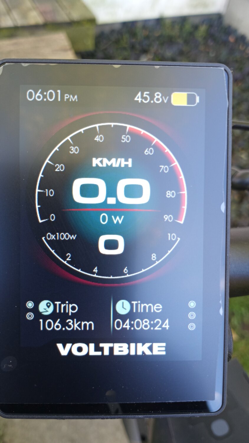

The battery meter turns yellow below 47v.
It turns orange around 43.5v
I forgot to look to see when. 😂

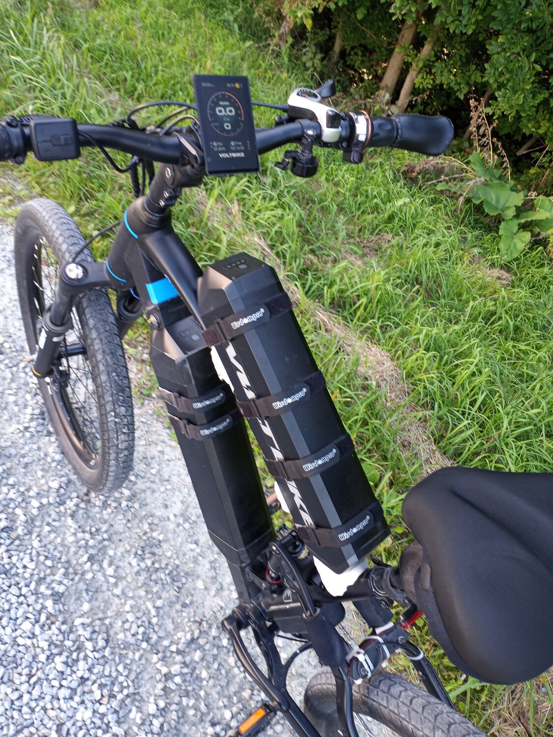

I found the shade of a tree to pull over and swap my batteries, and there happened to be a brush fire.
It smelled like camping. It was kinda nice.

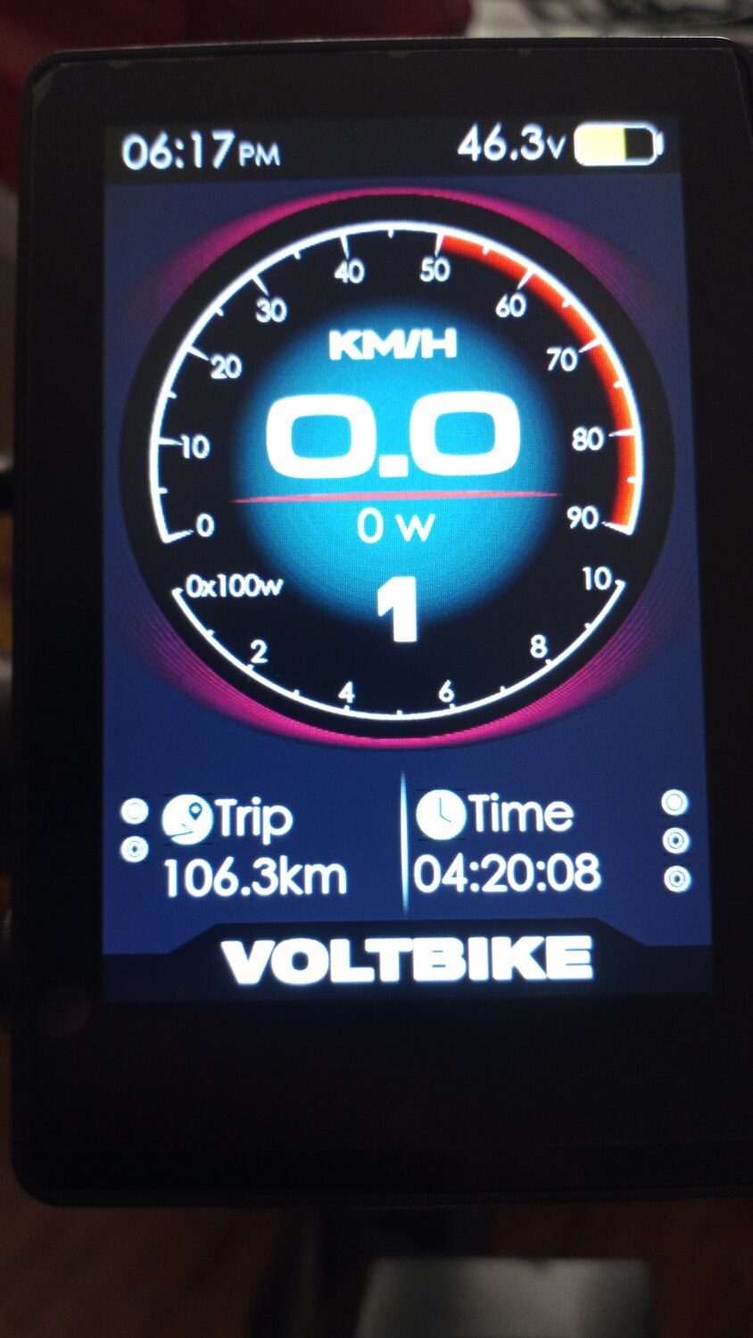

Installed the 19ah battery.
I arrived home at 6pm with lots of km left on the second battery and a 106 km ride.
I decided to charge my battery at 4:20 because it was time to smoke a Vado. 😂
That turned out to be kinda wrong.
I didn't actually let the current drop to zero.
It was more like a ⅓ of an amp or so, so I figured "close enough".
Today I was fartin around getting ready and the current dropped to 0.018 amps when I was finally ready to go.
The voltage was reading 54.6v on the display when I unplugged the charger, then dropped to ~54.4 - 54.5 volts.
I didn't bother taking a picture, then forgot to check the volts at 10 km, but I'm pretty sure it wasn't anything near 53.5 volts.

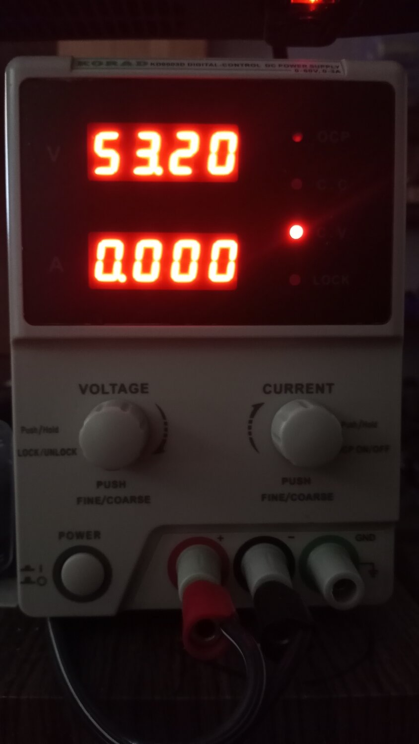

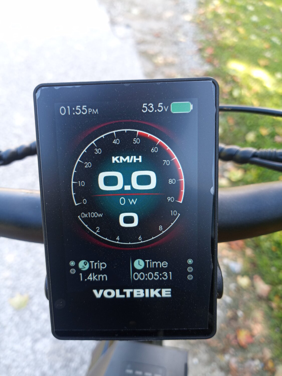

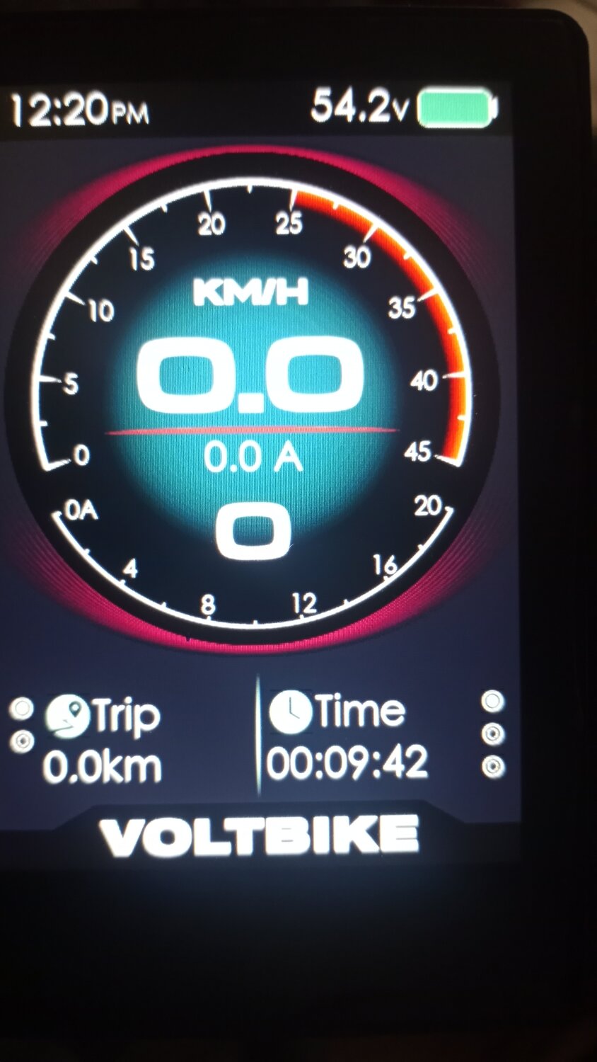

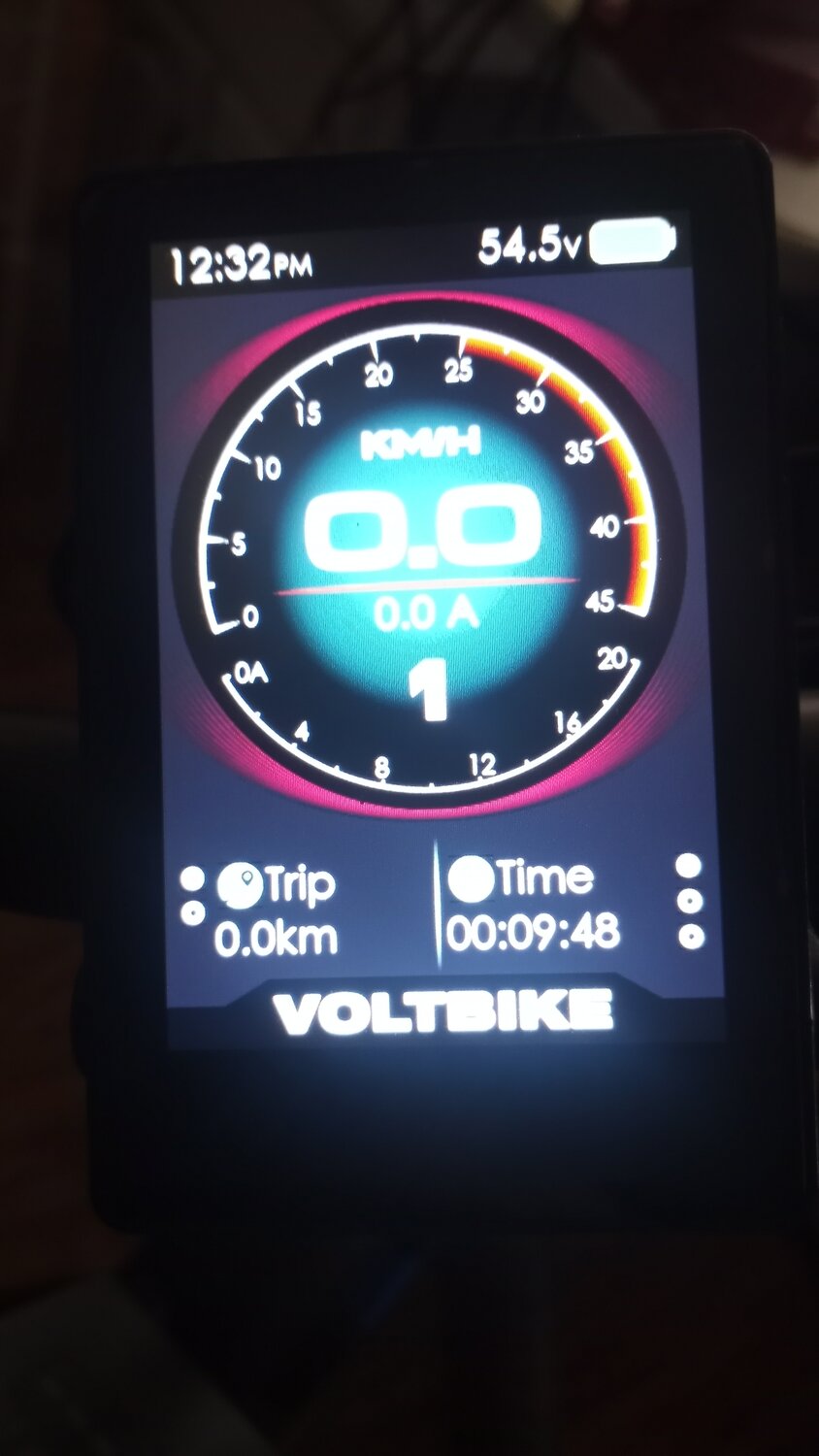

I think that I figured out what's going on with my battery and how it's losing a volt so fast.
I charged my battery up to 54.6 V and unplugged the charger,..
Then I left the power on and let it sit for 10 minutes,..
Then I shut it off for ten more minutes the turned it back on,..
After 43 minutes I started my ride and the voltage was down to 54.1 volts and the motor had not been powered up yet.
All my 3 batteries behave the same way using any charger.
I'm figuring that just the idle current of the controller being powered up for ½ an hour is enough to lose the first volt.
I think that it's normal for that first volt or two to disappear quickly.

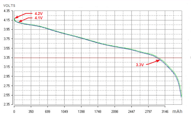

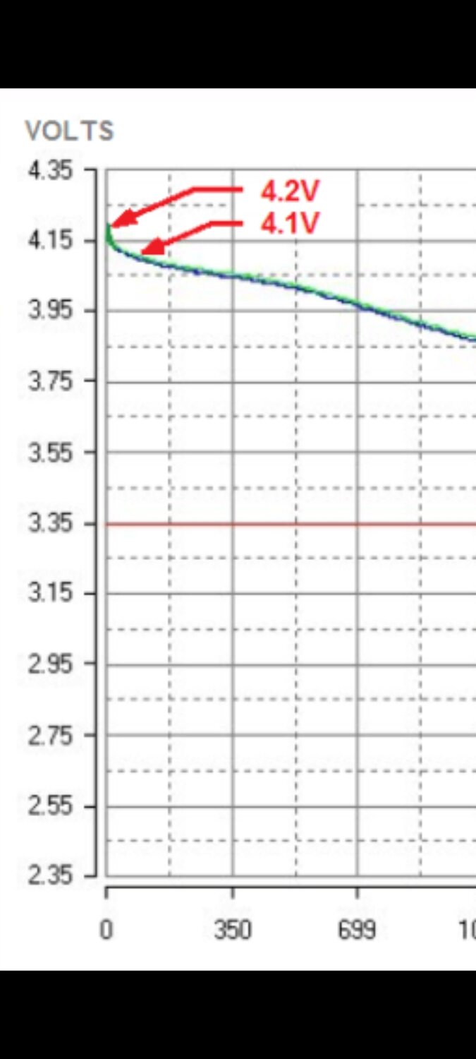

This is the discharge graph for a Lithium cell,.
That first 0.1 volt drop from 4.2-4.1 volt is really fast (steep drop-off).
My 48 volt battery "has 14 cell groups in series, so that's 1.4 volts total."
EDIT: My battery has 13 cell groups, so 1.3 volts
Since fully charging a 48 volt battery to 54.6 is kinda hard on the battery anyway, and since there's very little energy in that last 1.3 volt, I've decided to only charge my batteries to 53.3 volts, and wait for the current to drop to zero while charging.

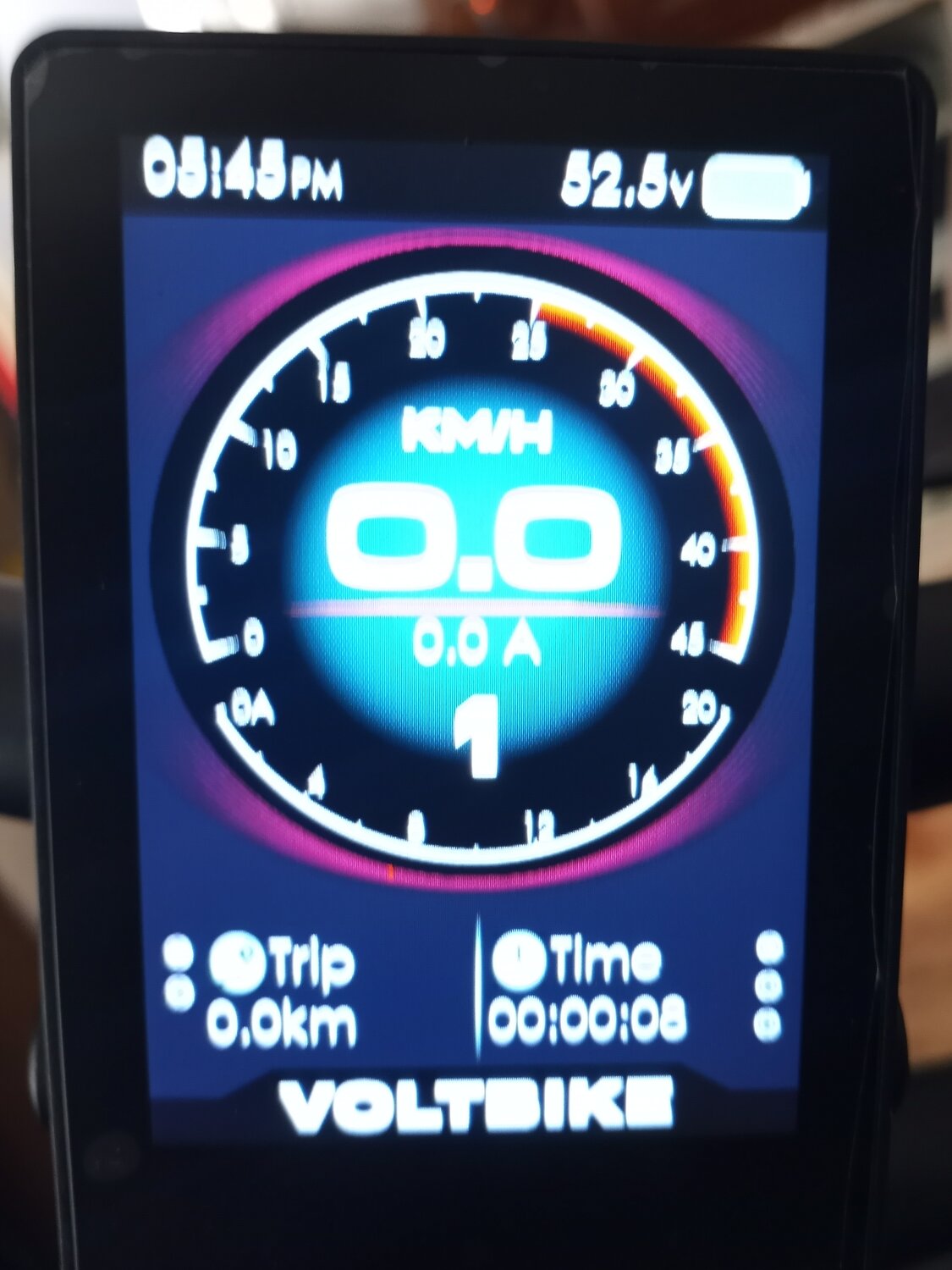

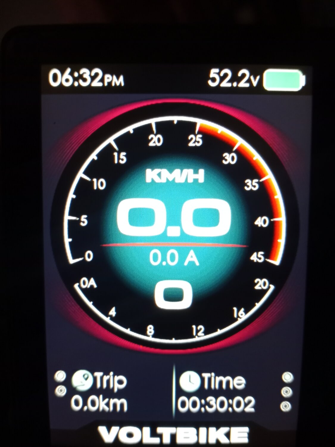

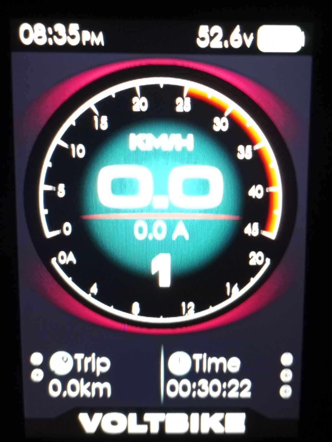

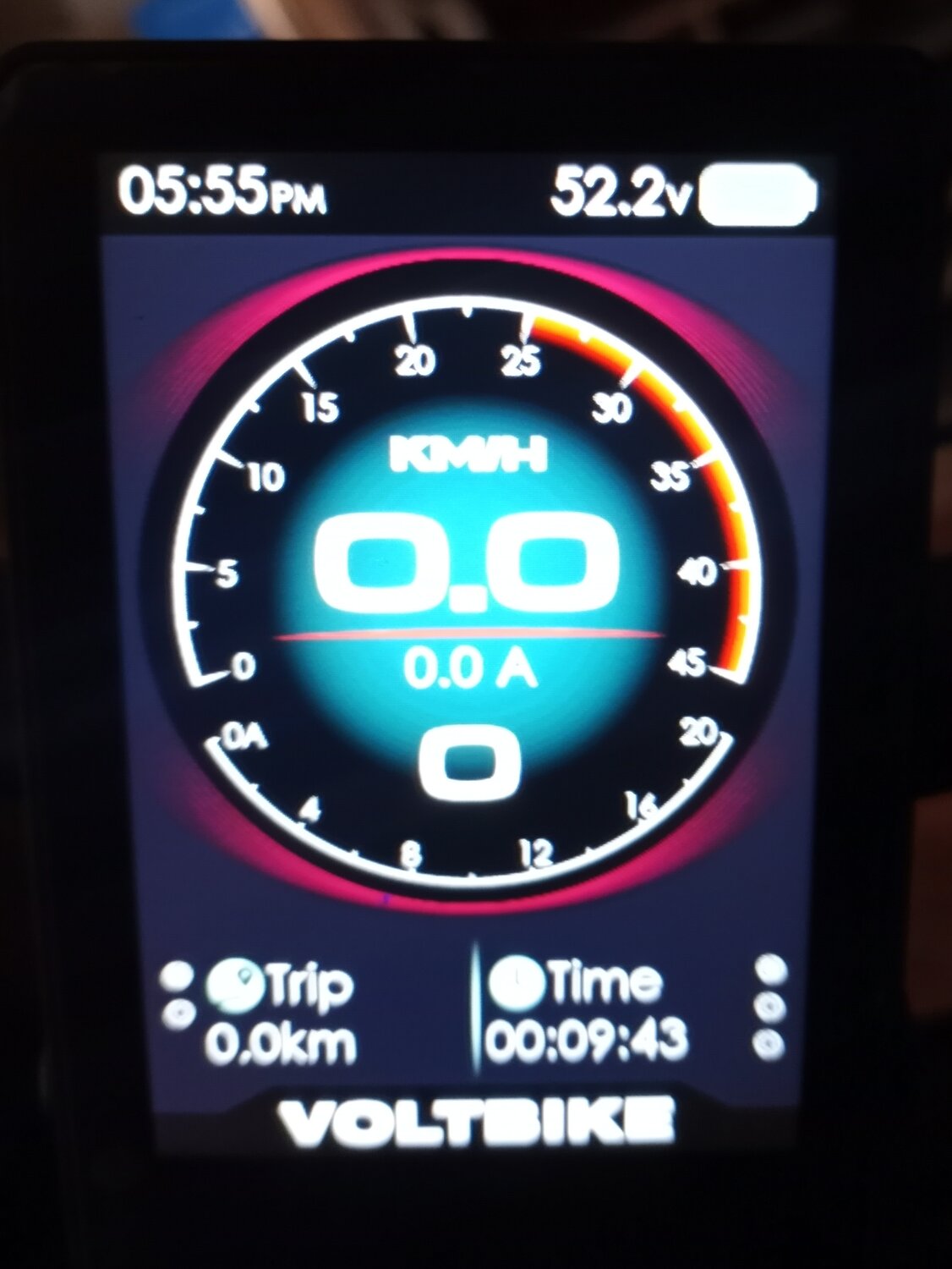

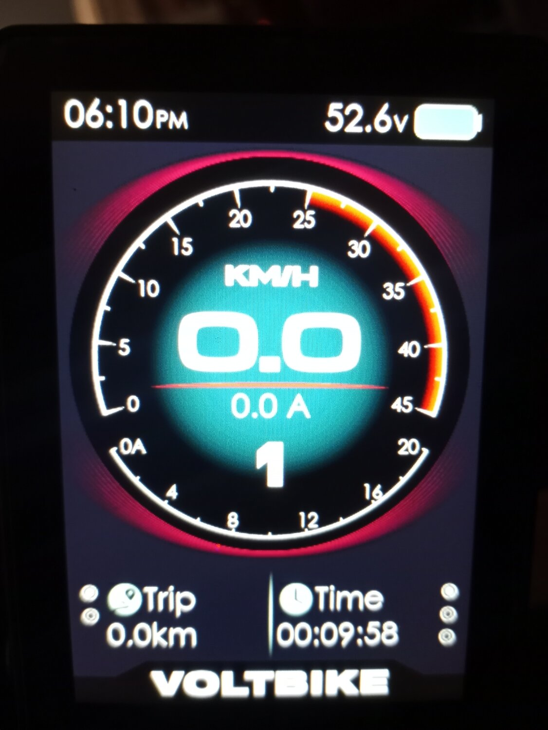

I had the battery fully charged to 52.6 volts, so I thought I would do the test again.
(I had to reset the timer and the voltage dropped to 52.5 before I could take the picture.)
Left the power on and let it sit for 10 minutes,..
Shut it off for fifteen more minutes then turned it back on,..
After 43 minutes the voltage was down to 52.2 volts.
And a complete recovery two hours later..
So my results are inconclusive. 😂
I did lose 0.5 volts starting from 54.6 volts, and 0.4 volts starting from 52.6 volts though.
But it's all kind of erroneous.
Maybe I'll I'll install my Watt Hour Meter this winter so I can monitor my batteries more accurately?
I'm sure that there's nothing wrong with my batteries. They all behave the same way.

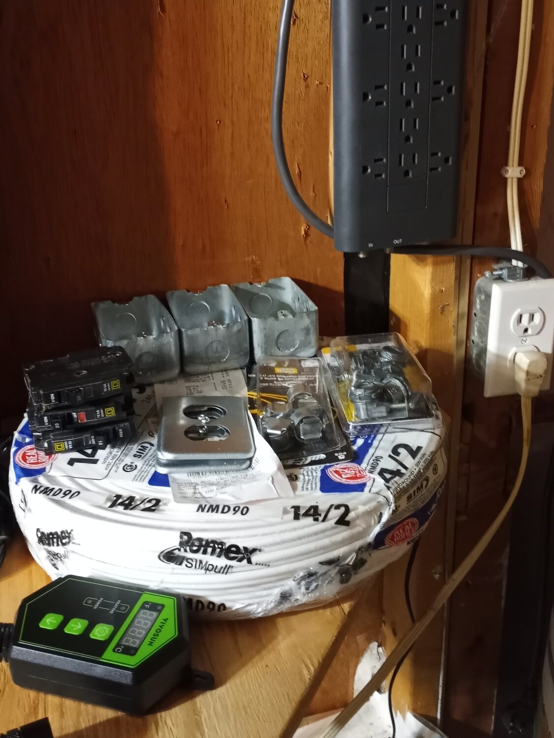

I'm guessin you have no trouble replacing a breaker at your breaker box?
