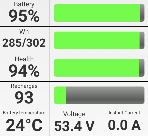

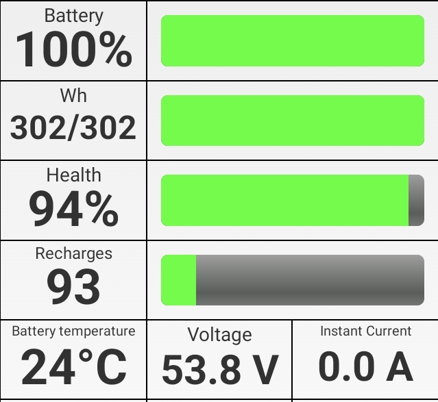

I have run my Vado SL in four 15-minute sessions from 8:55 to 10:03 my time. I was recording the battery state with BLEvo.
Initial state: 100% battery, voltage 53.8 V at 8:55 am.
The system detected no battery consumption in %, only the voltage dropped down to 53.4 V.
After he session, I switched my Vado off and let it be for the next 2 hours, so the system could properly update itself.
Final state after 1 hour of the e-bike running idle and over two hours after being switched off. 17 Wh consumed (5.6%).
Therefore, I admit you have been right and correct. (Not that the battery use for lighting would be a concern for me).
