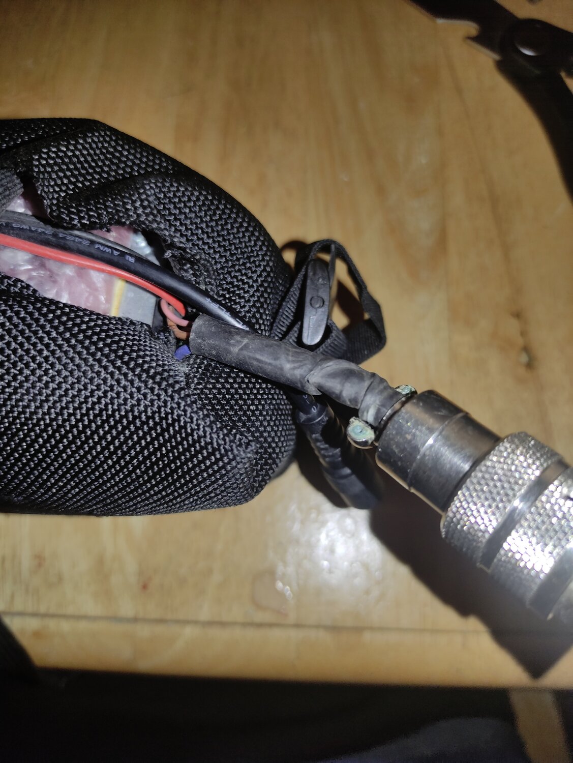

I'm gonna buy this new battery and I am scared I wont be able to connect it to my motor because the connection types are different. How would I be able to connect the new battery to my controller? Why does the "canon charging connector" look so weird? I have no clue how I would connect this to my motor and connector. in the picture of my battery, you can see the black and red wires which go back and connect to the on/off switch that is on my battery. And you can see the charging port on mine as well. as you can see in the file called "qzf battery4" it shows two different charging cord types?? this is so confusing. someone help please, im so anxious about all this

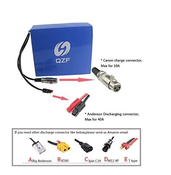

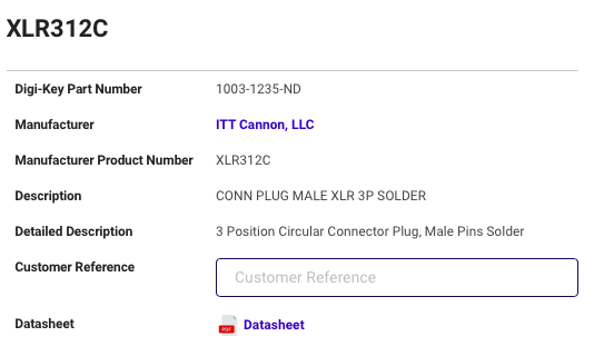

The "canon connector" is a complete lie. Canon has been out of the connector business for about 30 years. (no connection to the camara company). That is a generic XLR connector. You can buy real XLR connectors at newark & digikey. I just made a charger adapter out of one for my bike. At $6.50 the connector was half the price of the 2 amp charger.

A bit of clarification regarding connectors:
The XLR connector was invented by James H. Cannon, founder of Cannon Electric in Los Angeles, California (now part of ITT Corporation), and for this reason it was sometimes colloquially known as a Cannon plug or Cannon connector.
Note it's a "Cannon" connector, and isn't designed for power use. Worse, the seller doesn't even know how to properly spell the word!

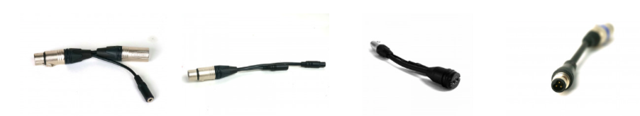

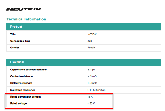

You're both wrong ebikes.ca has been using XLR connectors for many years now. I have adapters for 4 different charge connectors from Grin.
XLR​
XLR
The XLR plug has been used in audio equipment for decades and is available in various pin configurations. In the ebike scene it's been used on battery chargers since as long as we've been doing this (2003). Back then we were mostly dealing with NiMH and NiCad batteries which require a temperature sensor for charging, and so a 3-pin XLR plug was used, with Pin 1 = V+, Pin 2 = Gnd, and Pin 3 = Thermistor. This same 3-pin configuration is also used with lithium and lead acid batteries that don't require a temperature sensor, and in that case the 3rd pin is either not connected or used as an interlock pin.
Generic quality XLR plugs don't have very good current handling for their size, and will often melt and distort when used above 4 amps or so. Higher quality XLR plugs like the Neutrik XX brand that we use on the Satiator are rated for 16 amps, which makes it an excellent choice for high current charging.
