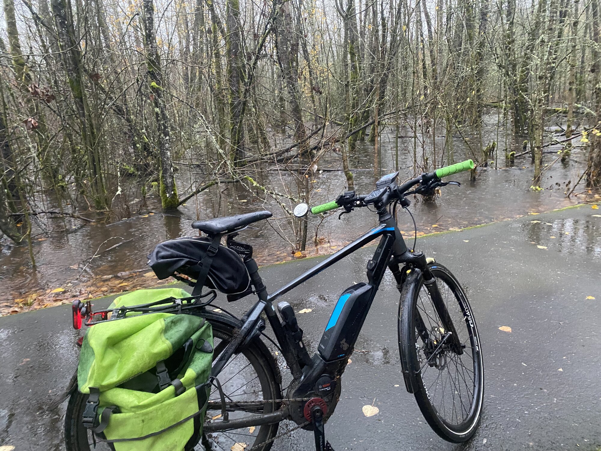

I have been riding the following e-bikes under the most unfavourable conditions, often riding through puddles so deep these covered the mid-drive motor:
  • Lovelec, a generic Czech hybrid, hub-drive motor e-bike
  • Specialized Vado 5.0
  • Specialized Vado SL 4.0
  • Giant Trance E+ 2 Pro.
All these ebikes turned out to be totally waterproof. The only glitch was Giant RideControl EVO display that was damaged, and not by rain but by power-washing (by another person).

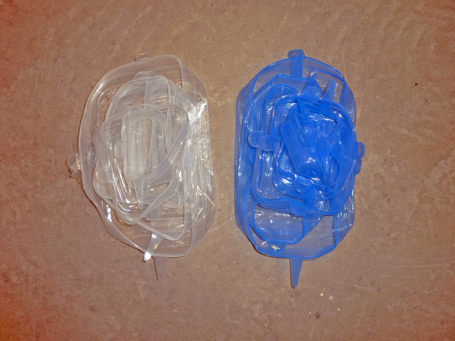

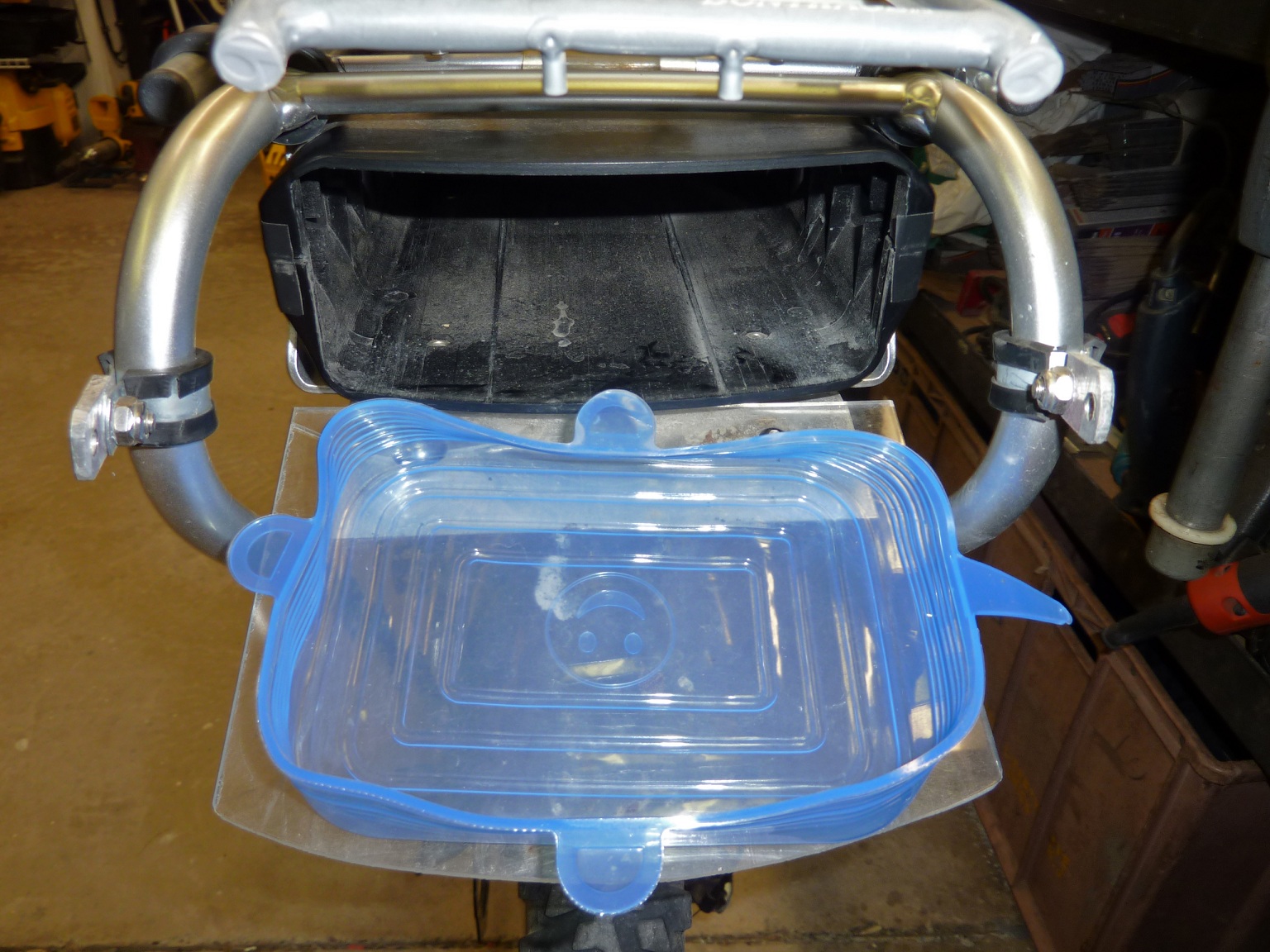

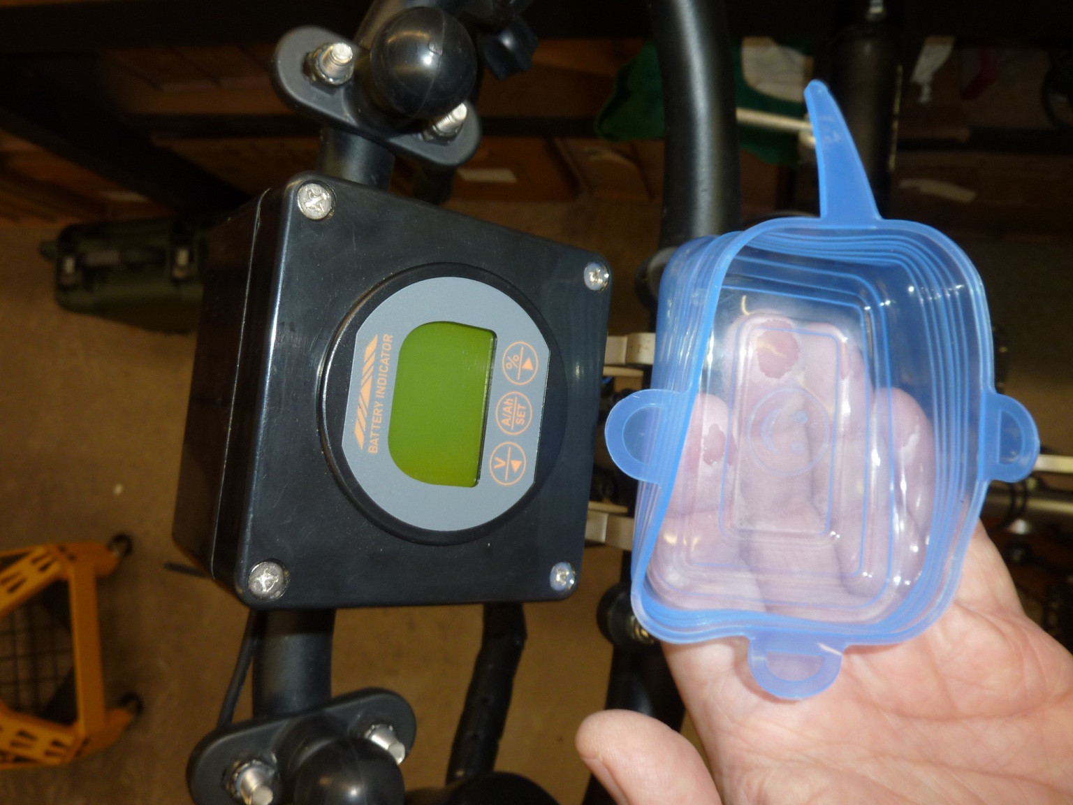

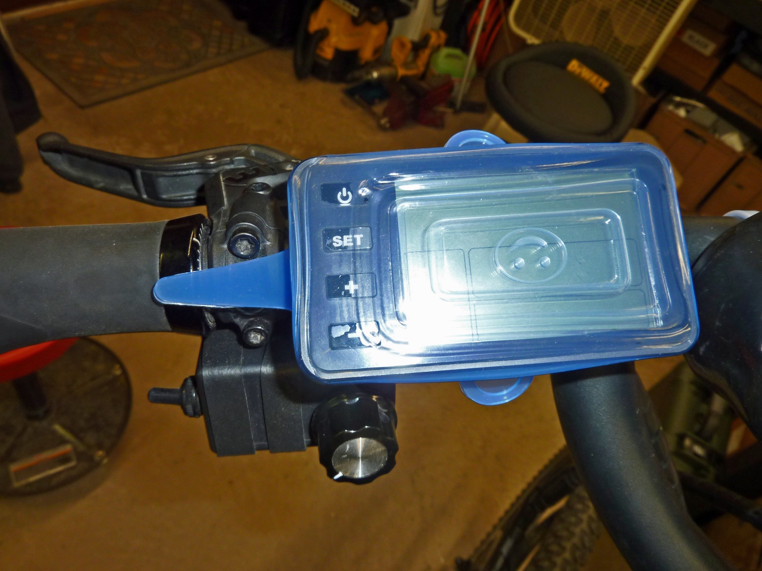

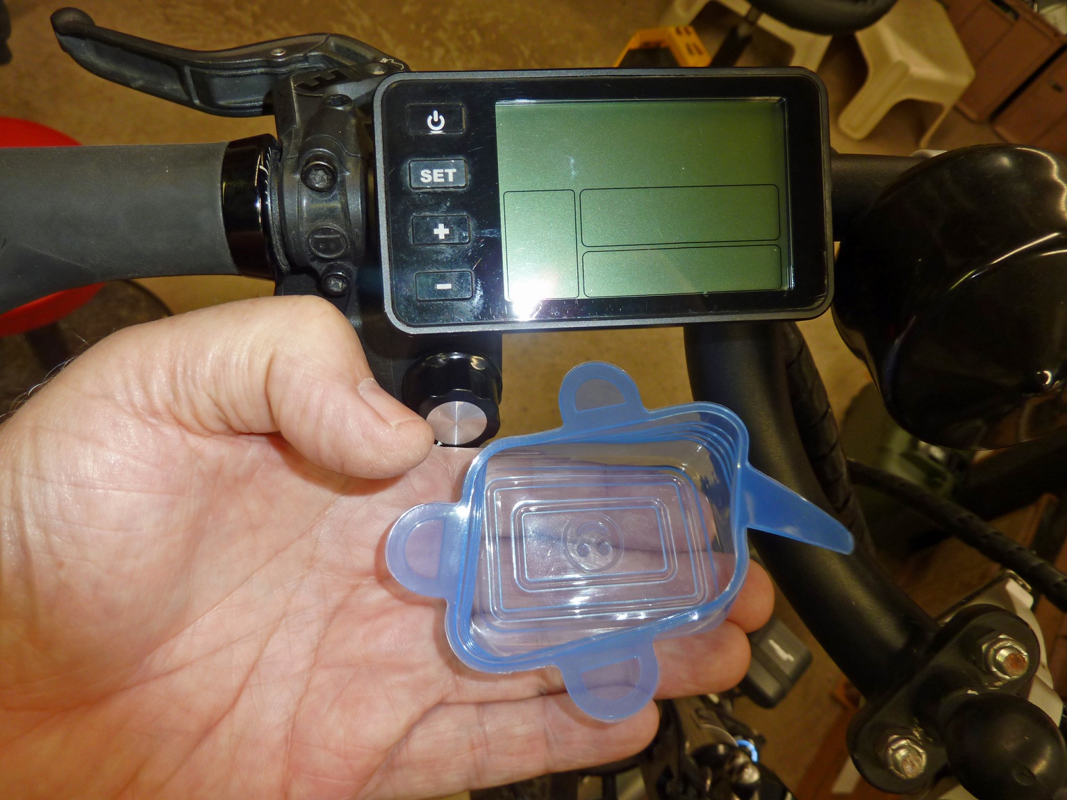

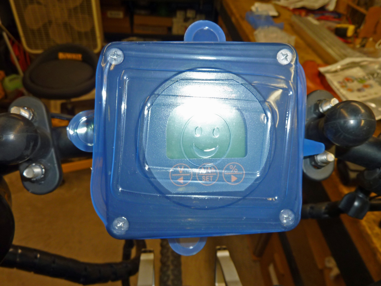

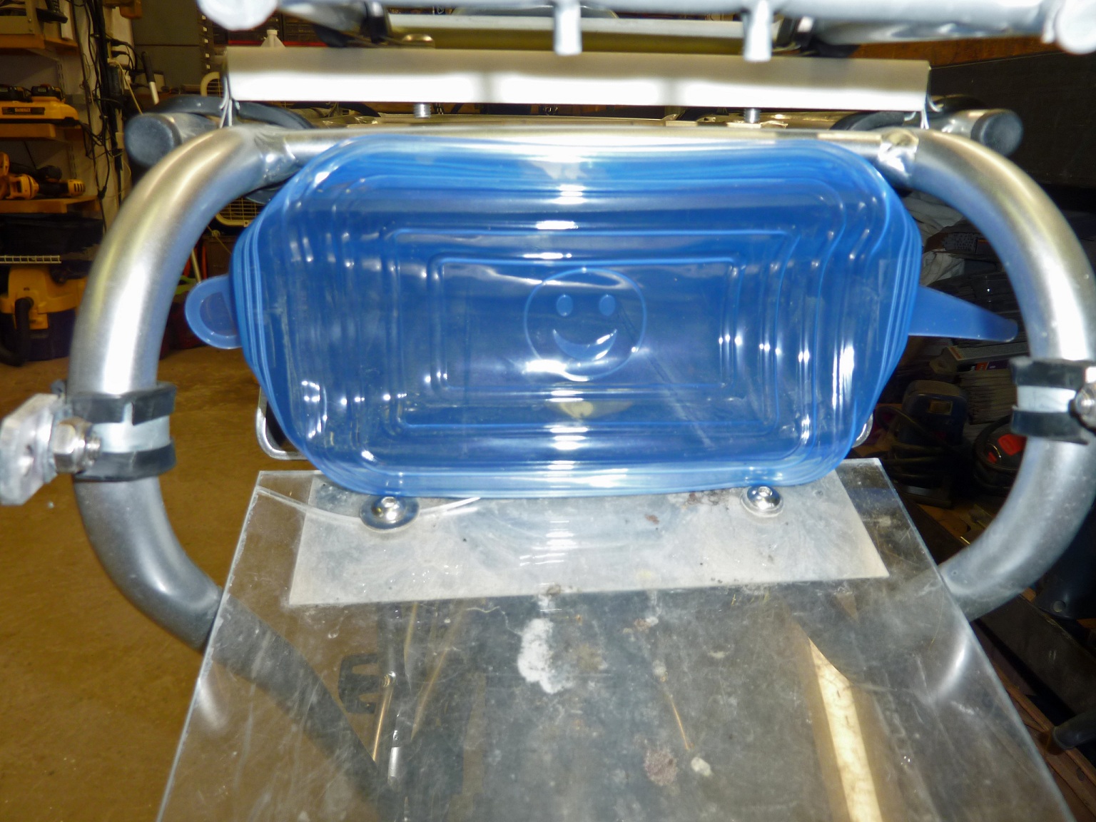

Although the bike is fairly weatherproof, I do take some precautions when riding in wet weather. I cover sensitive components with these silicone caps:
They're reusable, transparent and flexible enough to be able to operate display buttons.

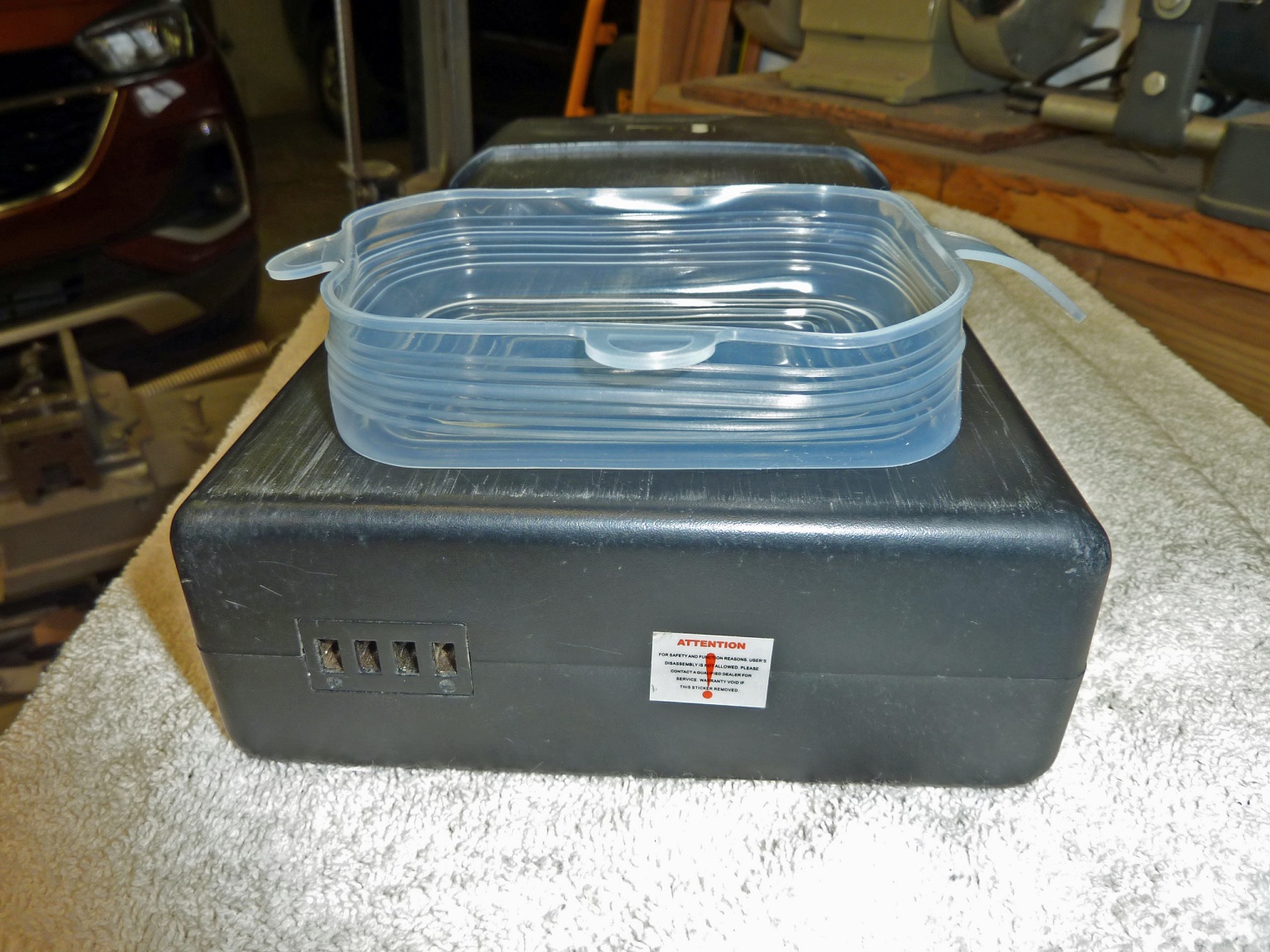

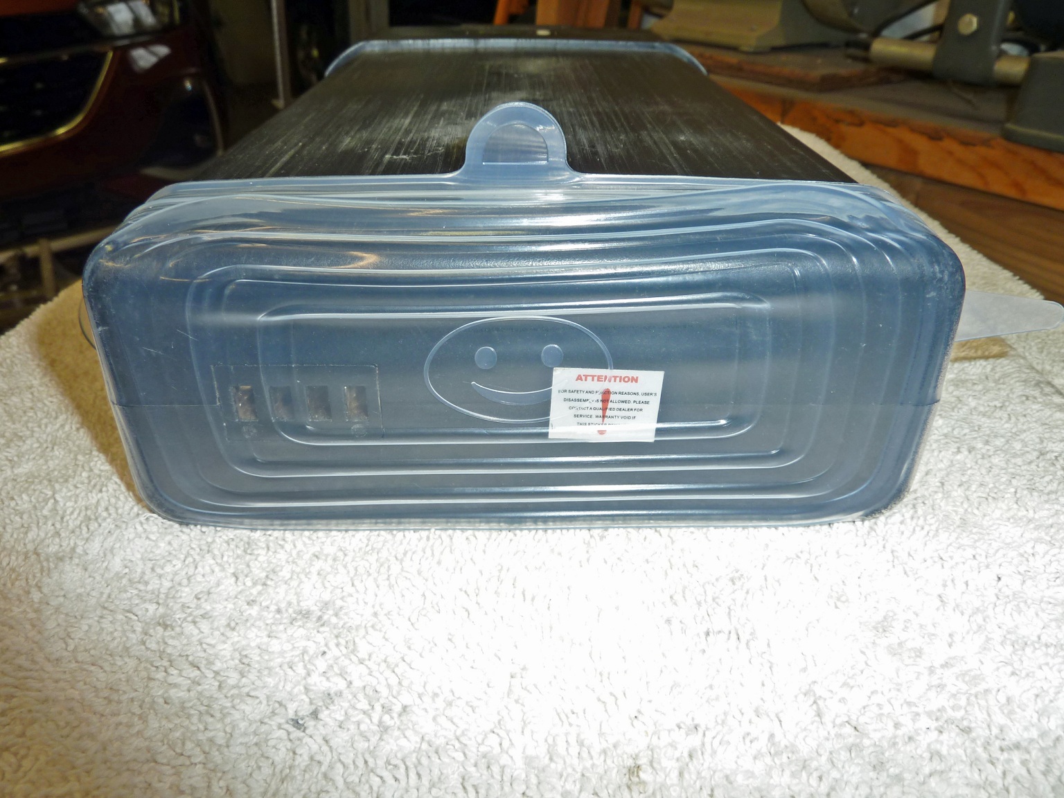

During transport, I also use them to cover the opening in the battery case:

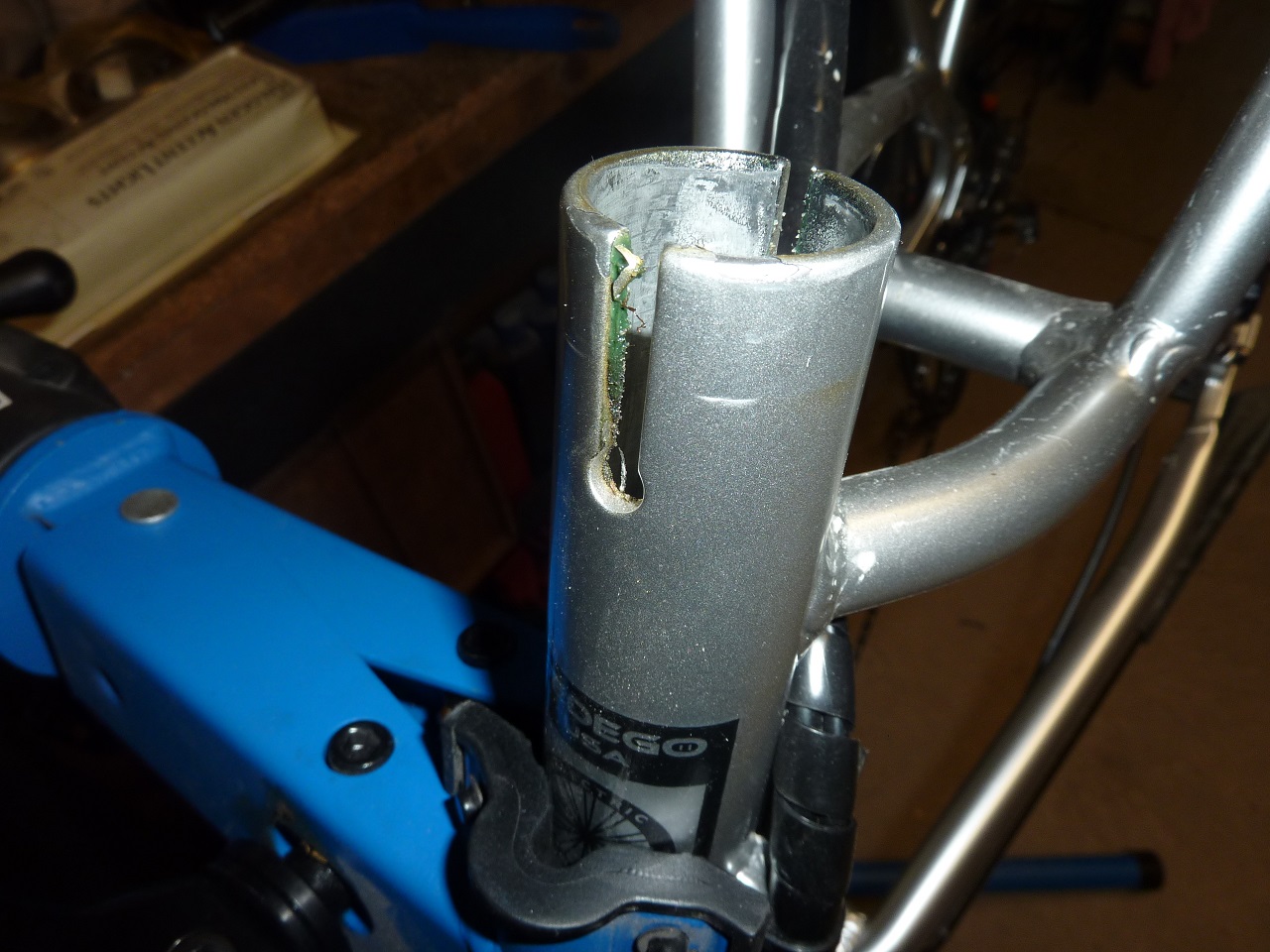

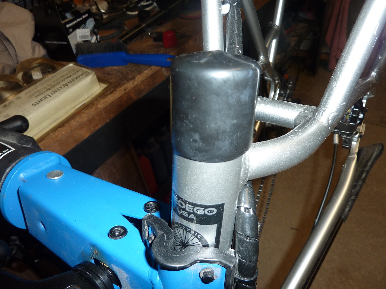

I use these additional precautions when transporting. I remove the seat & suspension seatpost and cover the top of the seat tube with a vinyl cap:

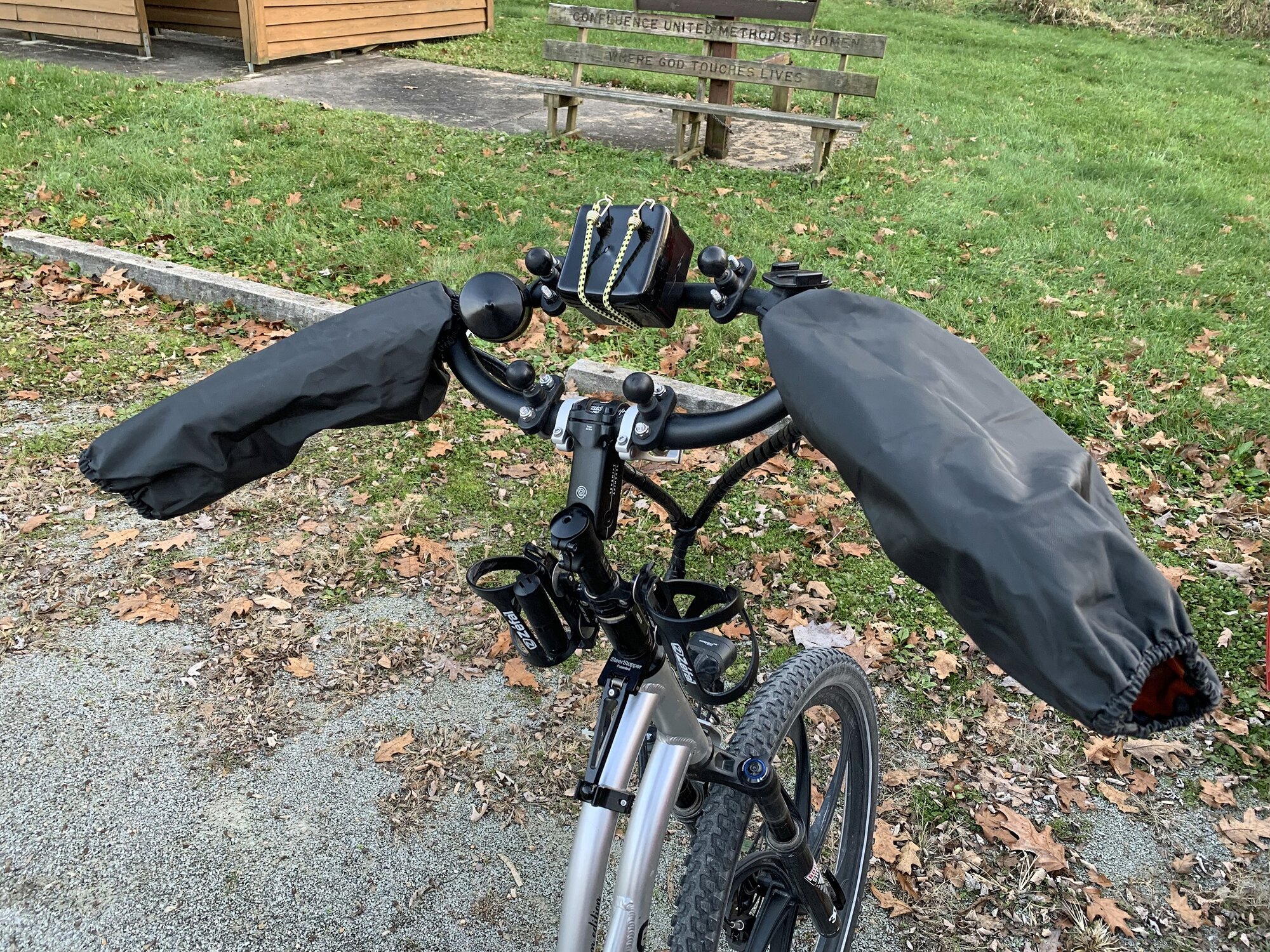

And cover the bar ends with these waterproof arm protective sleeves:

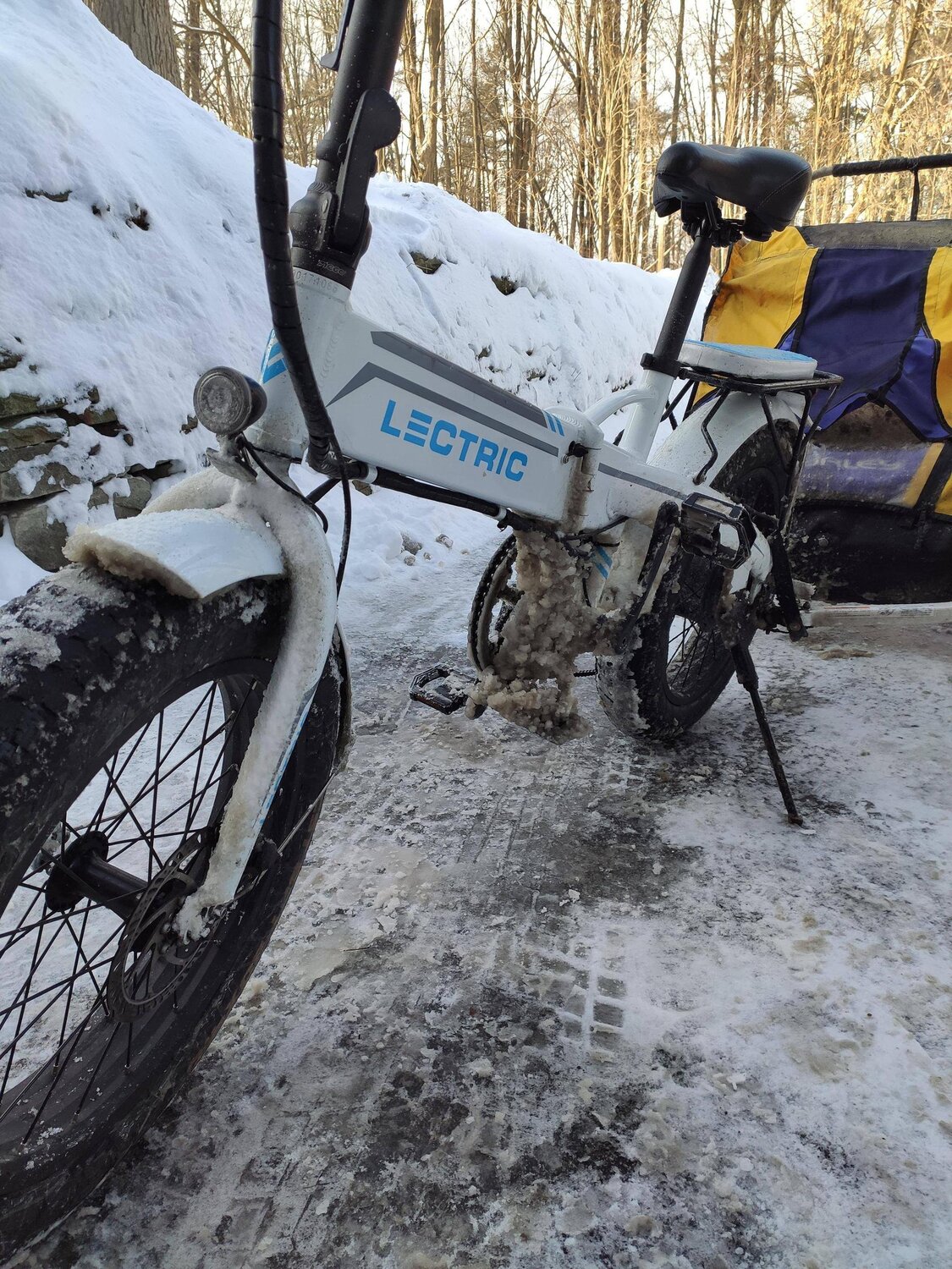

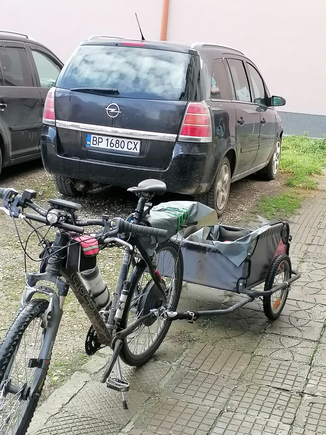

I got wet once in the rain. Since I did everything in a hurry and with limited funds, the battery and controller got wet because they are on the trunk. After a while, the BMS refused to charge the battery. After replacing it, everything was fine. Now I have wrapped the battery and controller with nylon. It's ugly, but it works. I'm getting wet snow soon and everything works.
