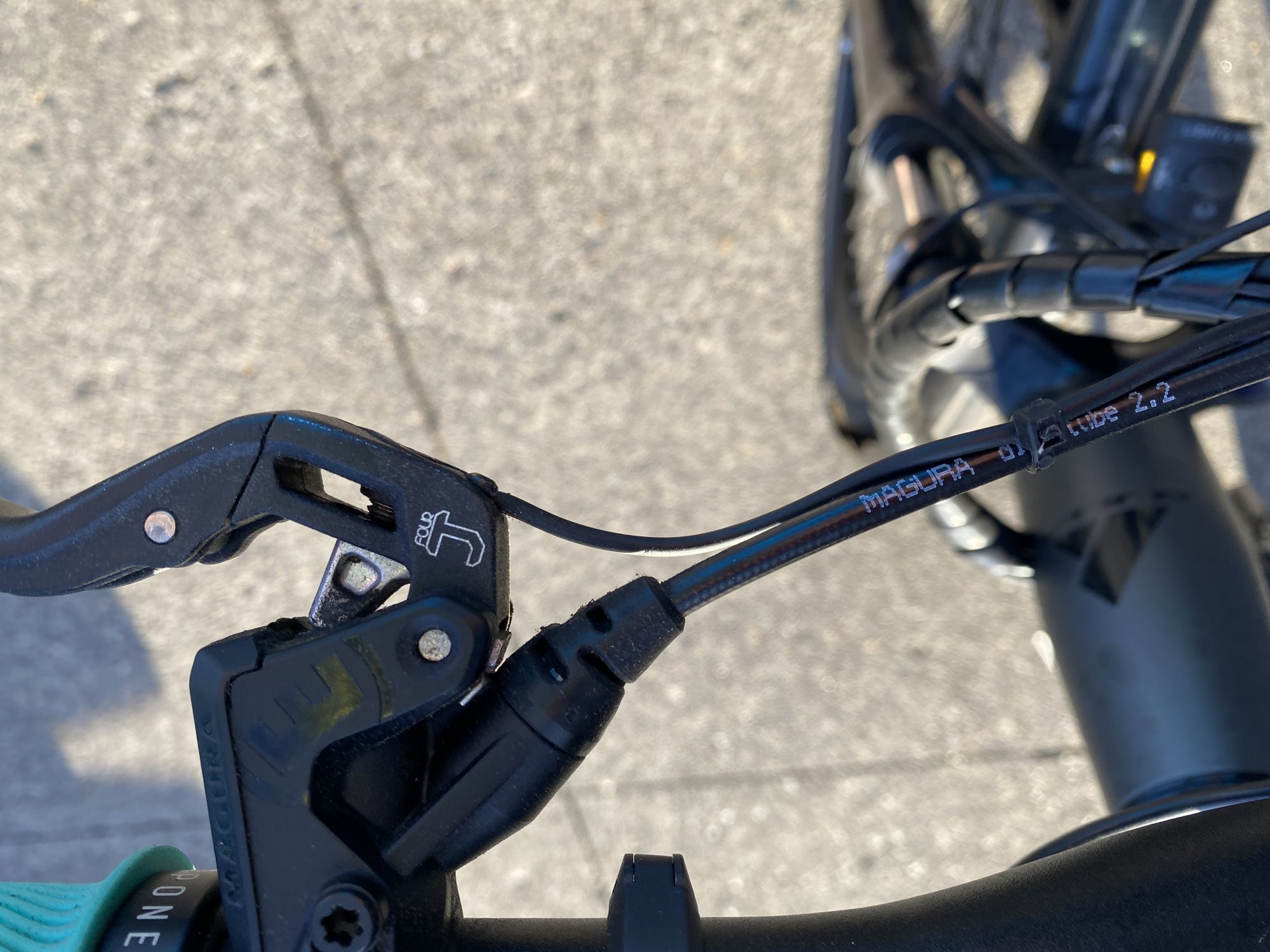

My magura have wires and they are in use on my bike but our tandem does not the pics are on my performance speed bike and the tandem had the performance motor

I’m confused. Your bike with the Magura brakes is a mid-drive? If so, is it a class 2 with a Bafang mid-drive?
no bosch permanence speed with matura e brakes with the wire. our tandem is a performance without the wires. but I thought it had them but after the brake change and looking no brake wires.
Are you saying that on one of your bikes the brake wires are wired into the Bosch system? If so, that’s a new one for me....or maybe they’re wired into a brake light??.
you know that can be it has a brake light. but I messed the wire up when a strap got caught in the back fender. the shop was talking about having to run new wires from the front of the bike. but thats why I thought the tandem had them too.
That makes much more sense!
