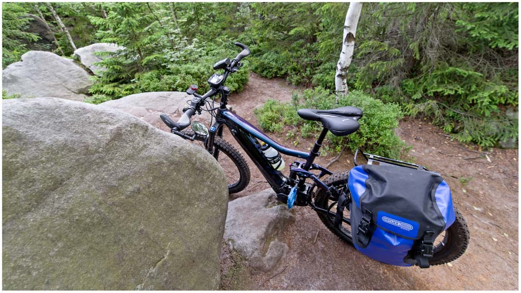

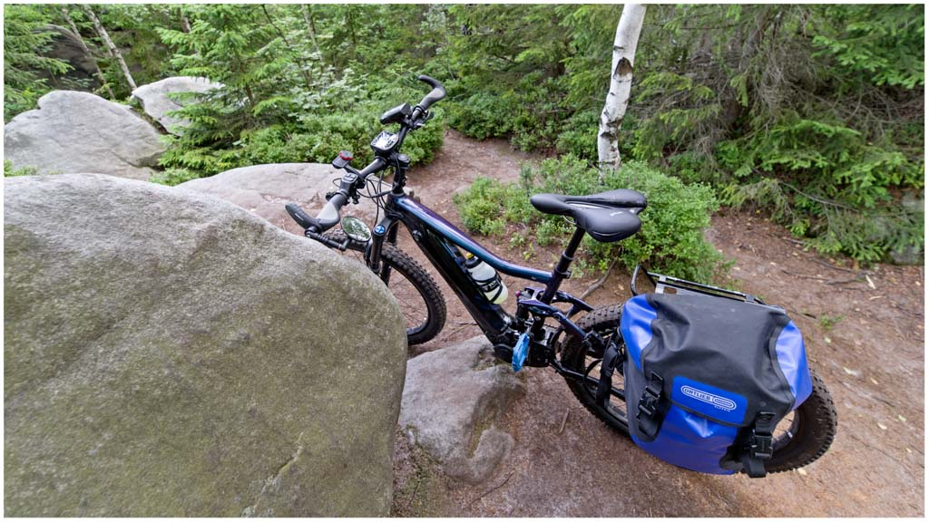

Use Ortlieb Bike-Packer pannier with Ortlieb Commuter Insert. Proven for heavy batteries up to 18" long. The Bike-Packer is sold in pairs. A Commuter Inserts is sold apiece. The Inserts (one piece despite of the name) is placed at the bottom of the pannier to protect it against being torn by the battery.
I carry Vado and Trance E+ batteries as shown. The Trance E+ battery is 18" long.
