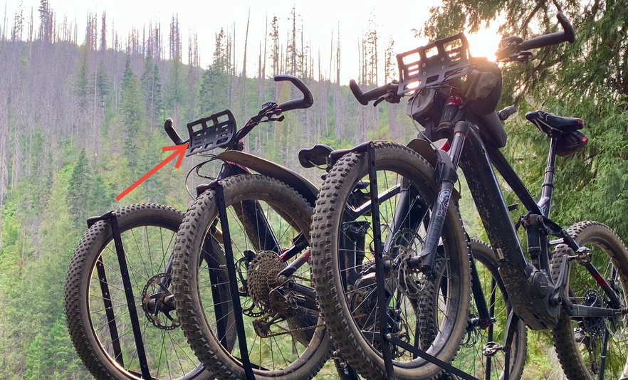

UPDATE: I've got the Topeak Midloader (L) set up on the bike and it's great. I'm somewhat concerned with the zipper failing while on the road but I'll deal with that as I go. The point is, for me, the idea works well. I'll be taking this setup out for a 100 km plus ride in the next few weeks and will report back with my findings / observations. Since the midloader isn't 100% waterproof I'll be putting the spare battery in a 8L ultralight dry bag that will serve to keep out any water and dirt. There's additional room in the Midloader as well which is nice 👍.

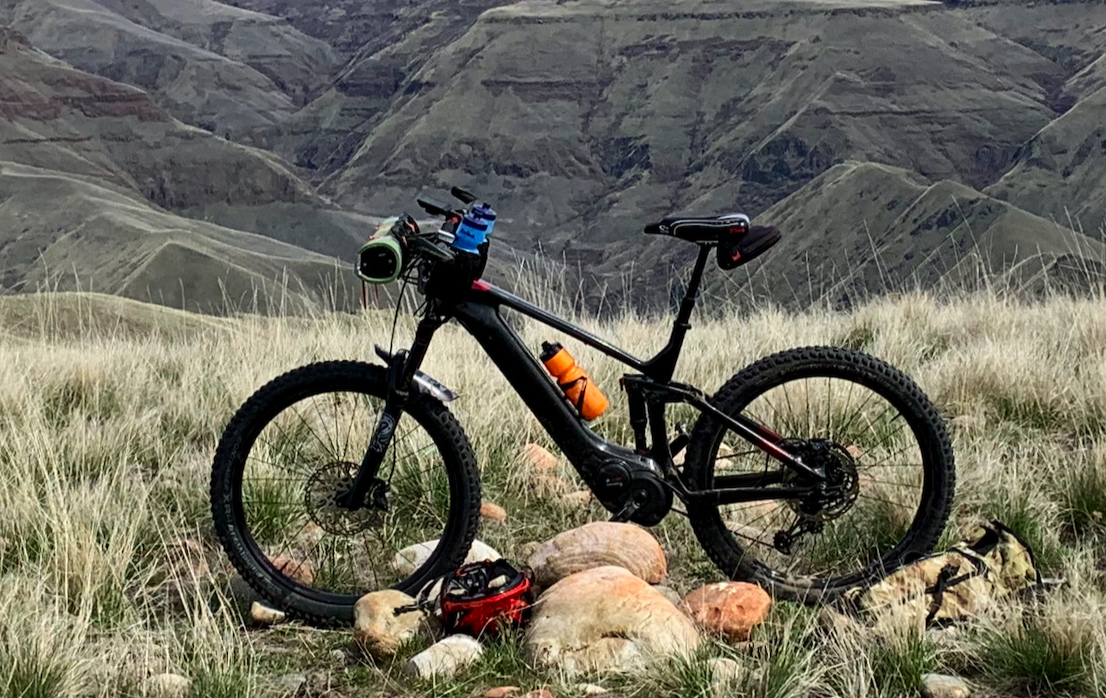

Spare fits snugly on the shelf mounted under the top of the rear rack. It also serves as a fender.
