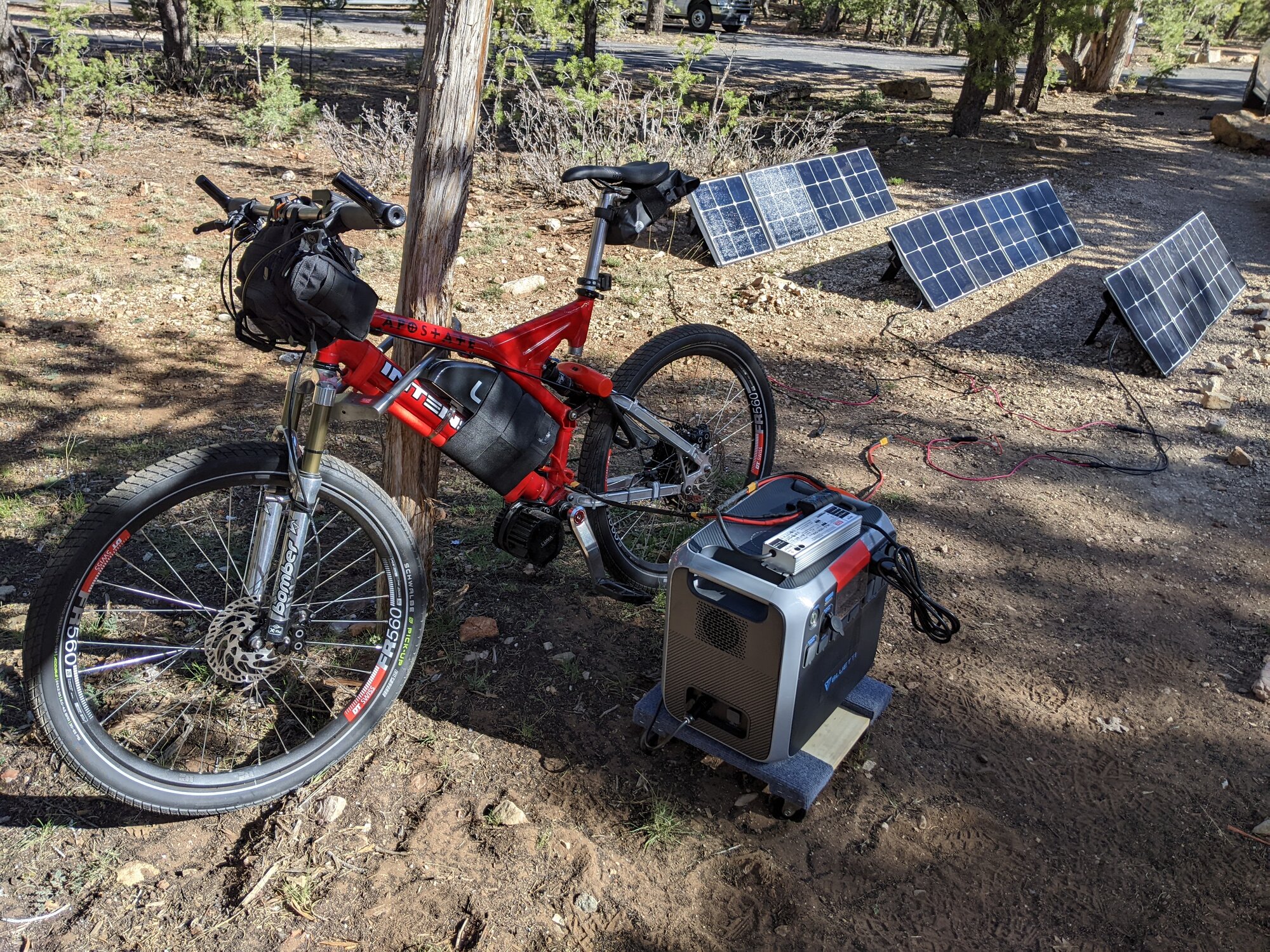

Well, I don't do straight-pull spokes. For 26" rims, I've got two go-to's. The budget alternative is the SunRingle MTX39. About $70-$90 depending on what the seller wants on any given day. These rims go from being totally unobtainable to widely available. Depends on when the shipping containers arrive I guess. $63 for 32H and $76 for 36H right now on Amazon.
Next up for rims are the DT Swiss FR560. They are as-indestructible as the MTX39, but maybe half the weight. About $40 more per rim. I used them on these wheels (picture below) last Spring, and I have another waiting for my Bullitt that I'm trying to build if the frame ever gets here (both times, I couldn't get MTX39's).
At the core of all my wheels are DT 350 Classic hubs. Mostly due to the ratchet engagement of the rear hub, which will survive all abuse from a 1500w BBSHD. The Hybrid version if I can get it. If not I upgrade the rear cassette body to steel.
That leaves the spokes. I've done a variety. DT Champs are relatively (relatively!) inexpensive and just about every quality LBS in the USA has various lengths in the shop in a drawer somewhere. I've also done DT Alpines - on my Envoy cargo bike, which also had MTX39's. Costwise those are prohibitive. For the 26" wheelsets on the Apostate pictured below, and the upcoming Bullitt, I have used Sapim Strongs and they are every bit as good if not better than a DT Swiss option. NOT the E-Strong which needs a special reducing nipple to fit into a standard rim.
For one of my front Bullitt wheels, I used 12g Sapim Leaders. That was an experiment and a mistake. Too much of a good thing. Horrifying to build but its the rare wheel thats so strong it *probably* overcomes its inability to flex. For the other I used Sapim Strongs.
For nipples I always choose brass, and longer if possible.
I get my spokes at Stoic Wheels. Google that for his site. He had spokes in stock throughout the pandemic which was pretty much a miracle as I tried a LOT of formerly good sources before I struck out and then found him.
