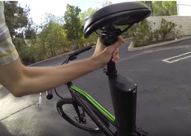

Is it this battery? Being Held by the owner of this website.

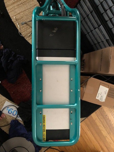

I guess you cannot support the seat without the battery in place? If you could, it would be easiest to buy a downtube battery and clamp it to the frame. If the cells are easily removed from that case, you might entertain that alternative,

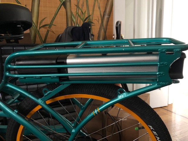

naw its this bikehttps://www.rei.com/product/852082/izip-izip-e3-zuma-lsf-bike-2013 with a horizontal rack mounted 36v battery (so likely 10 groups of 6).

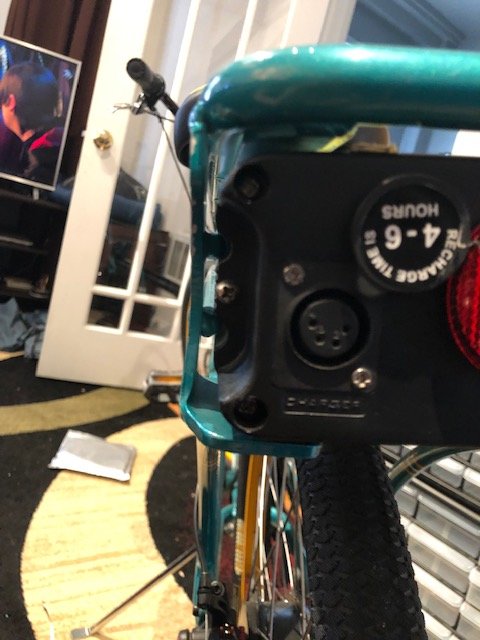

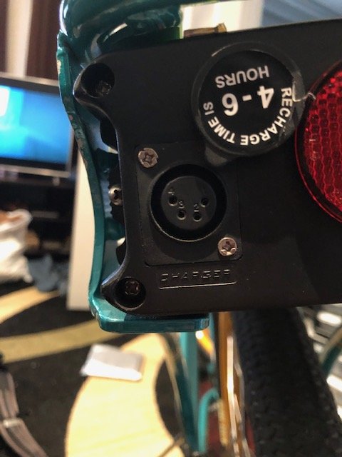

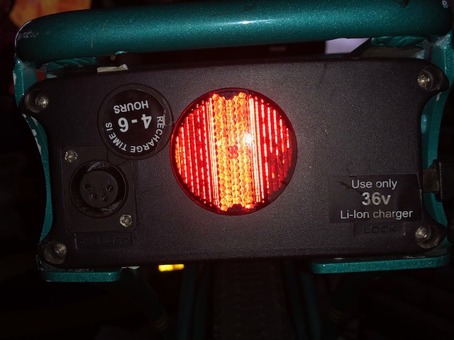

Yep thats the battery. The i busted out my calipers and got ~ 155mm x 73mm for width and height (cant find my bloody tape measure for the length). The case of the battery has these little slots in the side (tried to get it shown in the photos, but came out poorly). Those slots slip into two welded bars on each side of the batter, which makes the width of the racks bed smaller (~ 148 mm). The connection to the controller is obscured (since they are flush with each other). I havent taken the battery out yet, since its not clear how to remove those little pins on the top without damaging them. The charge connector is a 4 pin XLR
I did have a bit of price shock initially. Mostly because i had bought cheap batteries in the past, so it seemed like the price was way more than materials. But i had bought crappy bats whose capacity was suspect. "good" cells tend to be at least 3 or 4 bucks in bulk, which already puts it in that 300$ price range. So yeah now my expectations are properly aligned with reality :).

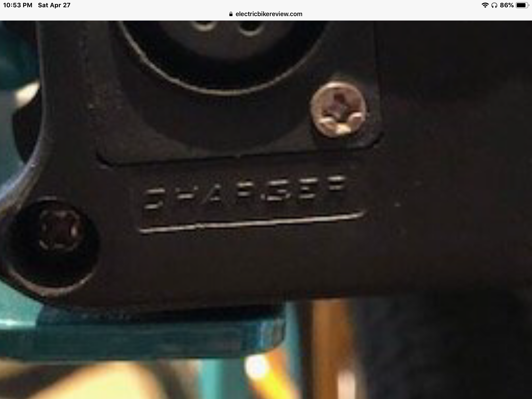

What is the name in the plastic? Lower res picture and old eyes keep me from reading...
EDIT, oops it says charger. Any other markings?
I’d bet the case is either from http://en.kssssj.cn/index.html?fbclid=IwAR0UmRTdCNA_1Q9P_gol5DCs5m06QBWqYgdcOutW2LXxMWvEfGTY-K9j1Ms
Or, http://www.reention.com/
Once identified there are a number of good sources direct from China. Sources I’ve known to be reliable. When ordering a battery I ALWAYS INSIST ON A SPARE BMS. They are cheap and the most common failure.
I paid $12 for the last spare.
