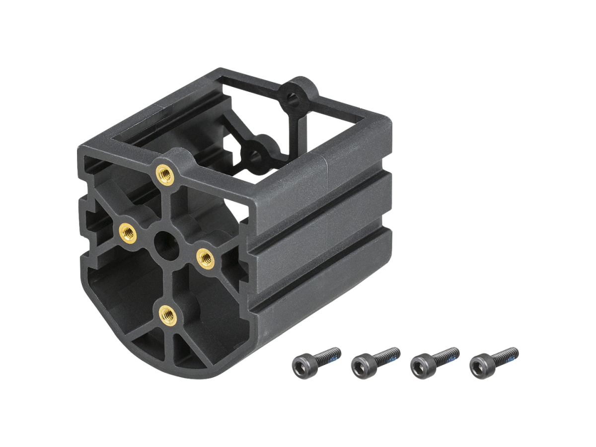

While it is true that the 500Wh battery is shorter than the 625Wh battery, the battery space in the down tube of the frame is the same. Therefore Dallant's statement is correct.
The frame (not including the fork or paint) is essentially identical between the Allant+ 7 and the 8 (and 7s and 8s). Both models can accept either the 500Wh or the 625Wh powertube battery. The difference is that to install the 500Wh battery as in the 7 and 7s (also the 8 with the PL CX motor, but not including the 8s with the PL Speed motor), one must also install the following battery spacer to fill in the gap that would be otherwise be filled by the longer 625Wh battery:
You beat me to it. The 500 needs the spacer
(just behind the battery handle), the 625 does not. AFIK, there are no othe issues with using a 625 with the PLCX motor or the Allant +7.
You beat me to it. The 500 needs the spacer View attachment 61776(just behind the battery handle), the 625 does not. AFIK, there are no othe issues with using a 625 with the PLCX motor or the Allant +7.
