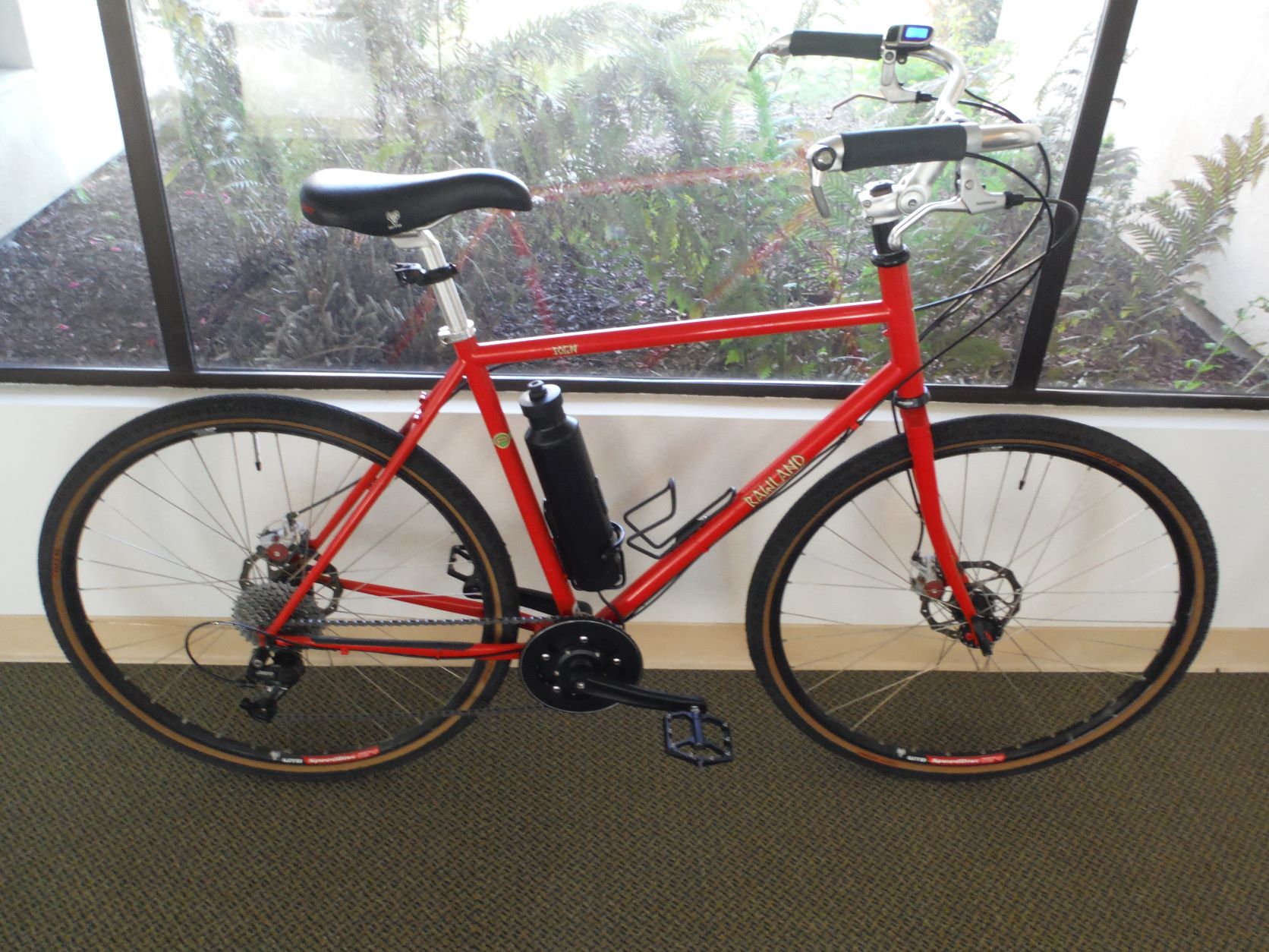

That is right sit, on bikes and ride them. Here is an XL that I made electric yesterday that does not look too ugly. It is easy enough to install a stem riser with longer housings, like on this bike. Electrical can usually be rerouted to accommodate.

True statement there! Many times they can be re routed, but worst case is the offending cable must be replaced. That's just not that big a deal!
It is a little untidy but you can also extend an existing housing. Just do the extensions down low to keep the HB clean.
