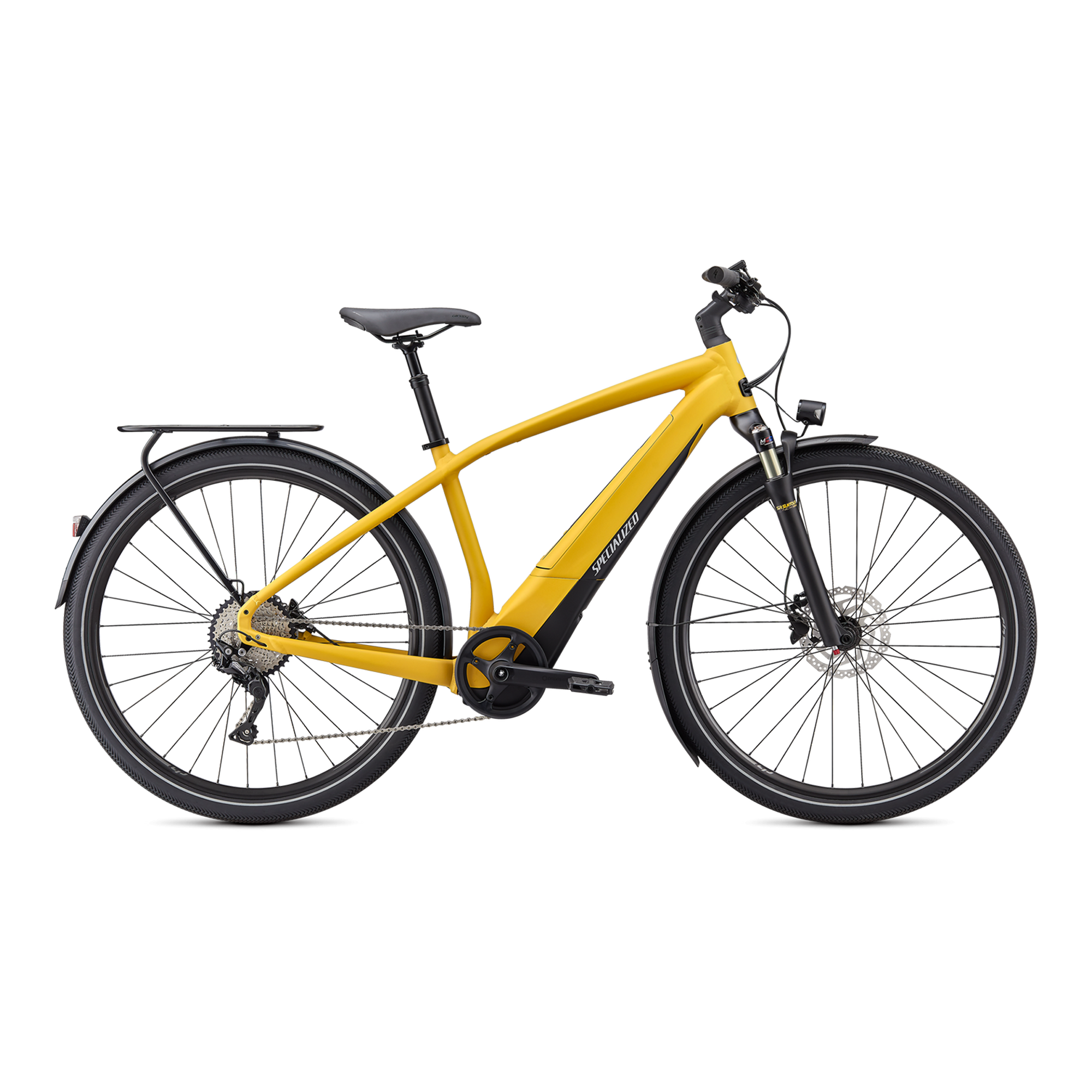

If you could consider stretching your budget, then you could think of looking at the Holy Grail of the Class 3 e-bikes, which is the Specialized Turbo Vado 5.0 ($4350). (I don't want to elaborate on the 4.0 for the simple reason those are sold out in the U.S.) The Vado 5.0 is equipped with the silent Specialized 1.3 motor (Brose S) of 90 Nm and peak power of 520 W (400% support, Giant is 360%), a 600 Wh battery and top-notch components such as drive-train and brakes. The latest TCD-W display is just fantastic and poses no connectivity issues. And the Vado looks like a Ferrari.
Remember: "Money spent are forgotten soon but nothing can wipe the big grin from your face" :) I'm riding a 2020 upgraded 2017 Vado 5.0 so I should know it better ;)

I think Enzo would be riding Turbo Vado were he among the living :D
P.S. The 4.0 is a good e-bike but it has some features that put it a little behind the 5.0:
  1. The 1.2 motor vs the 1.3;
  2. The 500 Wh battery vs the 600 Wh;
  3. The 40T chainring vs the 48T.
Other differences are less significant though I might mention better drive-train and brakes in the 5.0. The 4.0 sold out because apart from being a very good and beautiful e-bike, Specialized had the "double-rebate" action back in May in the U.S. and the model sold out like freshly baked buns...
P.S.2. The Turbo Vado 4.0 LTD costs only US$3750, is fully available but not everybody likes the mango colour ;)
