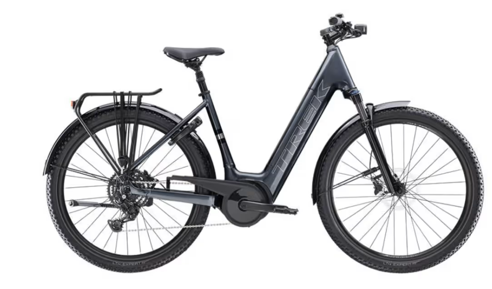

- Trek Verve+ 3 Gen3 ($3600) -
- Trek Verve+ 4s Gen2 ($2000) - another one that is on closeout so significantly reduced price

  • The weakness of Trek Verve+ 4s Gen2 is the e-bike is outdated (Bosch Gen 2) and has a smallish battery. The design is already outdated by several years.
  • Trek Verve+ 3 Gen3 costs that much because it is the latest e-bike with modern components, new e-bike system and a good battery. What is the battery size expressed in Wh on the model you had a look at?
Regarding the 28 mph, please bear in mind no-one guarantees you would ever achieve that speed. Class 3 (28 mph) just means the motor would only cut off at that speed if you ever reached it :) Usually, be glad if you can ride at 20 mph on a Class 3 e-bike; it is because the air drag will limit your top speed.
Please never promise you would limit yourself to short rides. Your appetite for longer rides would grow. That's why your e-bike should have a large battery (expressed in Wh). One of my riding mates, a 65-yo petite female easily makes 50 mile rides on a Bosch equipped e-bike similar to a Trek Verve. She is always returning on the battery (625 Wh). She wouldn't be able to do it on a smallish battery that any of the three e-bikes except the more expensive Verve has.
As Fritz said, you need a dealer nearby so you can choose the right frame size, do a demo ride, and have a post sales support and service. Of all your choices, the Trek Verve+ 3 Gen3 looks the best. Think of purchasing an e-bike as of a new cell phone. Would you buy an old product with buttons? (Electra). Would you buy a smartphone that is several years old only because the price is right?
