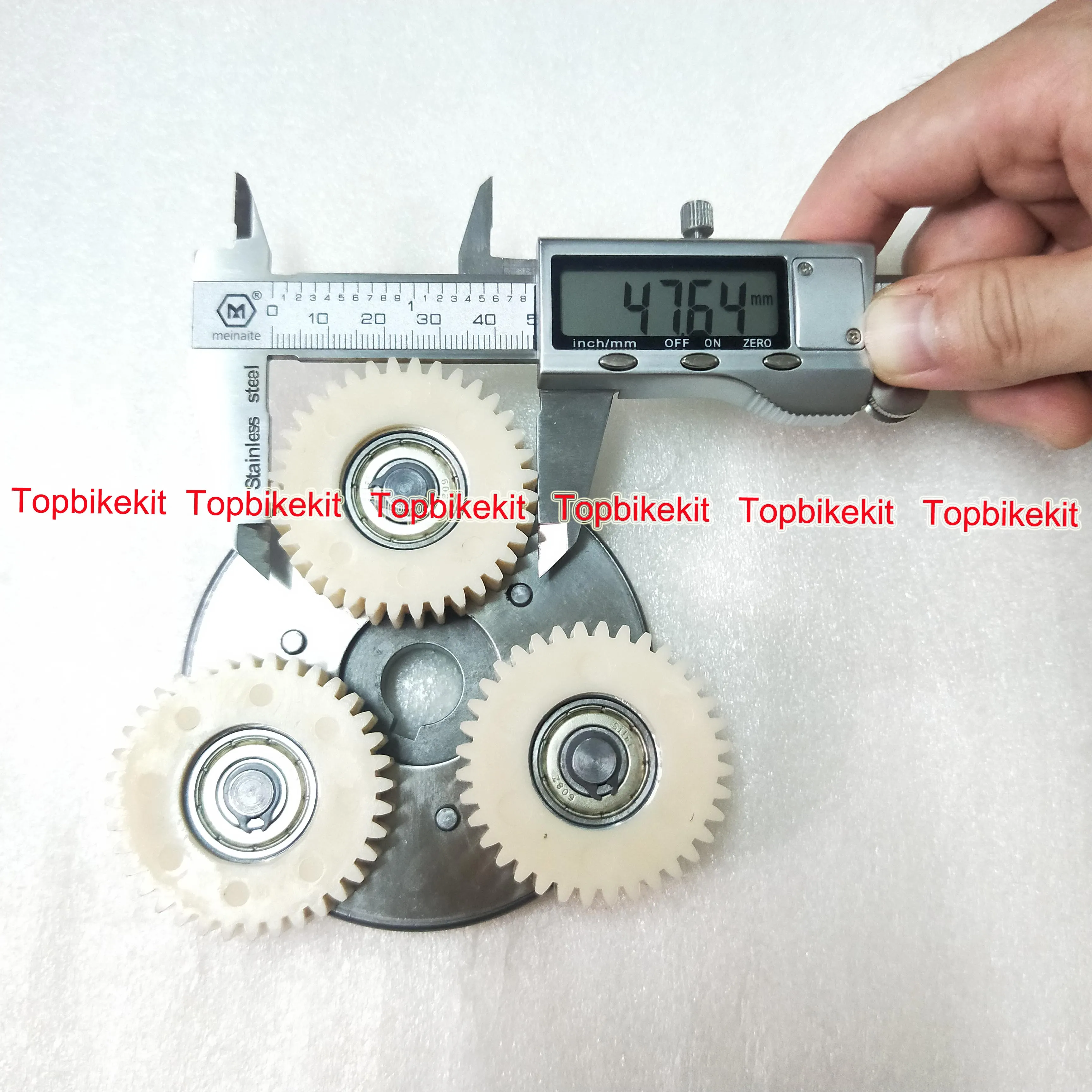

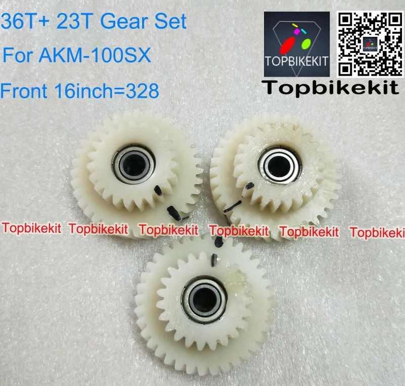

Kuo+ gears for motor/hub. I put something in the parts wanted section also.What parts?
similar to this. but 36/18. i will try to figure out what motor is in there.As you can see, there are different gears, so I think you need to know what motor you have.
6.13US $ 31% OFF|Electric Bike Bicycle 36t Gears With 70mmclutch Kits Set For Bafang Motor Metal Gear Solid Planetary Gear Diameter 38mm Hot Sale - Electric Bicycle Accessories - AliExpress
Smarter Shopping, Better Living! Aliexpress.comwww.aliexpress.com26.0US $ |Bafang G070 And G040 Cst Motor Nylon Gear Set Xd Bpm Engine 3pcs For Clutch Spare Part - Electric Bicycle Accessories - AliExpress
Smarter Shopping, Better Living! Aliexpress.comwww.aliexpress.com39.99US $ 7% OFF|Bafang Gear Set For Replacement Swx02 Motor Gear Set For Replacement/ 8fun Swx02 - Electric Bicycle Accessories - AliExpress
Looks almost the same and likely is interchangeable with this Bafang. Mine likely is priopetary to A2B but don't know for sure. I did find a long 20ish digit number on the outside of the hub. finding no references to that on any website.Okay, maybe it's a Bafang G310, anyways, do you know what motor you have?
