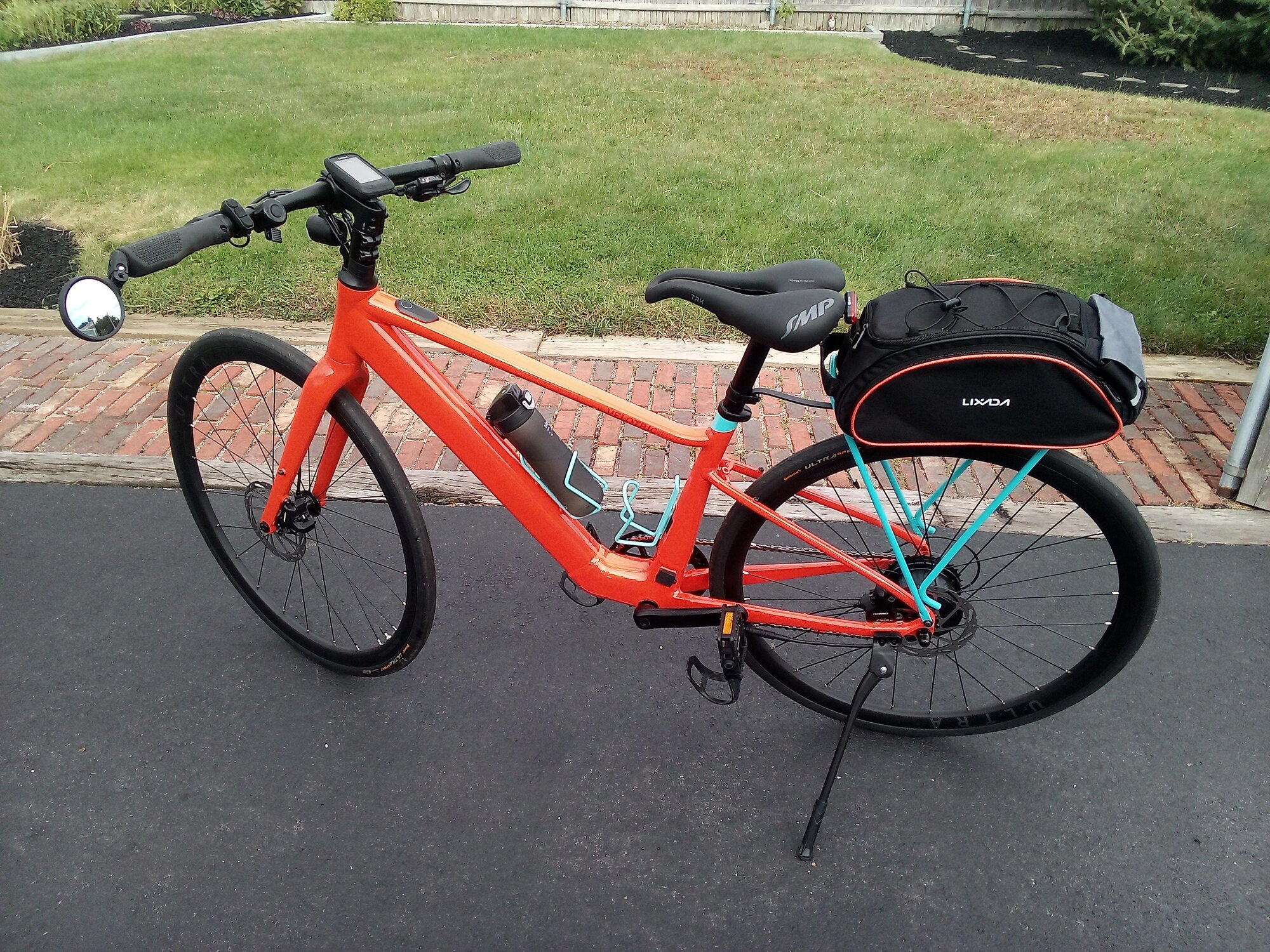

My wife and I have been bike enthusiasts for many years and in our retirement that enthusiasm has only increased. We both have traditional road bikes but this year my wife decided she'd like an e-bike to keep up with me. She bought a Velotric Thunder1 ST, and after we tricked it out, she is very happy with it.
In order to make it more comfortable we had to change out the seat, the tires, the handlebars and raise them about 2". The dealer who sold us the bike told us that raising the handlebars could not be done. He also advised against narrower tires because of stability. She is used to 23mm treads so 28mm is a piece of cake for her. I have to say that the 40mm tires that came on the bike are butt ugly.
Now she and I ride comfortably together at a fair pace. She seldom uses the motor except for some hills.
