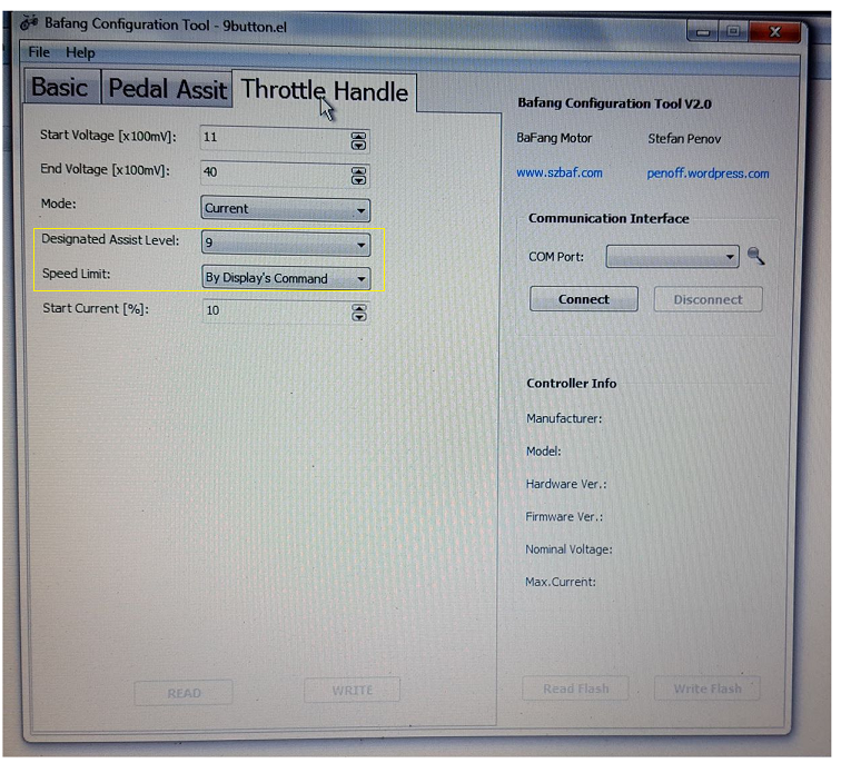

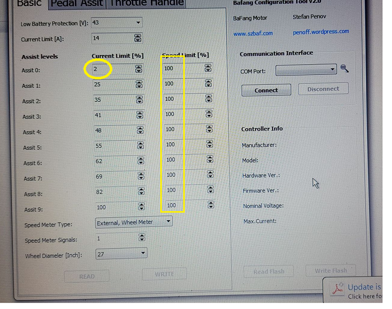

My throttle goes past 20 mph and it is also active at zero PAS.
To make the throttle go past 20 mph, go to the throttle page, set the speed limit by displays command and designated assist level to "9". The throttle can also deliver full power at all PAS levels.
To make the throttle active at PAS 0, go to the basic page and assign a "current limit" number to PAS 0 greater than "0". I put "2" current limit at PAS 0. It is also good to put 100% speed limit to all PAS levels including PAS 0 so your motor can continue to power at higher speed even if it is a "mild" support such as going downhill.

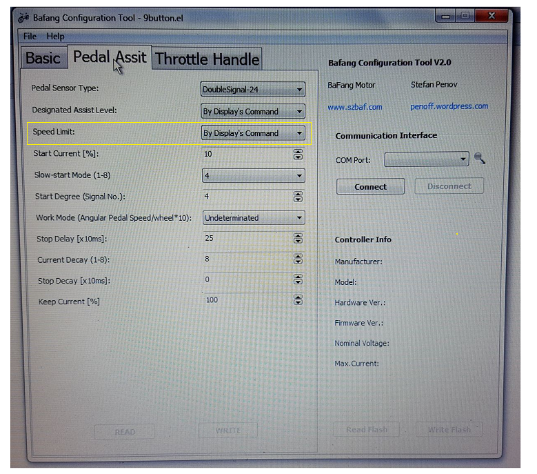

At the pedal assist page, set your speed limit to by display's command to allow higher speed limit assigned (100%) that was entered in the basic page.

That is exactly what I was looking for. Many thanks @Trail Cruiser.
