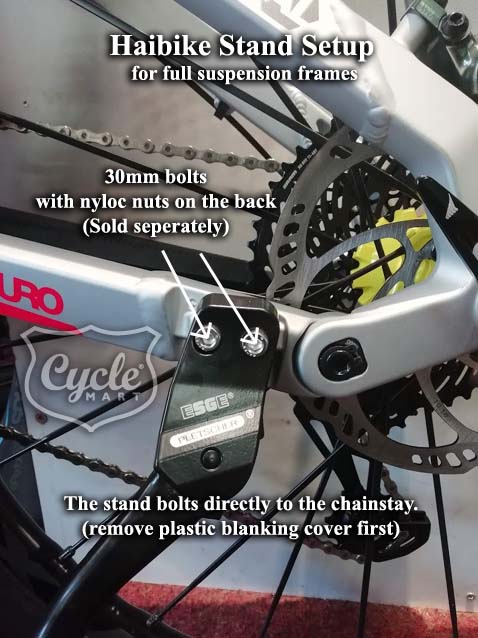

I am waiting on my new Haibike fullseven 1.0 to arrive..... found a suitable kickstand with 18 mm apart holes but it comes without screws and the guys I ordered from they don't stock it unfortunately.
Looking on ebay now for 30 mm screws with nuts, like following but they don't ship outside UK
There aren’t any local hardware stores? I found stainless steel bolts locally.
