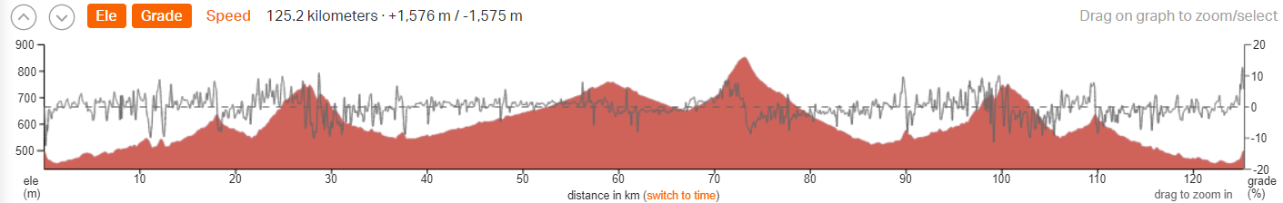

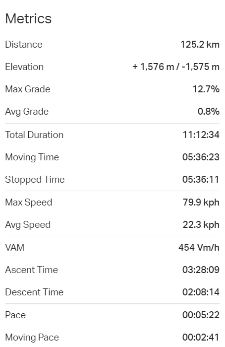

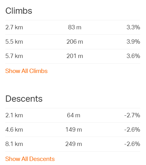

Stephan , what are you using to gather this info . Is there software that tells you what grade of hills you climbed as well ?
I connect my Specialized e-bikes to either Wahoo ELEMNT Roam or Bolt v2 (the former is more capable, and the latter is more modern). My Vado or Vado SL are seen by the bike GPS computer as a single sensor called E-Bike (each of the e-bikes is reported as a separate Sensor). Wahoo is fed with e-bike specific information as you ride. Post-ride, Wahoo allows you to concurrently upload all ride data to many sports trackers such as Strava or RideWithGPS. And yes, RideWithGPS gives you full information on the hills you have climbed.
RideWithGPS Elevation/Grade/Speed chart. Clicking anywhere in the zoomable chart will show the respective hill on the ride map.
RideWithGPS ride summary. Clicking at the max/min grade will show you the respective hill on the ride map.

RideWithGPS climbs and descents.
