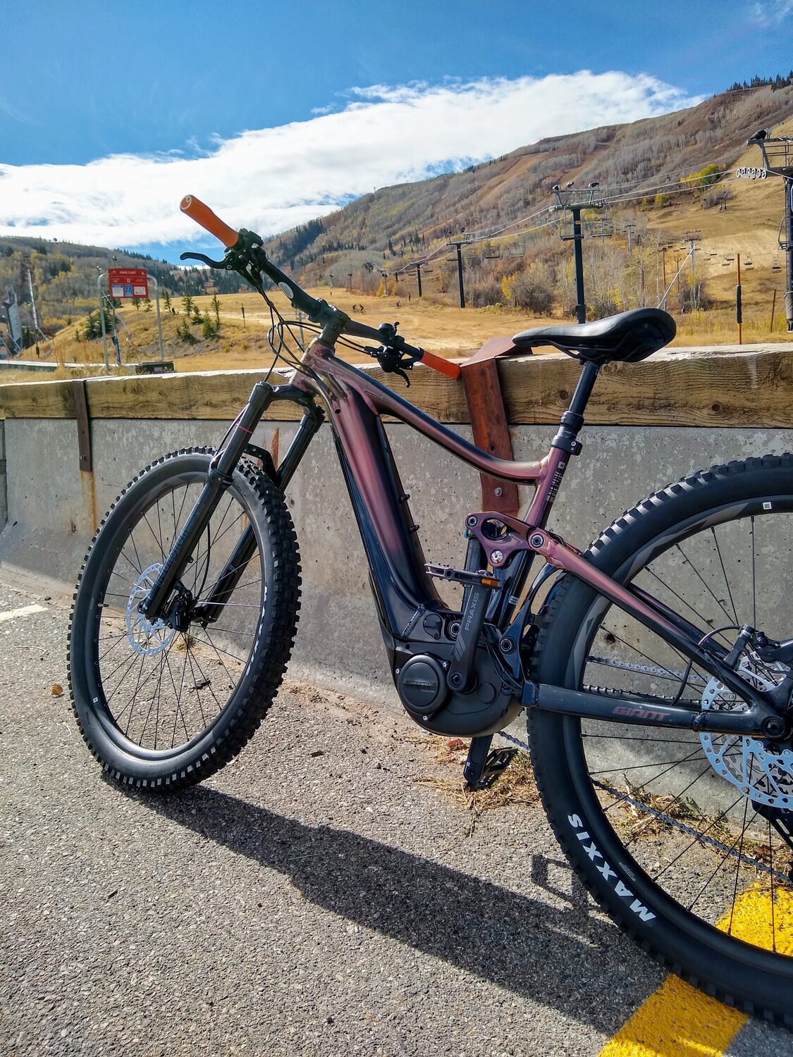

I have 980 trail miles on my 2021 Trance 2, 29er chameleon/mars/black. Came from an acoustic Trance X 2021 29er, the difference is shocking. Riding ski resorts in Utah, it's seriously UP, all the time. Incredible battery life, quiet, strong Yamaha motor is a major plus, excellent gearing. 52lbs, you get used to it. Riding up in 3 out of 5 modes is more than enough to keep a smart cadence, overtake other riders. I can do 4 miles up to 8,000', then cross country w/ more random ups, average 17 miles a day, the battery never under 50%. Downhill is crazy fun, just let it crush rocks, it's a straight-line train and I'm not a downhiller. Add in Diety flat pedals, Ergon grips and you never feel out of control. I feel strongly that Giant quietly put this model together knowing it would hit a homer, you can't find fault with its pricing, reliability and fun factor. I let riders try it, 30 yards in they are hooting like mad! The reviews are solid, the above Biker's Edge review is real, they are 'my go to Giant shop' and pull no punches. Rob Rides is top drawer, he rode in snow/water/mud, unlike me. 980 miles in added a new chain, new rear tire. The cons for Giant to improve are the app, it's nearly useless, buggy as hell. You will need a 1UP Super Duty rack, but this bike fits in my 2013 Forester. It's summer, I am aiming for 30+ mile days, which I thought were impossible, now it's 'how long have we been out here!

Cool paint job !
