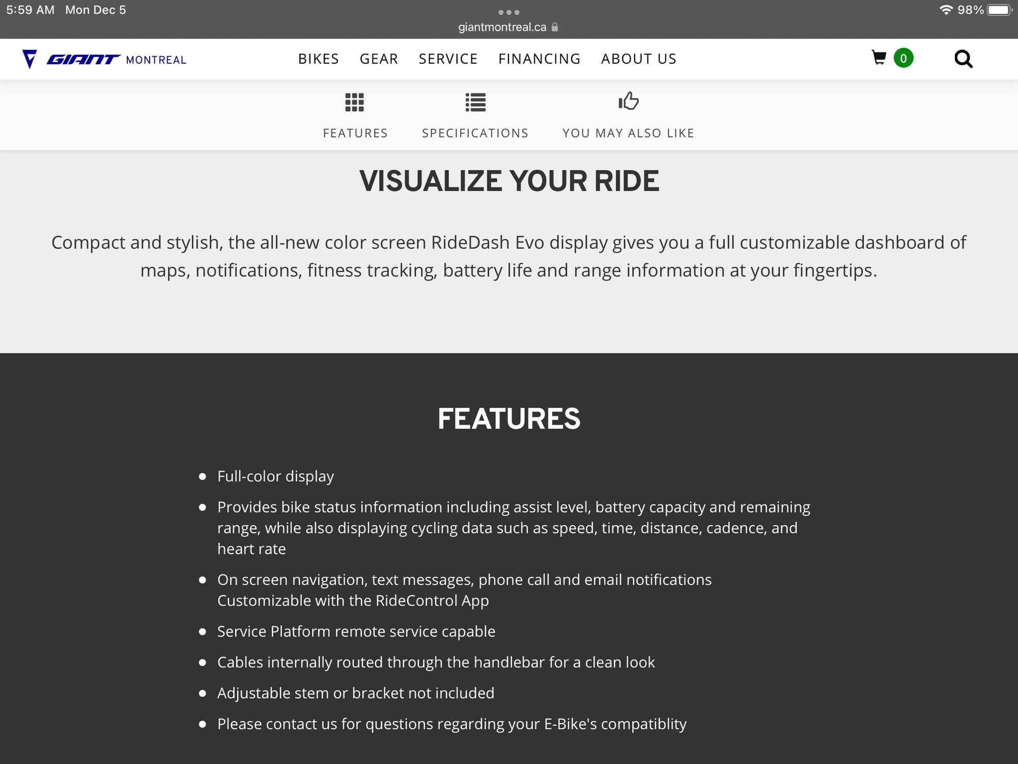

Ride Dash Evo display Can display heart rate. I replied to a comment about pairing to the app, not to the Ego controller. But thank you for trying.
