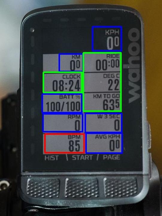

My only comment is: The electronics on the Bosch E-Bike vs. the electronics on a Specialized are like a night and day. Specialized philosophy can be described in one word: "Connectivity". You can connect a Vado to anything with the ANT+ protocol: that would be your 530 and Varia. While Bosch E-Bike idea is: "Let us put everything possible in the hardware".
For instance, Specialized system offers no GPS navigation but you pay no service fees and your Garmin Edge will seamlessly connect to the Vado. Same with a heart-rate monitor. Bosch Nyon (if you buy it as an extra) yes has GPS navigation but reportedly it does not work well in the United States.
A Specialized e-bike connected to a Wahoo ELEMNT Roam. Blue fields are e-bike data, the red field is the HR monitor, and the green fields are general or related to the route plan.
ah cool, thanks - I didn't consider the possibility of the 530 receiving data from the bike, that's interesting.

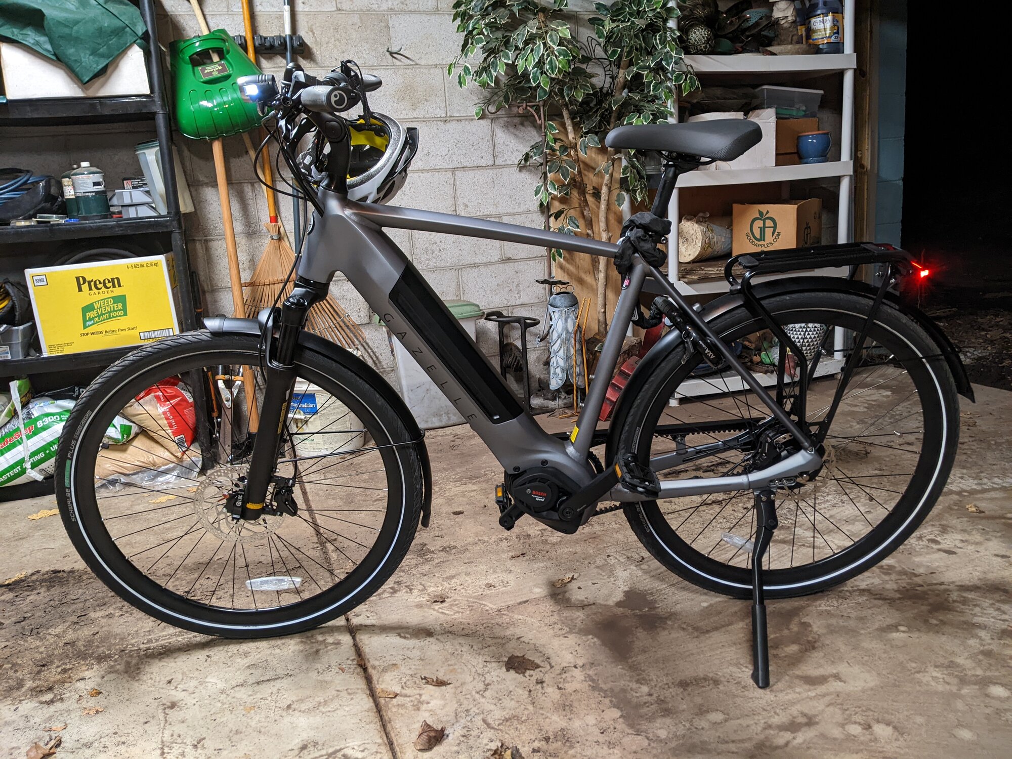

well, I went to the shop today, took the Gazelle out for a ride, wavered for a while, and ultimately decided to buy it. It's a super nice bike, and ultimately I decided that while the Specialized might be a little nicer, the bigger battery is really the main draw for me, I don't think it will make me regret my purchase (and if it does, well, I'll figure something out...).
The bike shop confirmed you can retrofit the Bosch displays and said they do it a lot (they sell a lot of cargo bikes) - it's about $300 for the Kiox and $400 for the Nyon, they both look pretty nice and could replace my Garmin.
Had a nice ride home; alas despite it being sunny and 15C today, tomorrow it's going to be -6C with a ton of snow.
