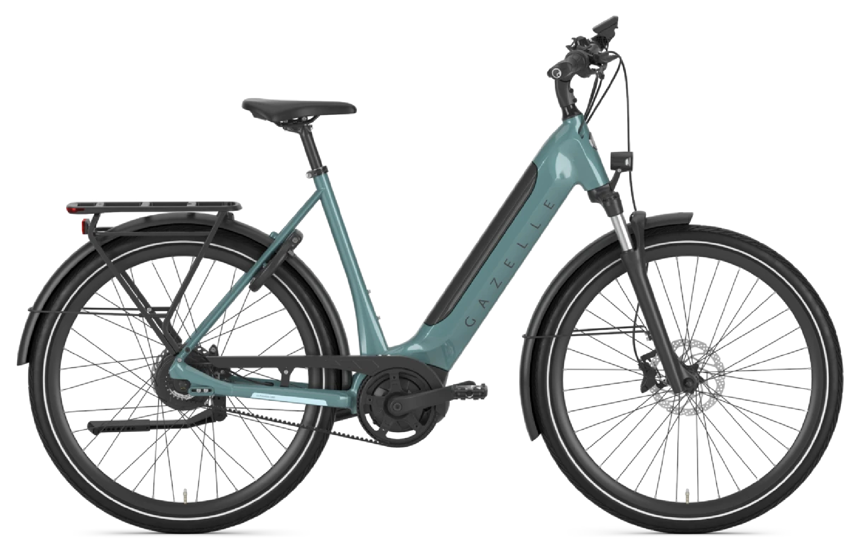

My 2018 RadCity Stepthru has over 5K miles and while it’s still working well, I’d like an upgrade and more enjoyable riding experience.
I have my sights set on a Gazelle Ultimate C380 HMB. Denim Blue. I’m located in the US. I have test driven several Gazelles. I also test drove an Aventon and did not find it much of an upgrade from my Rad.
My question is although I am 5’8” and Gazelle suggests the 53 cm frame, the smaller 46 cm frame feels so much more comfortable to me. But I was only able to test drive the C380 HMB in 53. The 46s I rode were C8 And T10.
I reviewed the geometry of both frames and their specs say these 2 sizes are exactly the same except the seat tube length.
Any thoughts on size or this model of bike? TIA.
Most important factor is the reach, so the distance between the saddle and the handlebar. So I wonder why the 46 felt better than the 53?
You could alter the position a bit by moving the saddle to the front and set the stem (part between fork and handlebar) a bit more upright so the handlebar comes closer to the saddle.
Or get the dealer to swap the stem for a diffent moddel so it would better fit you.

Thanks. I think their specs are off. Because on all 3 smaller bikes, the reach was better for me in that it was closer. I have long legs but short torso.

If the 46 fits better than get the smallar one. The "problem" with powertube frames is that the downtube has a minimal length. So for our brands I do now that the seattube angle and hight are the ones which are different for the smaller frame sizes and some other brands share 2 or 3 framesizes which only have a shorter seattube. Easier for producing the frames

A 46cm seems awfully small to me. A 53cm may be OK but I'd think a 50cm would be closest.
BTW, you don't adjust reach by moving the saddle fore and aft. That adjustment is for getting the correct hip angle for pedaling power. You adjust overall reach with stem length and steerer spacers, which also affect the reach. On a bike like this, you can also change the bars which will affect reach.

100% true, but in most cases when you are in between two frame sizes you can over come most with stem angle and saddle position.
And yes I personally have a very weird position on a bicycle... Both knees are worn out (since when is was 15) so I sit in a more tri-hip position and overstretch my knees a tiny bit, that helps in being able to cycle for days and days on. My bike-fit license expired so cannot use those measuring tools+sw any more.

Thanks. This bike (and most of Gazelle I believe) have adjustable angle handlebars. They don’t sell a 50. But I will test drive both the 46 and 53 before buying one. If I remember correctly when I was on the 53, the bars were in the most upright position and didn’t feel as comfortable as when I rode the 46.
