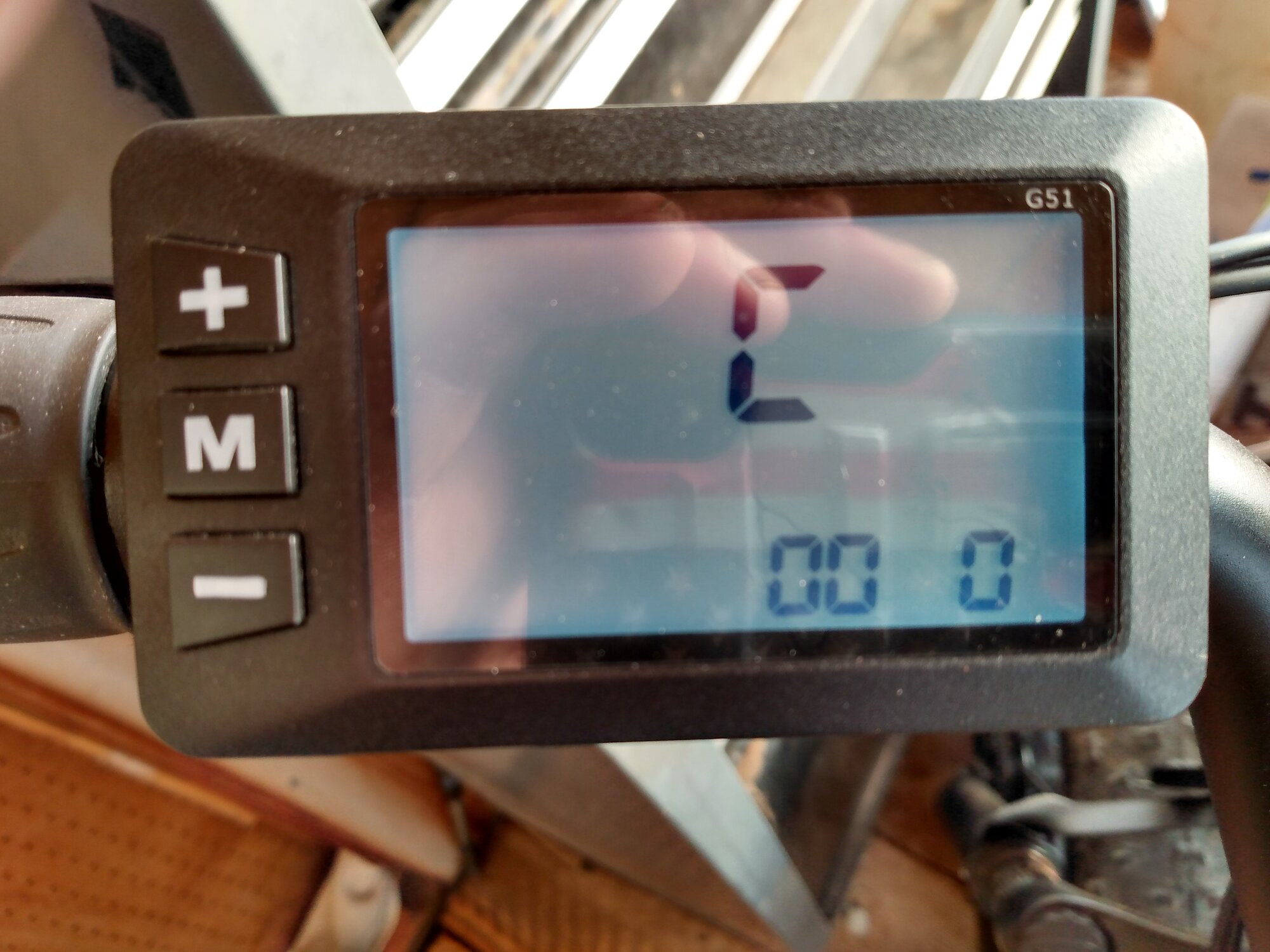

I just got this Freego DK200 and it has a G51 display. Ebike add says it will go 35 but I need to set the speed in the parameters. I have a copy of the manual and it says to hold + and - together to go to parameters but all I get is a C and 0000.
That appears to require some over ride code which I do not have. Any help appreciated.
I am waiting for response from company but thought you guys might be able to help faster.
Surely you got this taken care of by now, but I found this thread when I had the same issue. The code is 2020, however they do warn you that if you change the settings it will damage the controller. My goal was to change km to mph.
Thanks, yes I finally got the code and changed the settings.

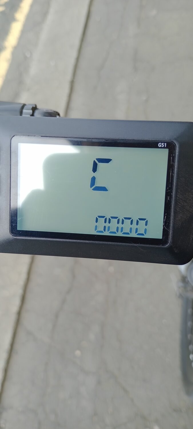

Hi I'm getting the same read out on my bike c 0000 I've tried to contact the customer but no response I thing its a overide code can any1 help with this please
I still can't get into the parameter still need some sort of 4 digit code hopefully someone cracks it
